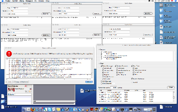

i cant get it to work. :/
(on the old claviaeditor everything works fine!)
i use macosx 10.4.11. (intel)
my midiinterface is recognised, but inside Nomad i cant get it to connect with my micro.
Everytime i push the "little yellow diamond" ("connect/disconnect"?)
i get this errorlog;
net.sf.nmedit.jsynth.SynthException: net.sf.nmedit.jnmprotocol2.MidiException: timeout: 10000ms (net.sf.nmedit.jnmprotocol2.SynthSettingsMessage) [error=-1001]

there's constantly coming sysex into the computer.
15:04:51.134 From Ta Horng MIDI I/O SysEx Clavia 16 bytes
so deselected that and selected to spy on output to destinations.
when i try to connect to the micro in nomad it says
*** ZERO *** To Ta Horng MIDI I/O SysEx Clavia 8 bytes
*** ZERO *** To Ta Horng MIDI I/O SysEx Clavia 11 bytes

tried it again with different patch, without any sysex sending out all the time.
then it says this when trying to connect;
15:24:28.264 From Ta Horng MIDI I/O SysEx Clavia 12 bytes
15:24:28.379 From Ta Horng MIDI I/O SysEx Clavia 42 bytes
15:24:28.498 From Ta Horng MIDI I/O SysEx Clavia 9 bytes

PostPosted: Tue Mar 11, 2008 7:56 am    Post subject: Reply with quote  Mark this post and the followings unread
i cant get the .mmon file posted on this forum.
so this is a .png of the 6 seperate messages that turn up when trying to connect to the micro in nomad. top left to right.
dont know if this is of any help but ok.
i am afraid i am just forgetting something really silly.

Everything looks perfect, it's not a problem on your part, but i guess something in nomad. I'll have a look and see if I can find it. I haven't spent much time with the MIDI side under MacOSX, as I was mostly working on the user interface.
nathan
Joined: Jan 07, 2008
Posts: 59
Location: amsterdam
PostPosted: Tue Mar 11, 2008 8:52 am    Post subject: Reply with quote  Mark this post and the followings unread
ok it's working! >>>put the clock on external instead of int. inside the synth.
only way i could do that was with the other editor. haha.
thanks a lot for your time Wesen!!
