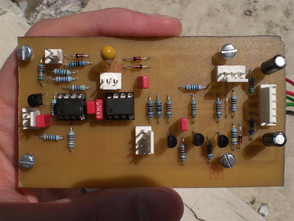

I've built two ADSRs and have mounted them behind a single panel making a dual ADSR module. They both share a power connector.
ADSR 1 seems to work fine - according to the LED on the front and my oscilloscope.
ADSR 2 however does not! If I have the Sustain pot set to anything greater than 9 o' clock, the output keeps on sustaining after the gate signal ends and only stops when I turn the Sustain pot back to 0.
I've checked all the resistor values and they are all correct - including the correct values so that two PCBs can be run in parallel. I'm stumped!
I am using a different brand of 7555 in ADSR 2 than I am in ADSR 1 - could that be it?

Now it's getting tricky, the fact that on pin 6 you have 5V at GATE OFF is definitly not normal and this voltage must come from somewhere. Because the diode are OK there is no explaination either than the 7555 but I suppose you already swapped them between the two ADSRs ?
Can you send me a good (detailed) photo of your PCB (component and track side) ?
Anyway try to replace C4 and see if there is any improvement...
Yves

LetterBeacon
Joined: Mar 18, 2008
Posts: 454
PostPosted: Mon Jun 22, 2009 11:34 am    Post subject: Reply with quote  Mark this post and the followings unread
yusynth wrote:
By the way did you check the polarity of C4 ?
Shocked Oh my God... I just can't... I mean I was SO sure I had checked it. It turns out that C4 was orientated the wrong way! I can't believe it! I'm so sorry, I'm sure I double checked everything - I wouldn't even be asking for help on here before checking everything was round the right way. So sorry to waste your time.
I've orientated it the correct way now, but now when I trigger the gate, the LED lights up and the fades very quickly. Do you think this is because C4 is now dead from being the wrong way round all this time?
I'll go to Maplin tomorrow and get another cap.
This is classical because when we check something we built ourselves we are blind to our own mistakes : our brains tell us that it is not possible that we could do such stupid thing and therefore we don't see it even though it's there in front of our very eyes... And we need someone else to tell us that the King walks naked Wink
Eventually I thought of this polarization inversion because that was the only possible explaination left to me Wink
Yes the cap is dead. Tantalum cap do not tolerate inversion of polarization.

PostPosted: Tue Jun 23, 2009 4:01 am    Post subject: Reply with quote  Mark this post and the followings unread
I swapped out the dead cap with a freshly bought one from Maplin, but unfortunately I still have the same problem Rolling Eyes
I've attached pictures of both sides of the PCB of ADSR 2 - hope they're good enough as my camera isn't particularly great.

Probably some other component have suffered.
When you say it is still the same do you mean that the voltage measurements at pin 6 are still the same 5V gate off/ gate on 6V ?
I'll check the photos of the PCB too.

PostPosted: Thu Jun 25, 2009 9:20 am    Post subject: Reply with quote  Mark this post and the followings unread
I check your photos and all seem OK. Therefore I don't know what's wrong, tomorrow I will do some measurement on one of my ADSR and compare them with your measurements. May be it'll show some anomalies...

yusynth wrote:
Can you repeat the measurement at pin6 with the SUSTAIN at maximum (CW) ? you should get something like 10V and falling.
ADSR 1
Before gate is triggered = 10.38V
During Gate On = 10.36V
ADSR 2
Before gate is triggered = 10.35V
During gate on = 10.35V
The gate on voltage started falling very slowly on both circuit boards.
yusynth
Joined: Nov 24, 2005
Posts: 1314
PostPosted: Fri Jun 26, 2009 3:50 am    Post subject: Reply with quote  Mark this post and the followings unread
LetterBeacon wrote:
ADSR 1
ADSR 2
Are you measuring at pin 6 ????? it must 0V to 0.1V at GATE OFF and 10V to 10.4V at GATE ON
