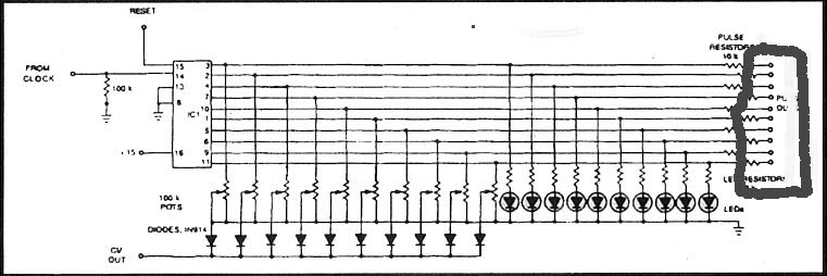

Please forgive my ignorance but after taking a second look at the baby 10 schematic,
I noticed something i don't understand.
What are those things i have circled ?
Loooks like they're marked 1- 12 pos ?
Also i suspect the 'from clock' is coming from the pwer supply(+15).
That's the pulse out - like a gate. It's high when that particular step is high. You could use it to cycle an Envelope Generator or trigger an event when that step is active.
"From Clock" is just that - you need to step this sequencer from a clock source. You could use an LFO, or a simple CMOS or 555 clock. - even just a momentary contact switch if you wanted to step the sequencer manually.

Ok let me get this right.
The 'pulse outs' are out putting to another device?
I thought thats what the CV out was for ?
The 'From Clock I think I understand, i could wire a jack so i could
plug in an LFO or just wire in a 555 chip, or an LFO for that matter
The pulse outs are the ones that got me the most confused.
are they really necessary?

Yea - you're getting it.
You could put a jack on the clock in and use an external clock, build a small clock 'on-board', or just use a momentary switch to your positive voltage to step it manually.
No - the pulse outs are not necessary. They will be handy if you are going to use a voltage controlled filter or VCA, but you don't need that. The CV is a voltage that varies depending on the pots. The pulse out is a stable voltage that turns on and off as the sequencer steps.

AH HA ! I think I see.
The CV out would plug into mmm say an analog synth.
The pulse outs would go into some kind of filter,(like you said).
But i don't need to wire in 10 jacks for the pulse outs, would I?
I could just put them all on one jack?
There's the rub.
If you wire all those pulse outputs to one jack, you end up with one long continuous pulse - not very useful.
Many circuits of the Baby10 use logic on the Pulse outs and the clock in to shorten each pulse, so you get a train of pulses instead of one long endless pulse. I linked to a circuit by Matthias H on page one of this thread that has that feature (and also a clock circuit you might be interested in)
