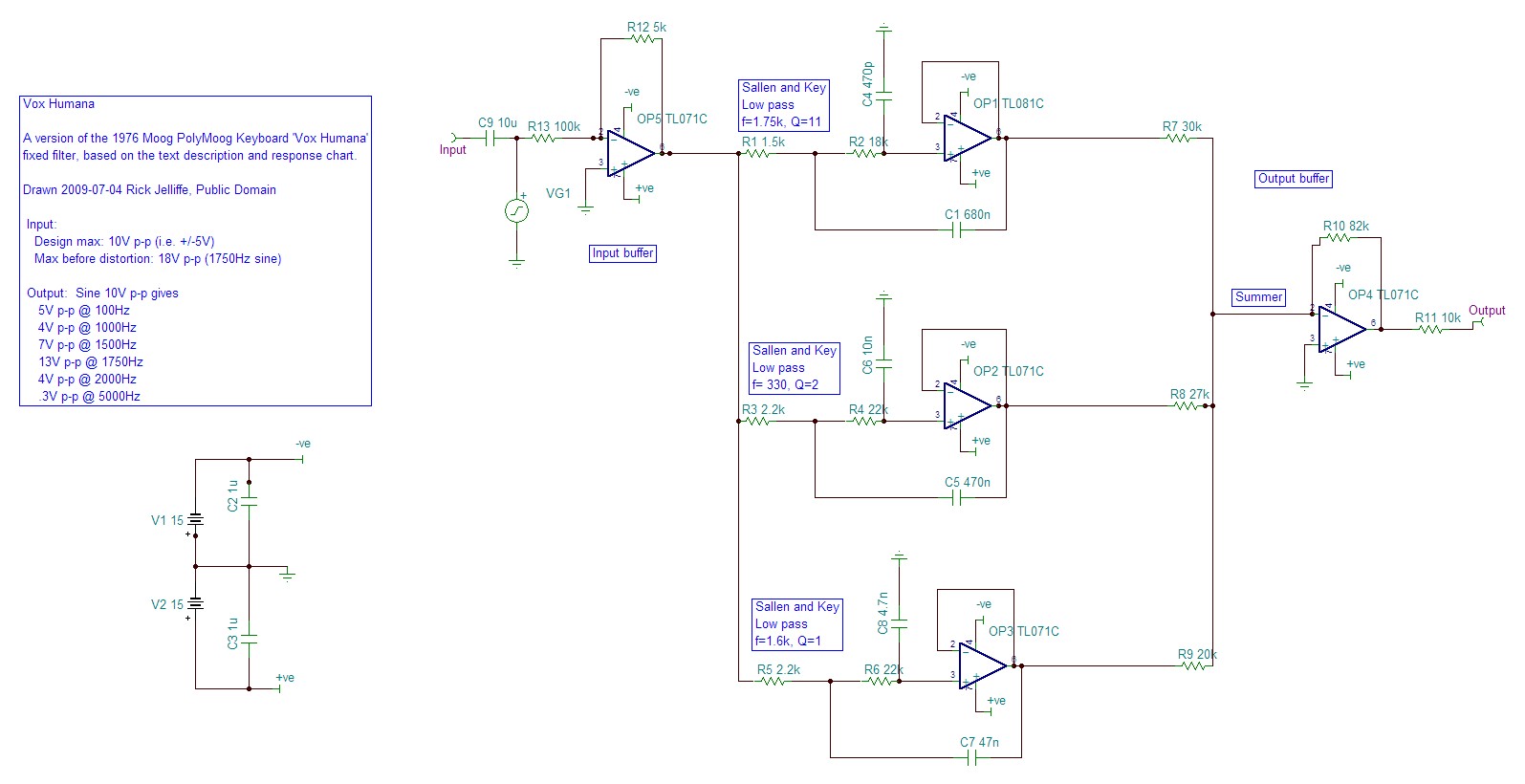

One of the most popular sounds on the Moog Polymoog Keyboard is the elusive Vox Humana. Think Gary Newman, etc.
There is a wonderful scan of the service manual for the various Polymoogs floating about, as one big fat PDF. However, it does not actually have a schematic for the Vox Humana filter (it has all the rest though.)
What it does have is a frequency response diagram (I think hand drawn or simulated), a fuzzy photo of a populated board, aparts list and two paragraphs describing of the circuit.
This filter is comprised of three low-pass filter sections associated with amplifiers A1A, A2A, A2B, respectively. The outputs from these three filter sections are summed via R5, R12, and R17 in the output amplifier A1B whose feedback resistor R6 determines the overall filter gain.
The first filter associated with A1A has a cutoff frequency of 1750Hz and a ! of 11. The second filter associated with A2A has a cutoff frequency of 330Hz and a Q of 2. The third filter associated with A2B has a cutoff frequency of 1600Hz and a Q of 1.
Looking at the photo, there are two op-amps (duals) and three capacitors. So the filters are second order.
Using this information, I have drawn up a circuit that seems to follow it pretty well, though it may well be that the balance between the sections isn't the same. UPDATE: I have changed the balance using the values of the resistors in the manual, which tames the first section.
So without vouching it is identical, here it is....
Recreation of Polymoog Vox Humana filter (updated)

My pleasure. You might put a 50k pot after the top section so you can adjust it to taste. If you want to try different frequencies, TI's free FilterPro program is what I used to calculate the component values here.
I have been going through all the Moog fixed filters (polymoog, poly kbd, minit moog, satelite) and the Arp por-solist ones, with a mind to making more generic versions. For example, the polymoog keyboard uses shelving filters quite often, but I am not aware of *any* synth modules that include shelving filters (let alone make them VC.)

I made a PCB of the circuit above last week and built it. I didn't like it. It did its thing, but not the thing I wanted, if you know what I mean.
So I have prototyped another circuit, more closely based on Polymoog's 12db filters, and sorted out some funnies with the dis/mis-information in the service manual, and I am happy with this one.

No, the circuit above is not the one of the board, except in outline. The fricko Vox H board follows the circuit of the Polymoog exactly, with extra buffering for the dry mix. You can see the core circuit here: https://www.gearslutz.com/board/electronic-music-instruments-and-electronic-music-production/1252539-polymoog-280a-keyboard-schematics.html
Vox H uses the same values, mostly: no strange capacitor values. 1x quad op-amp and one dual. No power voltage dependencies. No calibeation.
