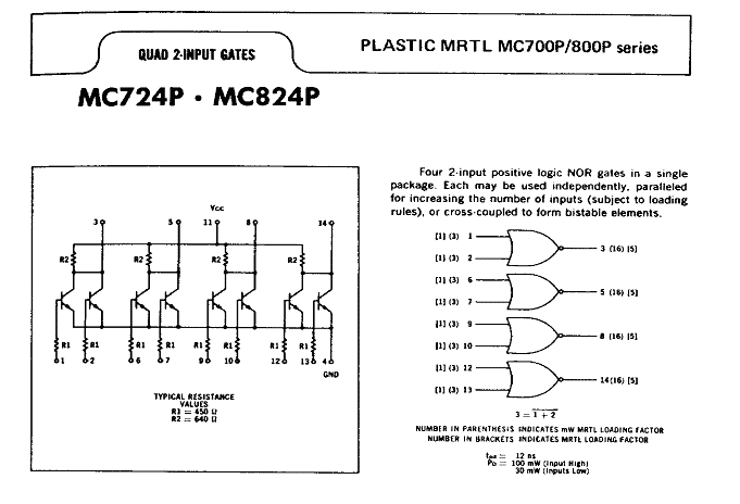

does anyone know where to get info on RTL in order to swap them out for CMOS?
All the logic is pretty easy, but some of the ICs seem to be represented by blocks, googles not been much help so far, but woah! these RTL chips go for some serious scratch these days!

richard64 posted some vital info here that seems to have dissappeared in the wake of the spam attack.
*I think* it was something along the lines of RTL using 'negative logic' whereas CMOS uses 'positive logic'
So, in RTL High = 0 & Low = 1 so the NAND gates in these ccts are actually NOR gates in CMOS.

I built this!
Well, part of it. OK, I only used the VCA/VCF and the Envelope Generators.
http://www.sdiy.org/richardc64/rtlsynth/rtlsynth.html
The rest of the circuitry seemed to me to be too complex for a mono instrument. Using a shift register to create different tonal qualities was intriguing, but the skimpiness of information about that part of the DigiVox put me off, so I used simpler methods.
(My post about negative logic wasn't a casuality of the spam clean up: It was deleted by ME. Although I am certain that the MC724 is a NOR in the more usual positve logic, I can't be certain about the other gates in the design.)

OMG! I can't believe I found it!
I don't know why Burhans drew it as NAND. Full data sheet is the last one listed here:
http://www.datasheetarchive.com/search.php?q=mc724
