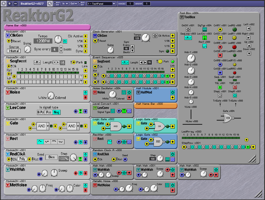

Current status v27
-Studying different layouts.
-Cloning a few more modules.
-Increasing functionality in existing modules.

This looks really neat. I've always loved the G2 interface, and the idea of a soft G2 is very appealing to me.
Have you considered the scaling of the signals between the modules? If not, I suggest using the Clavia scaling system, where oscillators put out +/- 64 units, and a VCA operates at unity gain when it's control input is 64.
I once mimicked an Arrick modular in Reaktor, and using the same "voltages" the original used helped everything fit together easier.

Nice to see you here Chet... Smile
Me too.
Oh Yesss... Twisted Evil
I already did a *very* rigorous binary arithmetic standardization in all controls *exactly* like G2 ranges.
(I am using the ADConv AND the SeqCtr to dissect *every* integer range correctly...)
(I have lots of second intentions in doing this, one of them is using *integer* core macros to speed up calculations, and truly emulate the 24 bit DSP operations, instead of using floating point.)
(I was sick to the point of rendering knobs with exactly 128 integer images and steps on this... [Looking it "under my angstromscope", i noticed that Clavia renders only 64 frames and jumps the images every 2 steps])
Precisely. The ranges must be identical at the beginning of the process, otherwise, complications raise exponentially, during the development.
I assure you, that *every* macro range is being built *bit-by-bit* identical to G2 originals.
(Nice point though... only an experienced reaktorist could consider this aspect.)

Chet wrote:
I suppose there are a couple of times where you’ll have to choose between faithfulness and audio quality.
I am not focusing on 24 because of faithfullness or quality.
I am focusing on 24, because the translation from Motorola 56xxx DSP code to Intel code it´s is easier.
(but faithfullness is a consequence of that)
(and that´s the worst part, it should be as easy as possible)
Chet wrote:
Quantizing to 24-bit values is one.
Nope.
(You´re not considering that Intel does 32 bits, so it´s only a matter of shifting everything 8 bits left in late development, to gain 256 extra resolution levels and eliminating quantization problems.)
Chet wrote:
Another is whether you’ll clip signals at +/- 256 Clavia units.
Actually i am having to hold the Reaktor beast in a leach, to make it clip exactly at the same level that G2 starts to clip.
(but... consider that I´m monitoring those clipping levels very closely...)

I'm not a Reactor user, but the picture is puzzling me...
Are you using the G2 Demo as a VST in Reactor, or, are there just some windows layered, or, is it one HOAX using PhotoShop, or am I just a nitwit?
Where are the module folders? How about those cables between the G2 mixers and the scope???
Sigh...
And those G2 expansion boards...
Time to go on a holiday trip, I think... Very Happy
