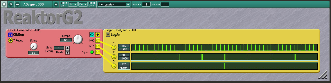

PostPosted: Fri Jul 24, 2009 4:45 am    Post subject: Reply with quote  Mark this post and the followings unread
In the mean time, doing a few measurements here:
ClkGen
60BPM (48 smp/s)
1/96: 150/2002 smp
1/16: 600/12002 smp
Sync 1: 120/48004 smp
Sync 2: 241/96144 smp
Sync 4: 483/192842 smp
Sync 8: 965/385684 smp
Sync 16: 1951/780336 smp
Sync 32: 3995/1597830 smp
(hmmm... i wonder if the hardware has these fluctuations also...)

PostPosted: Fri Jul 24, 2009 7:00 pm    Post subject: Reply with quote  Mark this post and the followings unread
It´s Alive! Alive!!!
http://www.youtube.com/watch?v=9_tVZFZ5PR4
(Only 165 remaining...Smile)
(now i understand the reason for those fluctuations...)

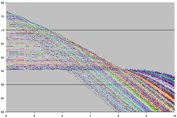

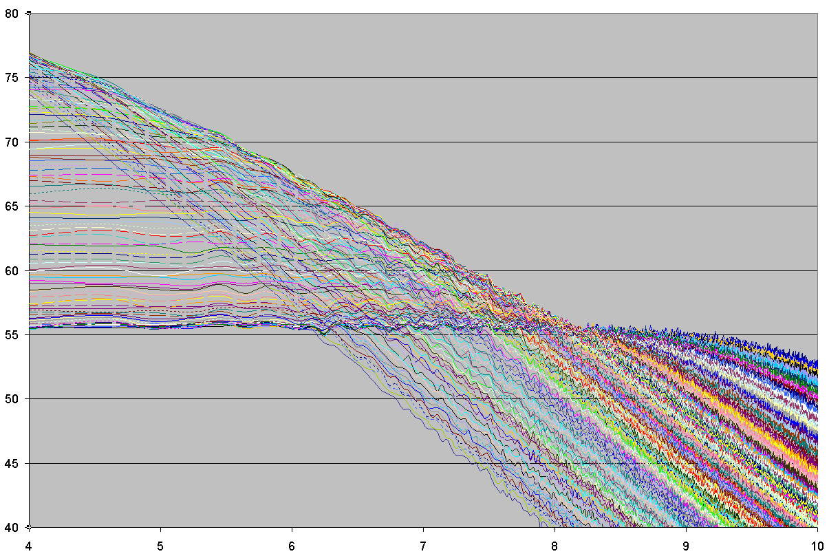

PostPosted: Mon Jul 27, 2009 6:47 pm    Post subject: Reply with quote  Mark this post and the followings unread
-Doing some studies in the white noise module...
(interesting...it is not a flat line at whitest position...)
(it seems that in the colorest position it turns to pink noise...)
some more analyisis to be done...
 Filesize:  567.53 KB
 Viewed:  276 Time(s)

PostPosted: Fri Jul 31, 2009 7:22 pm    Post subject: Reply with quote  Mark this post and the followings unread
