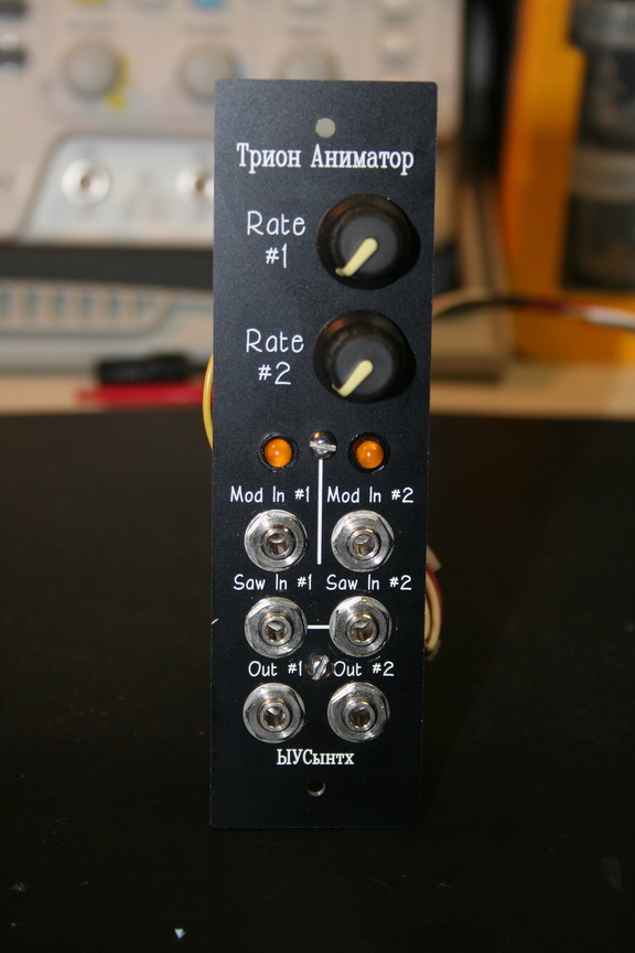

I've finished two of several YuSynth modules. Here are some photos. I built 2 Saw Animators in FracRack format, and 2 Fixed Filter Bank in EuroRack Format. I'm also including the .fpd files for the panels (I have some FracRack format for the FFB, too).
Next up, MiniMoog and ARP filters, and the CV Standards. Thanks Yves (and Scott at the Bridechamber for the parts)!
(removed/resized some photos to reclaim some space, see my site for photos: www.xmission.com/~dingebre )
************* Please Note****************
I ran my knobs left to right ascending, not top to bottom like Yves did. It just made a bit more sense to me. So be aware if you use my panel that you will have to be careful when wiring the pots.
David

Yu Fixed Filter.fpd
FracRack fixed Filter Bank. Unbuilt but uses spacing that have worked in a Blacet Rack. the pot spacing is the same as in the EuroRack version.
see note above about pots

PostPosted: Tue Aug 04, 2009 12:05 am    Post subject: Reply with quote  Mark this post and the followings unread
Hi David
Congratulation you managed to fit the huge PCB of the FFB behind a Eurorack panel. That's a preformance ! Reminds me of how the spring reverb unit (slightly bigger than the 5U format) was attached in the Moog 905 reverb module !
Yves
