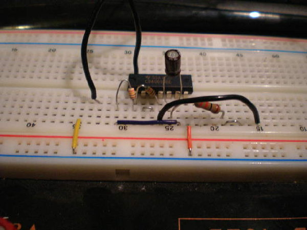

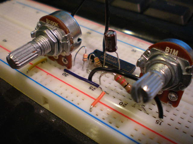

Joined: Jun 26, 2009
Posts: 226
Location: The Darkside
PostPosted: Fri Sep 11, 2009 11:08 pm    Post subject: Reply with quote  Mark this post and the followings unread
Ok I abandoned the 741 LFO and decided to try 4069 one since it seems easier.
How ever I don't have a 1.33uF cap but i do have a 1uF one.
BTW in the schematic it looks like a polarized cap, is this right?
Any Way I tried breadboarding it with the 1uf cap, i tried both polar and non-polar
but I can't seem to get it to work .
I'm using a single 9v battery, I got pin 7 to GRND and pin 14 to +.
I'm pretty sure I got something wired wrong.

JovianPyx
Joined: Nov 20, 2007
Posts: 1988
Audio files: 224
PostPosted: Sat Sep 12, 2009 8:39 am    Post subject: Reply with quote  Mark this post and the followings unread
The cap can be polar or nonpolar. 1.33 uF would give a lower frequency range. It should still work with the 1uF cap.
A 9volt battery should work.
All I can say is to really go over the wiring well, it's a simple circuit, nothing tricky at all.
Your output should come from the wiper of the rightmost pot and ground (or the negative side of the 9v battery).
What are you using to test it - to determine if it's working? If the frequency pot is set to high resistance, the output will change slowly, so you may want to turn it to a lower resistance.

PostPosted: Sat Sep 12, 2009 6:37 pm    Post subject: Reply with quote  Mark this post and the followings unread
Thanks scottG.
It ended up being my amp, one cap was loose on the breadboard.

I read there were some troubles with the circuit above, which makes sense- there always is, but this chap seemed to get it to work fine.
His email:
Hello,
I just found your post to the electro-music forum about a 5V 741 lfo (http://electro-music.com/forum/viewtopic.php?highlight=battery&t=31166). I built it in a simulator and it works beautifully! I put the simulation online at ollieglass.com/circuits if you'd like to see it. Hope you're okay with me posting it on my site.
Best wishes,
Ollie
Nice Site Too!
