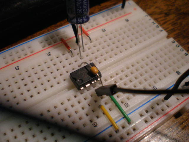

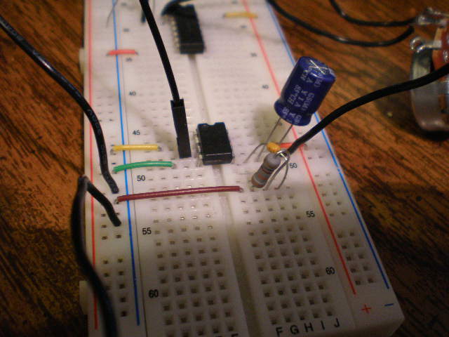

Ok I'm still getting a hot LM386 chip.
I've included pics of my breadboard circuit.
I didn't have a 10 ohm R nor a 0.05uF cap, so I used 330 R and a 0.1uF cap.
I don't think that will make too much a difference.
The larger chip is the 4093.

I might be wrong.. but to me it looks as tho the resistor on the right with the little cap won't actually be doing anything will it?

PostPosted: Sun Sep 06, 2009 10:32 pm    Post subject: Reply with quote  Mark this post and the followings unread
As DGTom stated (and looking at the large Cap as well), these components are actually being shorted out by the connections on the breadboard (the 5 connections in a row are shorted together - that's how these breadboards work).
You will need to make these connections in adjacent rows to give them separate connections.
For example, move the negative (short) leg of the electrolytic cap from from I49, to I50, also move the output connection from J49 to J50. Then move the long leg of the resistor from H52 to H51 and the capacitor from I52 to I51.
Try this first then lets see how the circuit behaves, but the decoupling cap already mentioned would then be a good addition.
I suspect the reason the chip is getting hot is that you have effectively put a low resistance to ground on the output (the speaker), because the output capacitor is being shorted. Here's hoping this hasn't cooked the chip.

I think magman and DGtom are right ... the negative pin of the 220uf electrolytic cap should be connected as advised here

Great eyes there man !! Just to explain a bit further, even with no signal input, this amplifier centers it's output at 1/2 of Vcc. This means that if you have a 9V supply, the output will be sitting at 4.5V. The decoupling capacitor that is now shorted allows this to be applied to 8 ohms to ground. The amp is trying to deliver 2.5W to the speaker .. ouch . but it can't and thus gets HOT Rolling Eyes
It's a good chance that the LM386 is destroyed so if you rearrange things and it still does not work, it's may just be a bad amplifier chip.

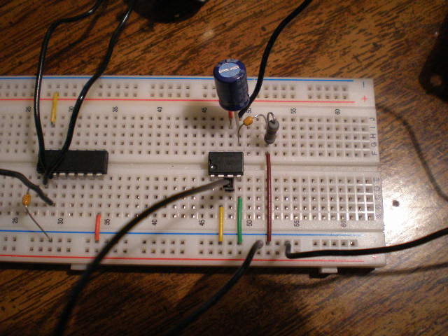

PostPosted: Mon Sep 07, 2009 1:12 pm    Post subject: Reply with quote  Mark this post and the followings unread
Success!
No more hot chip
Alas, I had to replace the LM386 with a new one, since the old one
was burnt out.
I did what was suggested and moved the large cap and output down a peg.
I also "hanged" a cap between pins 4 and 6. Don't know if I hanged it right
but it seems to be ok
Thanks for all your help guys, I'll have to give that 'Little Gem' circuit
bbob mentioned a try.
I figured taking a pic of a circuit that doesn't work would be better than trying to explain
everything.
Every one should do this, it's much easier to troubleshoot.
Perhaps taking a pic could be mentioned in the FAQ, we have a FAQ right?
Or maybe a mod could make a sticky post or something.
