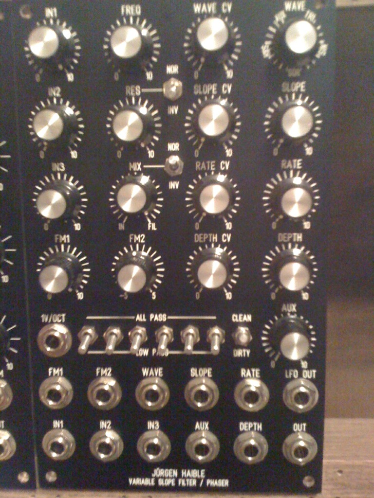

PostPosted: Thu Sep 17, 2009 2:20 pm    Post subject: Reply with quote  Mark this post and the followings unread
Camera's still busted, so another blurry phone shot, but my finished module. Thanks again for another great project and thanks to Dave Brown for the panel!
 Filesize:  223.44 KB
 Viewed:  376 Time(s)

nice,are these NKK toggles?,i plan to order those NKK's with leds into it for this project.

PostPosted: Fri Sep 18, 2009 5:25 am    Post subject: Reply with quote  Mark this post and the followings unread
thanks. they're mountain switch actually - mouser carries them, haven't been able to find them anyway else. pricy but nice and solid, like the NKKs.

PostPosted: Fri Sep 18, 2009 5:36 am    Post subject: Reply with quote  Mark this post and the followings unread
yes they looks hardcorerocking resistant
