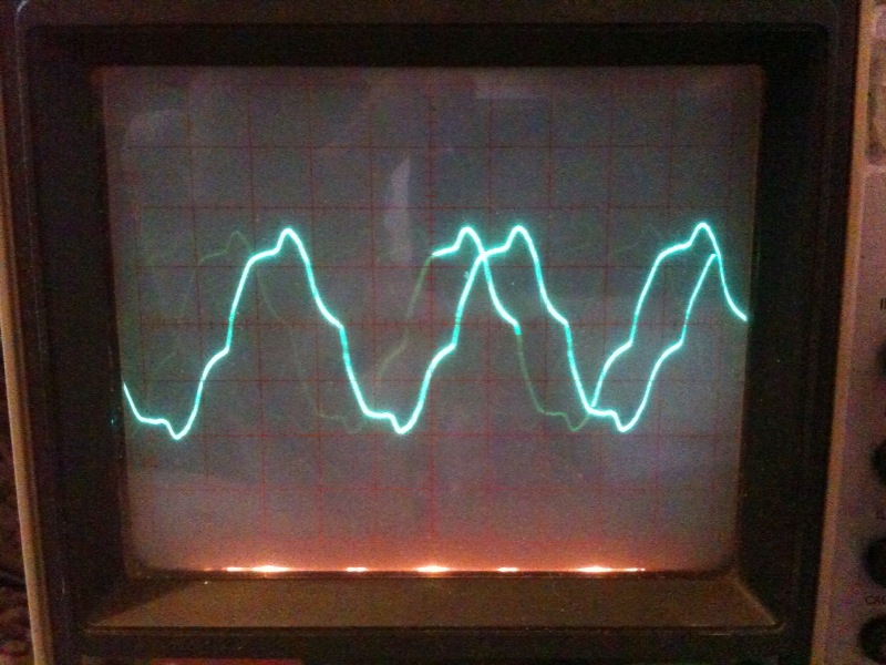

I've finally managed to hook everything up on my Utility LFO, but unfortunately I have a few problems. Both LFO output the same waveform out of all the outputs. I have attached a picture of my oscilloscope.
The speed pot appears to work as the LEDs and the wave on the oscilloscope go faster, but nothing else does. The range mod doesn't seem to have any effect.
The wiring seems to be ok, and the ICs are all orientated the correct way. I've run out of ideas so if anyone can help that would be greatly appreciated!

I'm an idiot. I forgot to connect anything to the GND pads on the PCB. Whoops! It all works now apart from the Range mod but I'm sure that's just a wiring problem.

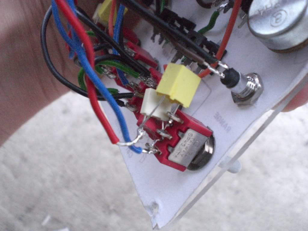

I'm still having problems with the range switch. Here's a slightly grainy photo of the way I've got the capacitors hooked up to the on-off-on range switch. Can someone verify that what I've done here is the same as what's in the diagram?
The top cap is 470n, the middle one is 4.7n and the bottom one is 47n.

Looks like blue wire should go to middle contact on switch?

PostPosted: Mon Oct 05, 2009 12:54 pm    Post subject: Reply with quote  Mark this post and the followings unread
Ha! That was it - thank you very much!
