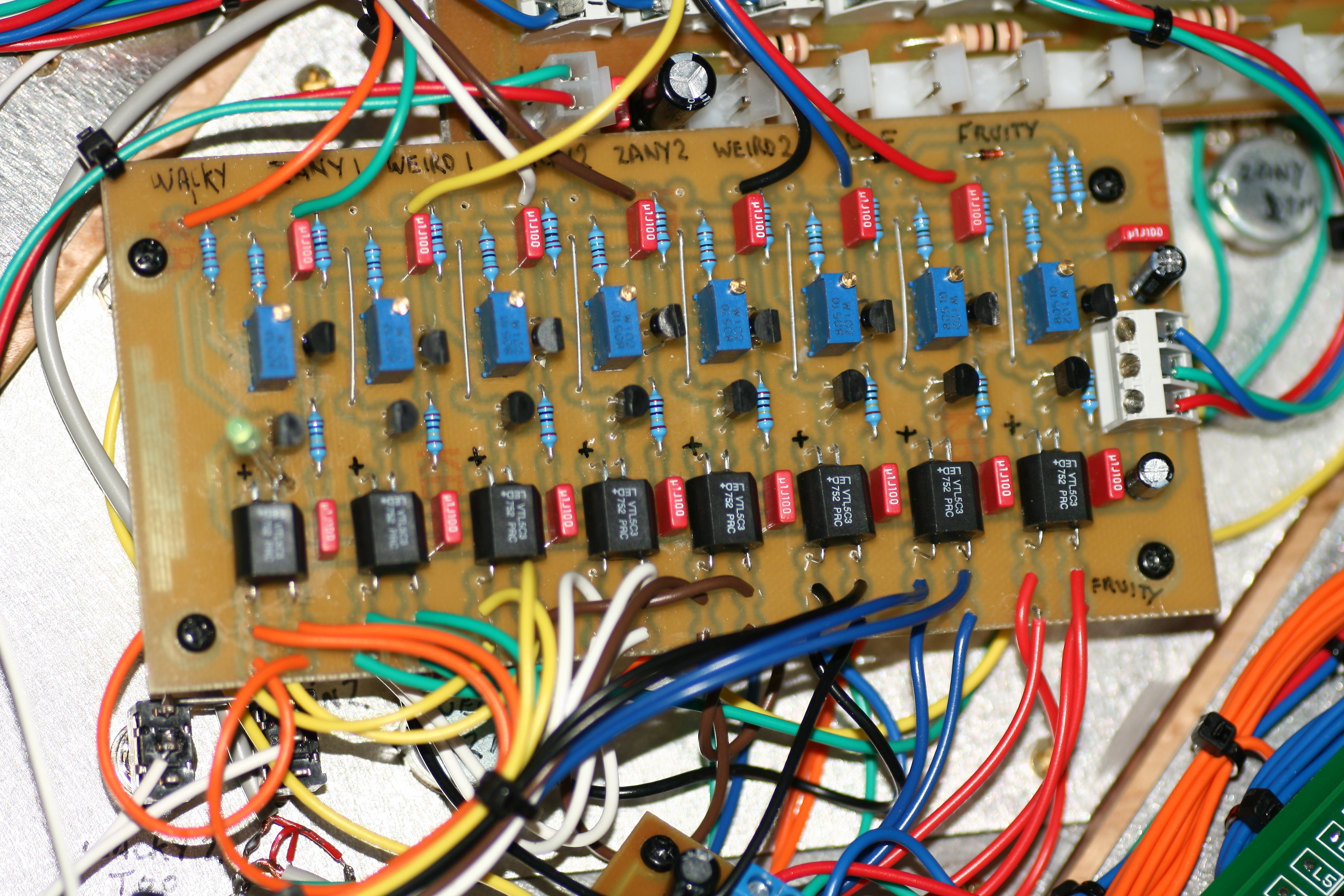

 Filesize:  388.75 KB
 Viewed:  20635 Time(s)

DGTom
Joined: Dec 08, 2008
Posts: 211
Location: Adelaide
PostPosted: Tue Oct 27, 2009 3:45 pm    Post subject: Reply with quote  Mark this post and the followings unread
Cool Would love to hear it in action once its up & running, VC Grinder is gonna be gnarly!!

nice board luka
a sample would be good to hear
haven't heard a grinder yet

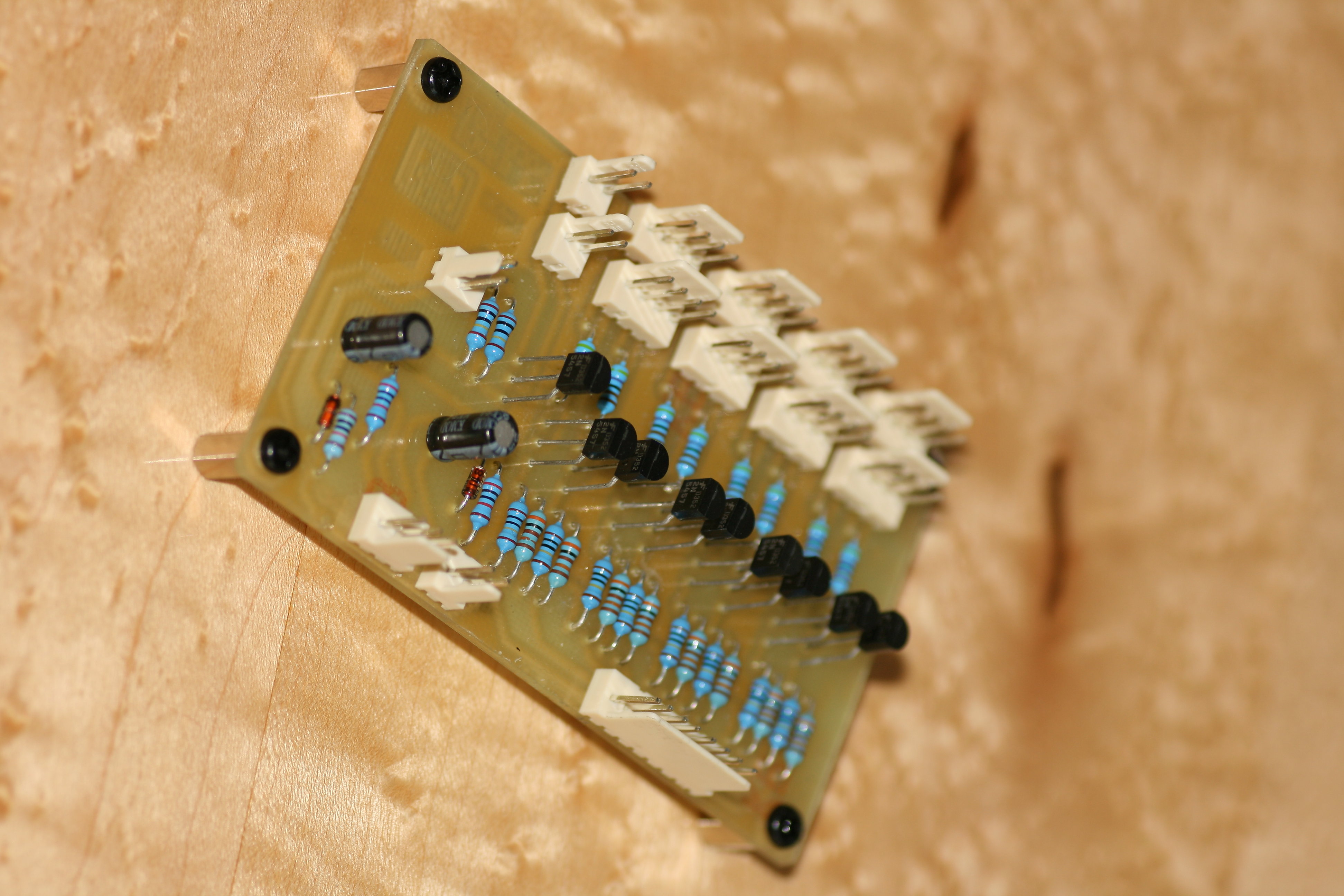

here's a snap for you
WSG VC using vactrols
 Filesize:  1.61 MB
 Viewed:  437 Time(s)
diablojoy
Posts: 809
Location: melbourne australia
PostPosted: Wed Oct 28, 2009 1:16 am    Post subject: Reply with quote  Mark this post and the followings unread
and to carry on as i've finished with that experiment
rays new cct using 2n5457's
this is the new board to replace that one so I can get those vactrols back
for another use Smile
Denis.
 Filesize:  941.59 KB
 Viewed:  371 Time(s)

PostPosted: Wed Oct 28, 2009 2:22 am    Post subject: Reply with quote  Mark this post and the followings unread
not off hand but its just on the MFOS site under WSG mods
easy to find. by the way still haven't got to test that board yet,
been too busy, hopefully will get to it this weekend Smile

PostPosted: Wed Oct 28, 2009 4:18 am    Post subject: Reply with quote  Mark this post and the followings unread
vactrol mod works
thanks everyone
sounds great

PostPosted: Wed Oct 28, 2009 7:06 pm    Post subject: Reply with quote  Mark this post and the followings unread
How did you end up wiring it in?
Adam-V
Luka
Joined: Jun 29, 2007
Posts: 1003
Location: Melb.
PostPosted: Thu Oct 29, 2009 2:29 pm    Post subject: Reply with quote  Mark this post and the followings unread
i connected the vactrol out to the dc / de
i replaced the original grinder and drive pots with voltage offset pots which control the vactrol circuit
the limiting resister on the vactrols mimics the grinder and drive pot values
i could possibly somehow tune the responce of the vactrol a little, the grinder and drive responce range is all bunched up to one side of the input voltage range. it works well enough at this stage
does anyone know how to do this?
