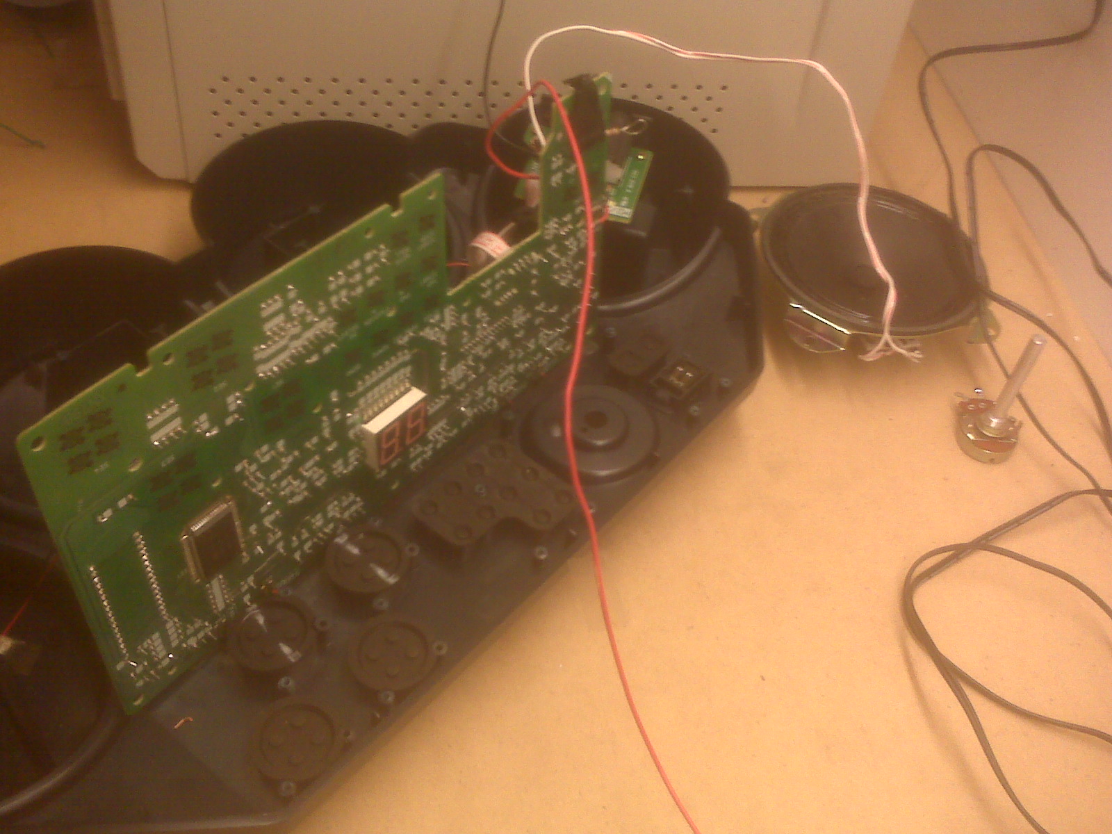

bbinkovitz
Joined: Jun 12, 2006
Posts: 338
Location: central ohio
PostPosted: Thu Nov 05, 2009 9:05 pm    Post subject: Suggestions for bending the Yamaha DD-20 drum machine?
Subject description: All I know how to do is installing switches on straight wiring.
I have found a few good bends just with straight wiring between pins on the chip. Are there other ones I should know of?
Does this instrument have an easily accessible bitrate-controlling resistor that I can circumvent with a knob to adjust pitch? I learned to do this to a cheap toy sampler at the e-m event this year but I don't know if more sophisticated circuits have the same feature?
Hey Beth, into circuitbending now. Nice. I don't know the DD20. I have had several Yamaha devices that work with crystal clocks, those are less reactive to pitchbend points.
As we've learned at the "Casperelectronics" Pete Edwards workshop the clockspeed (or pitch) resistor is usually near the CPU, that would be the largest most complicated IC at the board.
When there is a pitch resistor it often reacts to touching it with a damp finger, or touch it while simultaniously touching other parts of the circuit. So you'd be able to find your resistor yourself by touching the board all over. Do this while powering the device ON BATTERIES! Also I recommend touching singlehandedly, so you don't send signals across the body.
The risk of electrocution using an AC/DC adapter is largly exagerated I think, but I broke several adapters by shorting them.
Sending frequencies through the human body affects your fysiology. I have personally experienced turning slightly psychotic by prolonged touchcontacting a toy keyboard and spent hours scratching at the soundnames printed on it to highlight the secret messages that leaped upon me Smile . Running on batteries at least limits the power your device is able to emit.
Hi! Actually I started bending this little guy before I came to e-m this year. I thought about bringing it and ended up really wishing I had. I've slowly destroyed a few other Yamaha and Casio products as well... now I'm looking to create some more sustainable bent instruments.
My DD-20 looks exactly like this:
I don't know what "crystal clock"means (I Googled it and only found expensive Waterford mantlepiece clocks that you're supposed to give as a wedding present Rolling Eyes ) but it seems possible that what you describe might be the case here as well.
Yeah, I've already found the big IC and soldered a few connections to it. Actually in the DD-20 the largest IC and a second, slightly smaller one seem to be wired together such that the pins are pretty much the same. I've looked around both of these but not found anything that looks like a definitive candidate for clockspeed resistor.
I tried this already. With it plugged in, actually. Just stayed away from capacitors and also the left side of the board (where the power comes in) and didn't touch the speaker contacts either. Shorted all the resistors around both IC chips, while running the annoying demo, got nothing.
Woah, that has never happened to me. Sounds like it would save money on drugs. Laughing

Yamaha IC's sometimes have datasheets around somewhere. did you look for them, and if so could you get me a link?

bbinkovitz wrote:
I don't know what "crystal clock" means
The "crystal clock" has a crystal as a resonator to determine the clock frequency. Crystals have a fixed resonant frequency that can't be easily manipulated. I have the impression a lot of Yamaha's use them, the DD20 also I presume.
A datasheet is helpful to determine the "clock in" pin. Then you could isolate that pin from its components and feed it an clock of your own.

bbinkovitz
Posts: 338
PostPosted: Sat Nov 07, 2009 9:07 am    Post subject: Reply with quote  Mark this post and the followings unread
still looking for data sheet.
took some pictures, they are here:
http://img.b33p.net/pub/c/sxVkZ3sGbRfGmNVyPUwEEdzsk-Y3RAef

bbinkovitz
Posts: 338
PostPosted: Sat Nov 07, 2009 10:25 am    Post subject: Reply with quote  Mark this post and the followings unread
oh man, i broke it Sad
it still turns on and makes noise, but i have some kind of perma-bend going on that i can't switch on and off. i removed all the wires i had connected (good thing i took those photos!) and it is still there Sad

Danno Gee Ray
Joined: Sep 25, 2005
Posts: 1351
Location: Telford, PA USA
PostPosted: Sat Nov 07, 2009 1:05 pm    Post subject: Reply with quote  Mark this post and the followings unread
For what it's worth, it looks like, from the pictures, that the IC on the surface mount side (IC-1) is likely the CPU. The other IC (to which you had wires atached) is probably the ROM where the various drum voices and other data are contained.
It could be interesting to socket the ROM chip and play with the data with an EPROM and programmer..?
Also, the componenets near the CPU may contain a clock circuit for the CPU. I did not notice any crystals. There could be a ceramic resonator in there that might look like a capacitor at first glance, but playing with some of the resistors near the CPU could yield some tasy results.
bbinkovitz
Posts: 338
PostPosted: Sat Nov 07, 2009 1:11 pm    Post subject: Reply with quote  Mark this post and the followings unread
Thanks! I will experiment!

bbinkovitz
Posts: 338
PostPosted: Sun Nov 08, 2009 9:08 am    Post subject: Reply with quote  Mark this post and the followings unread
in case anyone still cares, i fixed it.
also i realized i was using lead-free solder Embarassed so that would explain why my solder kept defying the laws of physics and giving me problems and melting my board and all that jazz.

bbinkovitz
Posts: 338
PostPosted: Sun Nov 08, 2009 12:18 pm    Post subject: Reply with quote  Mark this post and the followings unread
try the bends that i show in the photos, when you turn the switch back to off, it goes back to clean sound. so you can still use it for the vanilla purposes for which it was intended as well.
er, it's hard to see, i realized.
pins 3 and 8 (from the top) on the left side (white and yellow wires) connecting to 2 and 3 on the right side (orange wires)
so, the yellow wire has a switch for each orange wire. and the white wire has a switch for each orange wire as well. total of four switches, makes interesting permutations. some of the combinations are more than the sum of the individual bends, depending on what kit you have it set on.

PostPosted: Fri Nov 26, 2010 7:12 pm    Post subject: My attempts at bending this thing Reply with quote  Mark this post and the followings unread
Hey all, newbie here. I just did a DD-20 as my first bent instrument, and I think it came out pretty well for being a lame-o crystal clock device. Here're the ROM bends I put in:
01 02 03 04 05 06 07 08 09 10 11 12 13 14 15 16
[ (C) 1994 YAMAHA ]
[ XP170B0 ]
[ 9942 D ]
17 18 19 20 21 22 23 24 25 26 27 28 29 30 31 32
Stable bends
3-4 - Weird dub echo / loop thing, depending on pattern
18-19 - Lo-Fi mode
18/19-32 - Noisy glitch
Glitches
18-8 - Self-destruct sequence / earthquake
I basically wired the ground of 4 toggle switches together and connected the other ends to 18, 19, 32 and one of the 4.7kOhm resistors. I also put a couple of push-make buttons in to do the weird echo thing and the "self-destruct sequence" With it in Lo-Fi mode you get some cool, weird sounds out of the sound effects pads.
I'll post some pictures later. Cheers!
All torn up before bending.
 Filesize:  445.66 KB
 Viewed:  344 Time(s)
