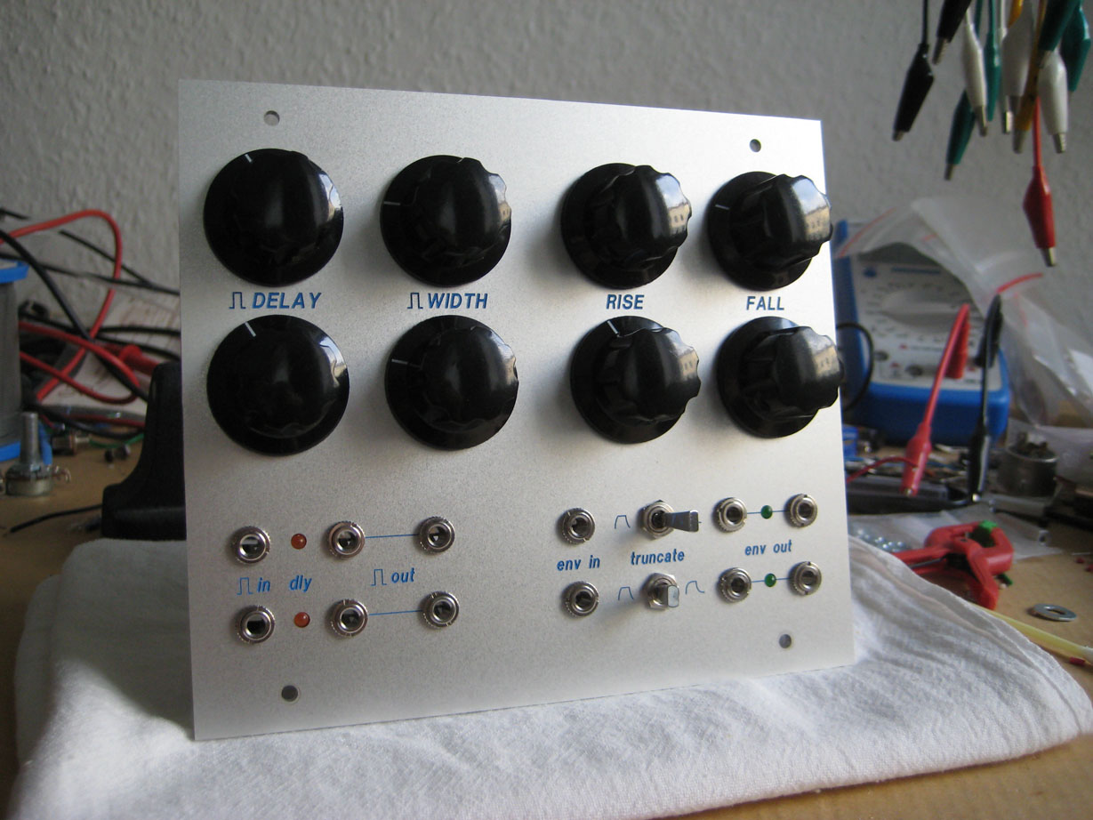

PostPosted: Thu Jul 09, 2009 11:27 am    Post subject: Ian Fritz AD/AR (Bridechamber) Reply with quote  Mark this post and the followings unread
Hi everyone,
Recently finished a dual build of Ian's AD/AR, using a pair of the Bridechamber PCBs. The pulse shapers' outputs are normalled to the EG inputs at the jacks, so that I can use both parts of the circuit independently if I need to. I added the truncation circuitry back from Ian's original version (only 2 diodes, so I'm not sure why the option isn't available on the PCB). Also added an LED each to display the EGs' outputs. Total depth behind the panel is only 3cm : )
I've been needing this exact setup in my system forever, and I'm so happy to finally have it that I'll probably follow the advice in the documentation and build another dual set : )
Thank you, Ian, for providing this great little circuit. And sorry that my camera has no dynamic range whatsoever!
Kevin

DGTom
Joined: Dec 08, 2008
Posts: 211
Location: Adelaide
PostPosted: Thu Jul 09, 2009 5:12 pm    Post subject: Reply with quote  Mark this post and the followings unread
Shocked
Wow! Work of art! I love the condensed Buchla look! (are those knobs readily availible? I've seen them a few times in the last few days)
a quad would be super nice!

DGTom wrote:
Shocked
They look like they could be these?: http://www.alliedelec.com/Search/ProductDetail.aspx?SKU=5431916&MPN=1913BW

Fetafarmer wrote:
Recently finished a dual build of Ian's AD/AR, using a pair of the Bridechamber PCBs. The pulse shapers' outputs are normalled to the EG inputs at the jacks, so that I can use both parts of the circuit independently if I need to. I added the truncation circuitry back from Ian's original version....
Thanks for the report. Glad it works OK for you. Do you find the truncation switch useful? I left it off because it didn't seem to be working the way I thought it would. Embarassed

PostPosted: Fri Jul 10, 2009 6:58 am    Post subject: Re: Ian Fritz AD/AR (Bridechamber) Reply with quote  Mark this post and the followings unread
Ian
This was the last module to get completed before tearing down my synth in preparation for a big move, so I only got one short session with it. The effects of the truncation switch were very subtle in the patches I built, but nonetheless, I'm happy to have it there as an option.
And yes, the knobs are Davies 1913BW.

creekree wrote:
however, one thing that is not completely clear to me: how do you choose between AD and AR modes? is there even a difference
Drive it with a short trigger and you get an AD. Drive it with a gate and you get an AR. An unusual, but simple and sensible response.
Ian
