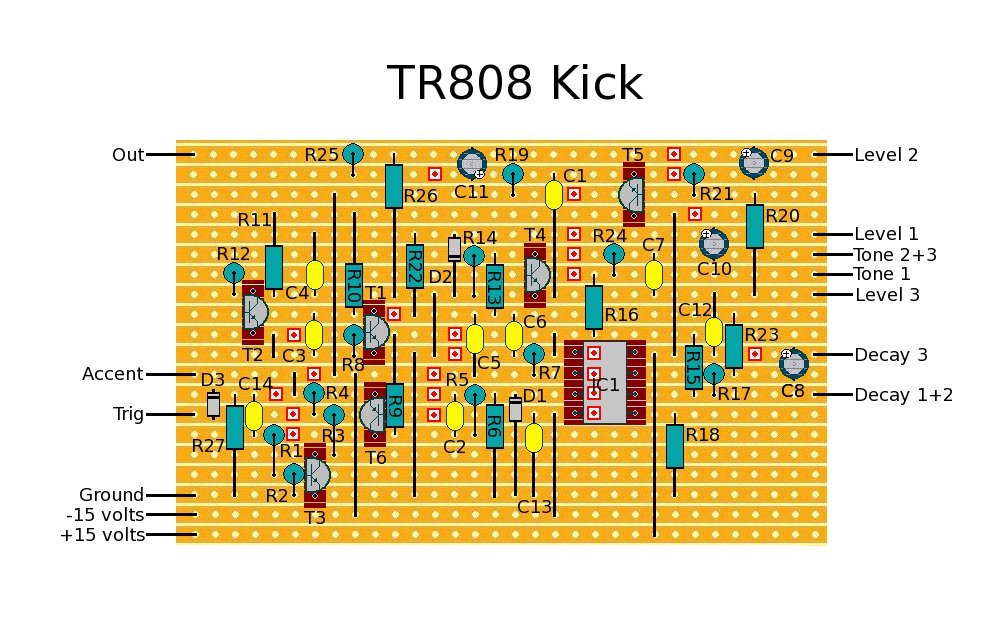

Here's a stripboard layout for the Kick drum.
The component numbering follows the schematic you linked to.
I'd check the pinout for the transistors and don't just put them in how they look on the layout, they might not match. Note that T5 is upside down with its emitter at the top, where as the other NPN transistors all have their emitter at the bottom.
The IC goes with pin 1 top left.
I've double checked the layout but I haven't built it so there may be errors.
Now updated to correct R18 and R19 error

Lektroid... Here is a response I received from Eric regarding C12 and C13:
C14 is 0.1u ceramic, same type as C12 and C13.

I have used these blue Monolithic Multilayer Ceramics for these caps. Seems to work ok. However, I still can't get this thing to trigger with a SPST as Eric suggests. Any ideas anyone?
Also, slacker.... Have you built this stripboard yet? Just wondering if it is verified. And can it be triggered manually? If so how?
I have used 10k A's for the level and tone pots. Not sure if this is correct but it seems to work...

Slacker... I think R18 and R19 need to be swapped on your stripboard layout. Should R18 read R19 and vice versa, or am I wrong... ?
Also, just realized that you haven't built this yet... silly me.
I'm prepared to give this a go and test it. Any advice on triggering this manually would be much appreciated! ...yeah, I know I've said this before...
Maybe easier if I swap them in the BOM... I need to edit that post anyway Wink
Yes you're right R18 and R19 are wrong, the numbering on the schematic was quite difficult to read. I've corrected the layout and reposted it.
When I get time I'll add the BOM to the layout, just wanted to post it so people could have a look over it.

LektroiD wrote:
I'm due a component delivery tomorrow, so I'll finish building mine then and let you know how I get on. Did you use a 914A, or a 4148 for your trigger circuit?
I'd be interested to know what bends you've found too!
Changing the DECAY pot to a 1M seems to hold the decay forever when fully dialed. I've probed around the circuit a bit with a piece of wire without any detrimental results... I hope! I put another pot (500K) between the left leg of R18 and the right leg of R23 and by turning it, it makes the kick drum sound like toms.
Still no luck at all with the triggering though! I have found a few ways of getting a sound out of it. One is to connect the ACCENT to (+), then take a wire from (+) and probe around the circuit a bit until it fires! Try (+) to pin 3 of the IC... or (+) to pin 5 for a kind of kick which rings out in various lengths.... or (+) to pin 6 for a real wobbly decay. Not for the purists I admit, but for those desperado's out there (like myself), it's an option.
At the moment to trigger it repeatedly, I have a simple circuit breadboarded up next to the 808 kick breadboard. It consists of a 9V battery, two transistors (548 and 558), a resistor, a 500K pot and a cap... This produces a steady CLICK noise when put through an amp. I've tried to use this to trigger the kick the 'proper' way, but no joy. I'm triggering the kick (if you can call it that), by running the (-) output of this smaller board, to (+) on the kick. The (+) of the smaller board is working in various places on the 808 breadboard... (see above paragraph)
(+) to R10 or R11 has some strange results if I remember correctly. Tie the accent to (+) and run a wire from (+) touching various spots around the circuit and see what you come up with.
I tried the Forrest Mims PULSE GENERATOR in the Engineer's Mini-Notebook 555 Timer IC Circuits to trigger this too, but no luck....
Hope those diodes have arrived LektroiD! Let us know how you get on...
Otherwise we'll simply have to wait for the Stripboard Jedi, Krunkus to sort out his lab and save us...
