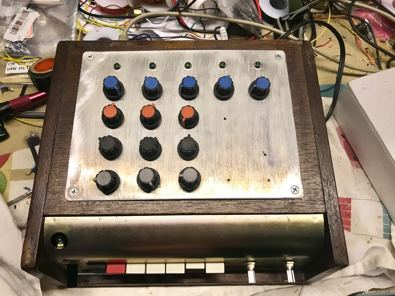

PostPosted: Sun Mar 13, 2022 12:09 pm    Post subject: Scarcity of Minipops documentation Reply with quote  Mark this post and the followings unread
To my knowledge, there are Mini Pops 7 , Mini Pops 120, Mini Pops (0) service manuals out there. Apparently there was a Mini Pops 5 service manual. But I have seen no evidence of a Mini Pops Junior service manual. Perhaps they were just disposable.
We are fortunate to have the Mini Pops 7 schematics. But, the Mini Pops Junior aka Univox JR-5 is a queer bird. I'm guessing it was made after the golden age of Mini Pops, and it seems to be somebody's effort to make a simplified home rhythm unit with a reduced part count. The concepts shown in the Mini Pops 7 manual are basically the same but a few important parts seem to be mutated for cheapness.
1) The tempo oscillator seems to have been simplified so that the trim pot has a narrow sweet spot. And unlike other Mini Pops machines, this is not a coarse or fine adjustment for tempo, it seems to adjust the voltage and shape of the rise/fall of the clock signal. A small adjustment can throw off the flip flops and truncate the pattern. On YouTube you can see people powering up an old Mini Pops JR and you hear this. On my unit it's temperature sensitive: it needs to warm up before I'm getting 16-step patterns.
2) There's no "preamp" as far as I can see; all the sounds are mixed with resistors and fed right into the output amp. There's little headroom and adding knobs to attenuate the sounds runs the risk of a noisy mix.
3) Worst of all is the power supply. It appears the Mini Pops Junior has a single power diode and two stages of RC to smooth out the DC power. After recapping everything I can't get rid of the baseline hum. It's around 20V and has barely enough current to power the board. Adding any additional circuitry runs the risk of creating a voltage drop that throws the pattern generator off.
I can imagine someone beefing up the PSU and adding an active mixer and individual outputs would need buffering too. But these are 5 very cheap sounding voices. Do they deserve the love?
I'm doing my best to modify my Univox JR5 without adding those big-ticket items, and I am running into the fundamental problem of poor audio quality.
Perhaps I am putting too much lipstick on my pig.
Univox JR5 with the faceplate removed.
