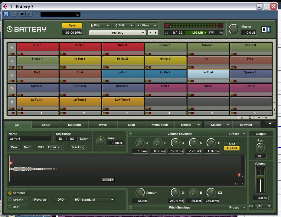

I had chance today to record a demonstration of a 2X drum loop exported into battery. I followed a slightly different process this time, partly because I learned a few things from the last time I did it, and partly because I was only going to use one drumkit - my previous kit was an combination of the sounds I liked the most from kits 0P0-0P4. My previous attempt also had some noise leakage from the original recording, and because I knew you guys were going to hear this I wanted to make sure it was eliminated!
Differences were:
*Used slightly more compression on the original recording to bring the level of the quieter parts a little higher
*Used a very light noise gate in Recycle to eliminate the noise floor
*Exported each slice from Recycle as a WAV file. My first attempt I'd exported the entire loop as a REX, which Battery can handle fine - but having each sample as a seperate file is easier to manage in Battery.
I used every item of percussion on 0P5 in the piece. In all cases they were EQd using Cubase Studio 4's parametric EQ, and I used compressor plugins similar to a 1176 and DB160. There were a mixture of reverbs, either using Cubase's Roomworks plug-in or a digital reverb plug-in. There's also a small amount of delay on some parts.
The heaviest processing was on the snare, mainly because I didn't like the sound of the default one. There's some distortion and EQ on there as well as some of the little tweaks Battery allows.
Please bear in mind I'm no real expoert at drum programming (something I need to work on) and I'm still quite inexperienced at sound engineering. Nevertheless I'm quite pleased with the result, and I'd be interested to know if anyone else has any comments!
As I said in my earlier post, i've not really regarded the kits too highly up until now, but since I've been importing to Battery I've begun to realise their potential - they sound very current, what with the trend for using 808s in pop music so much at the moment.
Attatched are the processed mp3, a completely dry mp3 from the original kit, a screengrab of the kit set up in battery and the MIDI of the drumloop just in case anyone is interested.
