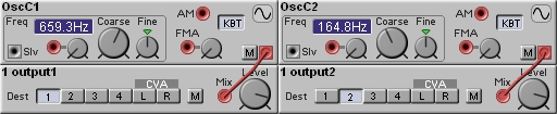

Hello ,
Strange things happen.I have two signal paths(internal synthese of the MM) but the MM don´t split.But if i take one signal he did.
What´s the problem?

Found the reason.
If you want split the Audio Channels.You have to route the Audio signal to the CommonVoiceArea (CVA) Very Happy

PostPosted: Tue Dec 29, 2009 1:00 pm    Post subject: Reply with quote  Mark this post and the followings unread
I thought you meant something like this...

PostPosted: Wed Dec 30, 2009 2:18 am    Post subject: Reply with quote  Mark this post and the followings unread
hmmm no.So it don´t work in the micromodular.You have to click CVA and create a new output.
Strange, i know. Confused but it works
