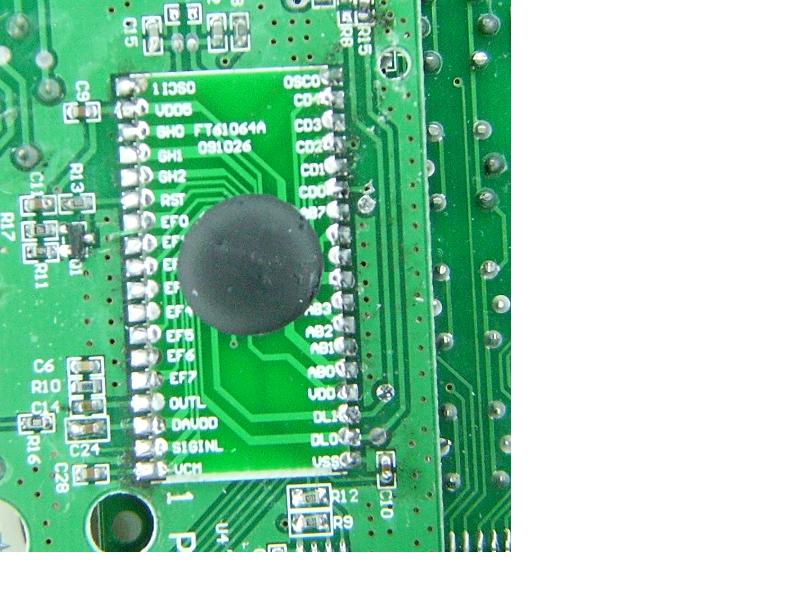

PostPosted: Mon Jan 11, 2010 1:18 pm    Post subject: Reply with quote  Mark this post and the followings unread
I checked U2 with the thing running - and it's just High and Low logic, as far as I can tell - perhaps just an inverter - I didn't see any change on the pins as I changed the operation of the device.
I saw a pic of the chip somewhere else - but I wasn't able to read the labels - so here's another shot for those interested.
OSCI1 OSC0
VDD5 CD4
GH0 CD3
GH1 CD2
GH2 CD1
RST CD0
EF0 AB7
EF1 AB6
EF2 AB5
EF3 AB4
EF4 AB3
EF5 AB2
EF6 AB1
EF7 AB0
OUTL VDD
DAUD0 DL1
SIGINL DL0
VCM VSS
 Filesize:  71.69 KB
 Viewed:  690 Time(s)
www.sdiy.org/rfeng

At the board with the LED switches are two 14-pin IC's who's numbers end with HC164, most likely some 74HC164 8-Bit Serial-Input/Parallel-Output Shift Registers.
Left of those is a 16-pin 74HC** (unreadable by glue blobs). What's that one?
The 16 pin one is..
74HC595D
8-bit serial-in/serial or parallel-out shift register with output latches; 3-state
XPT4871
The XPT4871 is an audio power amplifier primarily designed for demanding applications in low-power portable systems. It is capable of delivering 3 watts of continuous average power to an 3Ω BTL load with less than 10% distortion (THD) from a 5VDC power supply.

Good thinking electri-fire... Smile
Nice request.
After messing with it for a few hours with the 'scope and logic probe - I'm not convinced there is anything else to be easily had from this. I think the whole thing is in the epoxied chip, that it's uses a timed data stream for programming and functions and some simple bending won't get you squat.
There are some points where you can easily pick off a low logic, invert it to Hi and use it for an 8 step trigger or gate sequencer...but not for any audio signal other than the seven stock sounds.
I am also sure that if you throw enough time, parts and bucks at it and just use the keypad matrix you could have some useful device - but I'm not going there...
I don't mean to be negative - that's just the way it looks to me.
Hrmpf... ah well...I think I can trigger my Lexicon Vortex tap tempo with the sync pulse (after inverting and extending the pulse, the Vortex tap tempo is activated when connected to ground).

This thread got me interested in this little guy. There is a website that has the exact same thing but with a cooler sounding "blip" but it doesn't have the control options this thing has (and it's a REAL device instead of virtual).
So I checked out the video of it in action and I'm not that impressed with the sounds. They were actually kinda annoying and really artificial sounding (which can be good in certain applications, but a little harsh sounding for my tastes). If I fed it through some peddles think it would make it worth while to have?
It looks like it's not really bendable from what everyone's saying. For my noise projects I like that ambient/circuit bent quality from all of my instruments but I'm also thinking this would be kinda cool to have for a background sound if fed through a distortion pedal or a phase shifter with delay or something....what are the people's thoughts on this that own the unit?

Here's one guys opinion....
I bought two of them - and they entertained me for an hour or so.
I don't see I'll ever use them musically as they are.
I've enjoyed poking around in them to see if I could find some simple mods I thought I could use - but _I_ can't see anything.
I could be completely wrong on my thoughts on bending these earlier in this thread - maybe I've missed something.
I really hope someone can prove me wrong and find a great mod I can apply that won't cost me more and do less than what I can build myself.
If someone builds an interesting 'plug and play' interface for the keypad, these could be useful. The Blipduino site I referred to above could be worth keeping an eye on.
For now, I'll use these if I have nieces or nephews in the house and need to keep them entertained for a bit. That's the best use I can see for them, as is.
