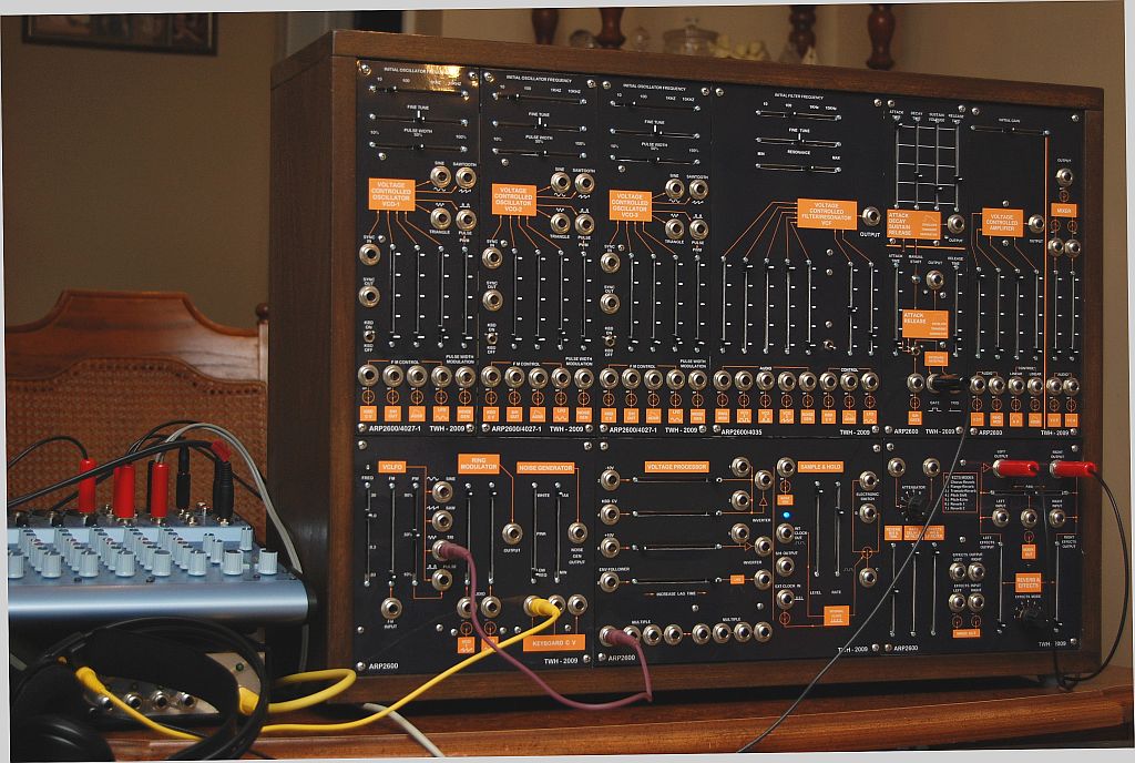

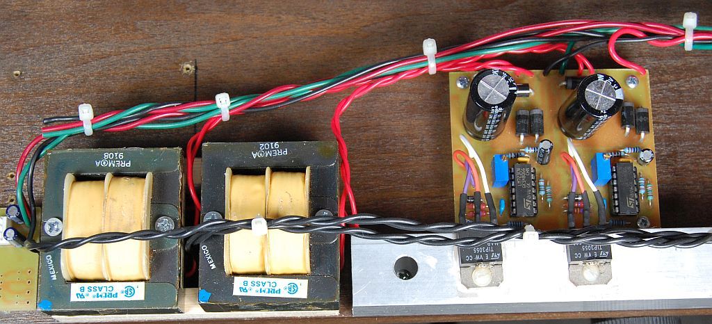

Hi all,

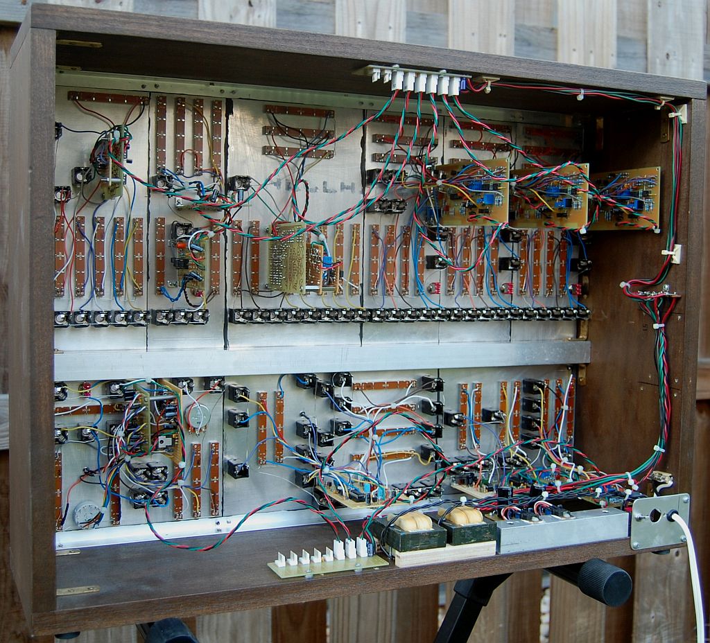

I have finally gotten around to posting some info on a DIY ARP-2600 clone synth that I built the last three months of 2009. The ARP-2600 was always very intriguing to me. I guess it's a combination of the slide pots, cool graphics, and normalized patching that attracted me so much.
The word "clone" is used loosely here because there are a lot of differences from the original ARP-2600. One big difference is that it is modular and not one large front panel. I tried to maintain the orange, black and white graphics as close as possible.
I also tried to capture the original sound by cloning the oscillators (4027-1) and the filter (4035- Odyssey) very closely. The other modules, VCA, AR, ADSR, Ring Mod., Noise, S/H, and reverb use various other designs.
I have never had the privilege of actually playing the 2600, so I cannot verify the closeness of the sound.
The size and shape are a little different than the original because I used a case from a previous synthesizer that I built. The front panel speakers were not installed in order to fit everything in.
All three VCOs are like VCO #2 in the original 2600, meaning they all have Sine, Saw, Triangle, and Pulse waveforms available, including PWM. I also added sync to each like the Odyssey.
A separate VCLFO (a 4027-1 in LF mode) was added, in order to keep the other oscillators always available for audio use.
For the reverb I decided not to use springs and instead used the Spin Semiconductor FV-1 Reverb IC.
The 1/8" jacks were traded for 1/4" jacks out of preference.
More documentation about the synth will be coming in the near future, but for now here are some pictures and an MP3 recording that I made in December.
I have always loved the song "Frankenstein" by Edgar Winter, which was performed on an ARP-2600 in 1972. There is a cool YouTube video of Edgar Winter performing it.
The MP3 file enclosed is "Frankenstein" performed on the DIY ARP-2600 clone.
Here are the specifics:
Recorded using a MIDI file, sequenced with Cakewalk Sonar. I did not create the MIDI file.
All of the synth sounds were created with the DIY 2600. The drums, organ, and guitar were created with the Thomas Henry GM Voice (a Yamaha daughter card).
The filter sweep at 3:17 - 3:54 was manually created. I watched the Edgar Winter video many times to see how he did it!.
I would like to take this opportunity to thank Steve Daniels of Small Bear Electronics for special ordering the 1 meg slide pots needed for several of the modules. I could not find them anywhere and contacted Steve about them. He now stocks several values of the slide pots if you are interested, for very reasonable prices!

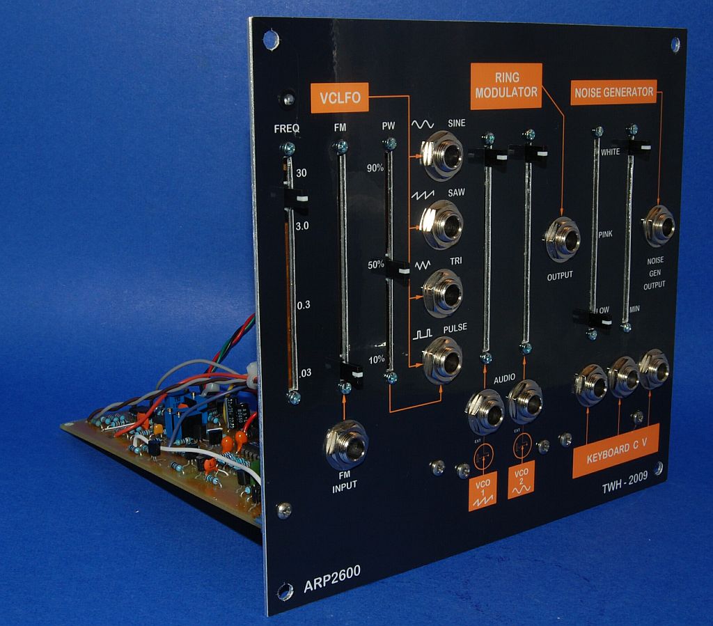

I created the graphics using TurboCad (a poorman's AutoCad), inkjet printed it on glossy photo paper, heat-seal laminated the photo, and then attached it to the panels using 3M spray adhesive. This is obviously not the most robust design compared to silkscreen, or engraving, but it does allow you use any colors that you want with stunning contrast.

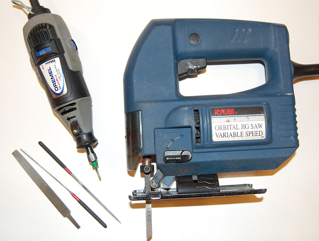

Without a doubt the hardest part of the whole project was cutting the slots for the slide pots!

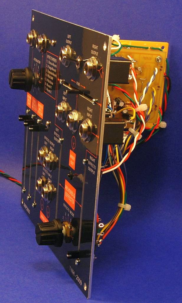

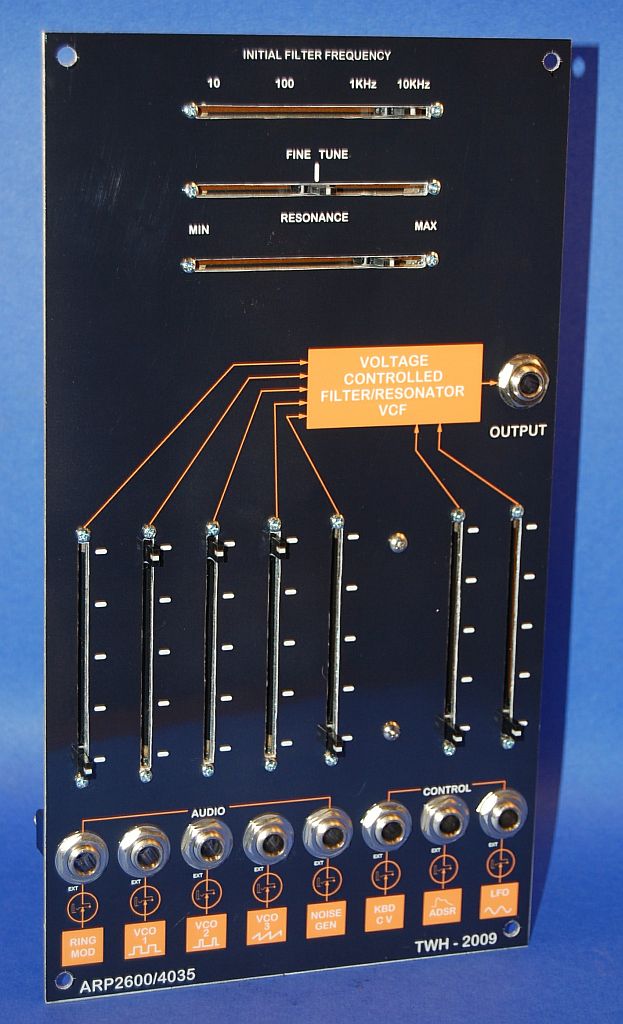

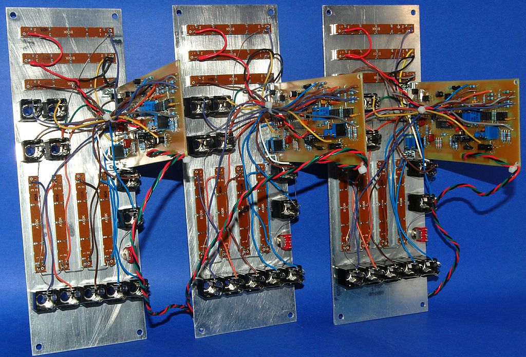

Here's more details of how it came together:
1.) VCOs - I created the PCBs by consolidating the 4027-1 module and the waveform generators into one board. The VCLFO is the same board with a larger timing capacitor.
2.) Filter - I used the 40235 PCB design floating around the web, but only built the 4 pole 4035 part of it. The added perfboards provide CV mixing, audio mixing, and output buffering.
3.) ADSR & AR- I used two of Yusynth's ADSR design and PCBs. One was wired for ADSR and the second one for AR only. His design is nice because it is simple and has a built-in LED driver
4.) The VCA is Thomas Henry's design and PCB. I chose this because it is very close to the Odyssey's CA3080 VCA design.
5.) Audio Mixer & PAN - Follows the original ARP-2600 design, I just perfboarded it.
6.) Ring Modulator - I used Fonik's AD633 design and PCB just because it is a simple, nice, clean deisgn.
7.) Noise Generator - I used Electric Druid's PIC 12F675 design, followed by the original ARP-2600 "White, Pink, Low Freq" filter circuit. It was all just placed on a small perfboard.
8.) The Voltage Processor, Clock, A/B Switch, and Sample/Hold - All built on a small perfboard. The Voltage Processor & Clock follows the original ARP-2600 design. The A/B Switch uses a DG211 cmos IC in place of the two FETS in the original design. I chose to use the LF398 S/H IC for simplicity in the Sample/Hold circuit.
9.) Finally, The Reverb - I used the Spin Semiconductors FV-1 IC, and a PCB layout floating around the web. This chip provides 2 reverbs and other EFXs without the mechanical boing of the springs. I added a small perfboard to provide input/output leveling and a diode matrix for binary to decimal conversion of the EFXs selection. This allowed me to use a rotary switch.
The pictures enclosed are of the VCO and Filter modules before they were installed. More module pictures to follow.
How did you cut the slots?

Subject description: Slot cutting info and Closeups of the ADSRs, Ring Mod, VCLFO, & Noise
Thanks again everyone of the compliments!
Especially Yves and Matthias, since I used some of your designs!

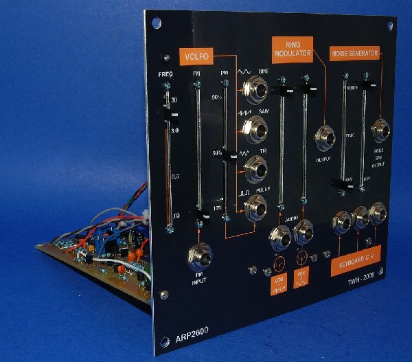

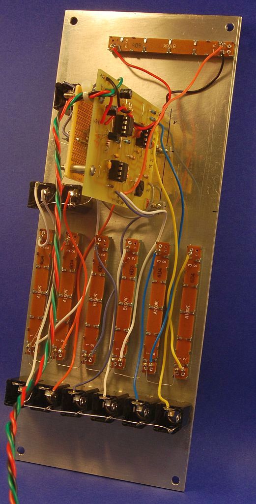

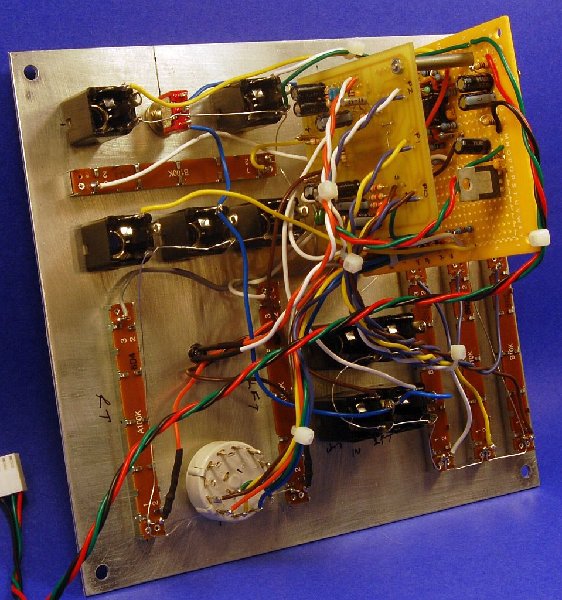

First I made a small entry hole using the Dremel tool and a PCB router bit. Second I made the major cuts using the jig saw. I then widened the slot with the router bit, and cleaned the slots up with several files. Expect several blisters on your fingers before your are done. Sad
I have enclosed more pictures showing the Yusynth ADSR & AR PCBs, and the module containing the VCLFO PCB, Fonik Ring Modulator PCB, and Noise perfboard.

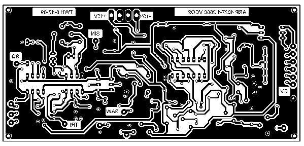

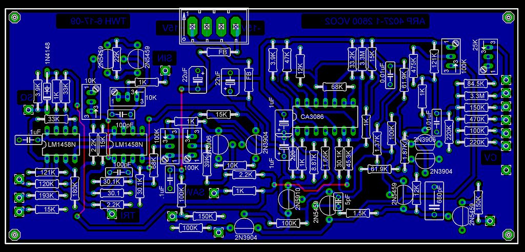

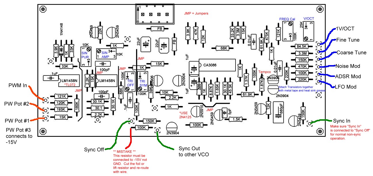

Hi Again,
As requested here are the details for the VCO PCB that I designed for the DIY ARP-2600 clone. I do not want to post the ARP schematics, please refer to the service manual which is readily available on the web.
This PCB provides all of the inputs and outputs of VCO #2 on the original synth.
I also added the Odyssey Sync Output and hard Sync Input.
I have been very pleased with the ease of tuning these VCOs, and the stability.

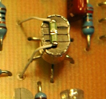

On my boards I applied heat sink grease to the flat sides of the expo 2N3904 and 2N3906 transistors, bonded them together with aluminum A/C tape, and glued the SMD tempco resistors (1.8K and 68 ohm) to the top. (see picture).

Here is the last installment of the modules that make up the DIY ARP-2600 Modular Synthesizer.
Here you can see the VCA module with Thomas Henry VCA PCB and mixer on the perboard.
You can also see the Reverb module with the Spin Semiconductor FV-1 IC. I used the Tonepad PCB layout and added the perfboard for input/output signal conditioning and the diode matrix switching.
I have included a picture of the Bergfotron power supply.
Lastly, the final MP3 demo is entitled "Midnight Express" from a MIDI file. As before, all of the voices except the drums are produced by the DIY synth.
Regards,
-Tim
