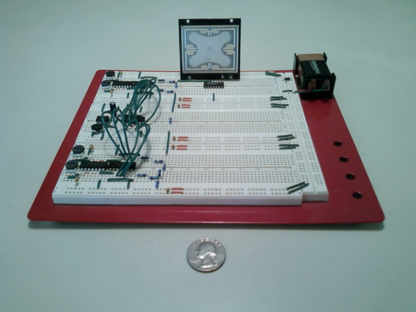

I drew up a schematic for anyone who wants to follow along during the show, attached below.

Built the above schematic on a breadboard... stayed up all night with Inventors help and now have the most incredible sounds filling my home! Thanks Les! Highly recommend this to anyone!
DO NOT MISS THE NEXT SHOW!
Soon as I can stop being mesmerized by this device, or the 9V battery runs out, I'll get around to sleeping then recording some sounds... and posting!

(btw,.. is that big thingy on your breadboard a speaker ?)

Here is an updated photo with Beginner's Lunetta projects one and two completed. Note that there is more stuff on the right side of Project #2 (the larger breadboard).
Les

On Inventor's breadboard (from Digikey.com)
1M thumbwheel pots, a value often used in Lunetta's , especially with 40106 oscillators, costing $1.25 , something like that.
Inventor's Breadboard Speaker
The flat speaker: ("pricy but good quality") is from digikey.com, where Les buys most of his parts.
It's a piezo speaker with Frequency Range 150Hz ~ 100kHz. It's high impedance, meaning it can be driven directly from an opamp, or even directly from the CMOS
outputs.
After soldering two little pieces of 24G wire it's great for breadboarding says Les, and during the show it was miked and the sound directly sent to the stream.
I noticed no difference to my 4-osc-lunetta heard directly through headphones.
Digikey Part number P11124-ND

I didn't have any 1M potentiometers though (only 5M but that didn't really work well) so I used LDR's. /.../ Next thing I did was making a second R2R ladder and connected the right. channel (or the left,..ehm,. the one that was directly connected to the oscillator) to it. Then I connected the LSB to the MSB of the first R/2R ladder and the MSB to the LSB of the first R/2R. I used the 2 spare inverters to make 2 more oscillators to drive the remaing inputs of the second R/2R. great stereo sound!
Cool. I built the QOL on a piece of perfboard. Lack of 1M pots had me use 250K, with 0.47 uF caps. Works fine for audio range.
I've been poking at the circuit with other components, and one of my LEDs between pin 7 and 2 of the opamp was following the levels of the HR2R DAC very nicely. Makes a nice randomish LFO. LFO speed is not always predictable, but a multitude of waveforms are available.
Next time, for LFO function I'd like to use some bigger capacitors.
I was thinking to drive the spare invertor sections with this LED, but unfortunately I have misplaced my LDR's.
Also the spare opamp sections want LDR's for sequenced filtering. Mine do.
Anyway, with this simple two IC Lunetta a lot can be done.
The opamps are an addition I'll definitely be using more.
And I want more DACs as well. Very inspiring fun little schematic.

Oh, about the LED, maybe I should mention, I had 1k resistors in the feedbackpath of the opamp.
That's why I said my LED is between pin 7 and 2 specifically. With + side to pin 7.
Response varied with different LEDs, your milage may vary, as they say, but worth giving it a try.
