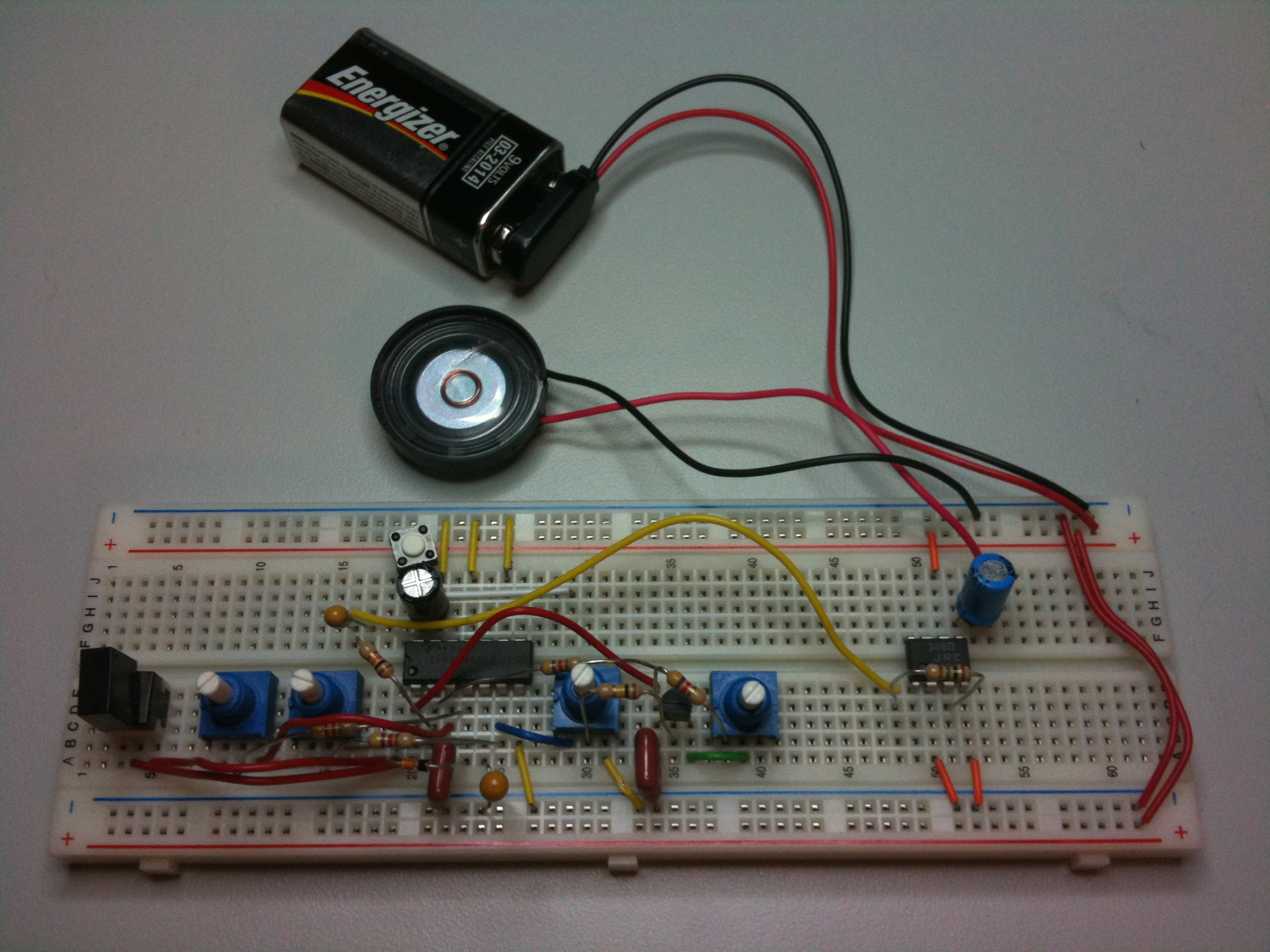

Hello all.
I have breadboarded a WSG and added a simple LM386 amplifier (see attached). It sounds OK. However, when I use it, it does not give me the "Twilight Zone" fade out effect on power down. This seems a bit odd to me since it works fine using a Radio Shack mini amplifier (which is at least 25 years old, BTW) which is also based on the LM386. Radio Shack was kind enough to print the schematic inside the amp case (see attached).
So, my question is: do I have to add all the other parts to make the LM386 a usable amplifier, or is there a simpler solution?
Thanks in advance,
Mickey

Hi Mickey -
I'm just guessing - but does the amp you built run off the same power supply as the wsg, and switching off the wsg also switches off the amp?
If so, I'll say the current draw of the amp just quickly drains the caps in the wsg that are responsible for the 'normal' wsg power down noises...
Zat make any sense?
Try a separate power supply on the amp and see if that 'cures' it.
bruce

Doh! Embarassed
That was the problem. It works fine now. Thanks, Bruce - for both the answer and the welcome.

Here is a pic of the breadboard. You can see the little push button at the top that feeds/cuts power to the 40106 while letting the amp run. Thanks again for the fix.
The WSG is an amazing circuit. Such a variety of sounds from something so simple. I am sure I will be playing with this one for a while. I will post some sounds when I get a couple of good ones.
