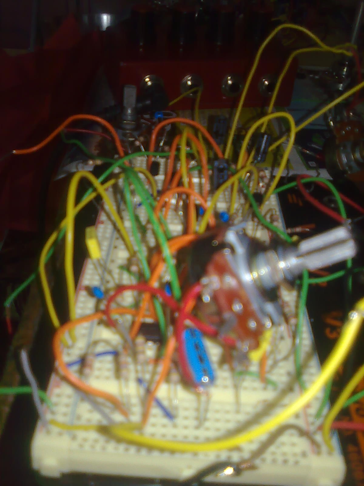

BUT... The problem here from my perspective is that the Kick is not firing. I fear what we would end up with is two circuits that we need to 'bend' to get to actually work.... unless I've made a mistake somewhere along the line. A bit of an ask, I know: What if I post you (with a return paid envelope) this kick stripboard... would you be able to plug it into something and check this firing mechanism? Getting a bit desperate here Krunkus! I mean, I can ALMOST live with it as is, as a device I muck around with, swap a few components and see what weird noises I can get out of it, but it would be nice to have it working as intended.
In the meantime if anyone else can get this happening, please post results!!!!

Hey -minus-,
It sounds like Lektroid got his working.
I think you just need to go over what you're doing and make doubly sure that it's wired right. I think part of the problem may be in the way you connect it to your drum machine (which I couldn't emulate anyway)
Do you have a camera? Sometimes a pic will show up something everybody else took for granted.
Do you have photoshop (or something similar) for drawing connection diagrams?
Knowing what you're doing right (or wrong) is a process which has to be learned. If I pronounced it a functioning board, you may never learn why. I know it can be frustrating, but imagine what it was like 20 years ago when we had no internet forums?
If I had the time I would be breadboarding all three of these schems and proposing mods etc. but I don't. I will try my best to help you out though. You may have damaged something while trying options. (describe what you've tried again in a simple point form)
You do have the ground between the drum machine and the 808 voice connected?

Alas, I have no camera to photograph this dastardly circuit board! I shall try to locate one on loan over the next few days.
In the mean time I will do the following:
1. Check the cuts in the stripboard. Make sure they are all in the right place.
2. Check soldering. Look for bridges. Reheat all joints.
3. Check value of all components. Check jumper wires.
4. New Batteries.
I think that perhaps you are right. I am not connecting this properly in terms of firing it from the specified trigger point. Or the method I am using is incorrect. I breadboarded up the trigger link I posted earlier:
http://ericarcher.net/devices/ir-net/
This has not worked either. I suspect it may be because I am unsure what pins to connect from the TL062 (I'm substituting a TL072). Not sure how you would tell from this schematic diagram... Also, the 555/4017 sequencer thingy didn't fire it either.
THE ONLY WAY IT FIRES IS MANUALLY WITH ACCENT TIED TO (+), USING A PUSHBUTTON SWITCH WIRED BETWEEN (+) AND THE SPECIFIED TRIGGER POINT.
***I would be very interested as to how ElectroiD got it firing, and what device is being used to do so.
It's worth noting that neither the PERFBOARD, this STRIPBOARD, or a BREADBOARD version would fire. Hmmm....
Ok, what I'm going to do is the above checking of the board. I shall report findings in due course... or offer it on eBay for an alternative use of some sort. Make an interesting belt buckle perhaps?

Embarassed ummm..... well..... urrrrr...... you see..... well, let me explain....
OK, I'll admit it: I F#*%'D UP!!! (BIG TIME)
What I did (and was doing the WHOLE time), was taking my output from this 4017 thing and connecting it to the proper TRIGGER input.....
BUT....
I was taking the (-) from the 4017 and connecting it to (-) of the 808 kick... when it should go to GROUND!!!!!!!!!!!! G-R-O-U-N-D spells GROUND!!!
So if anyone wants to remove me from this forum, kill me or send me something brown and smelly in the mail, please PM me and I'll give you my address...
Really sorry everyone! Yeah, it does trigger! (with a slight click)
ACCENT to (+) *IMPORTANT!
TIP to TRIGGER
SHIELD to GROUND!!!! ...NOT (-)
I'll test what things will trigger this.... YEAH, I AM STUPID!!!! doh

PostPosted: Sun Dec 06, 2009 2:36 am    Post subject: Reply with quote  Mark this post and the followings unread
Okay!
I'm going to ignore all the self put-downs and just simply ask,
Now,..... doesn't that feel better? Wink
You can't tell me you didn't learn something!
Until you've gone through a few situations like this, you're not a real technician. Everybody has been there and done that. It's how you learn. Electronics, just like any of the other ancient arcane arts, is a wealth of experience, gained through blood, sweat and tears. Each concept is built on others, and they all need to be hammered home through situations like this. Be proud of yourself! You popped out the other side, and now have a functioning circuit. Very Happy
N e x t !

Here's some photos taken with a phone of the evolution of this project. Put it into a box this morning:

Nice pics(minus)!. Looks like a work of art. Anyways to answer your question. I'm feeding the (accent) input of my 808 bd circuit with trigger out from my 606. I leave the 808 bd trigger in circuit alone. hope this helps.
