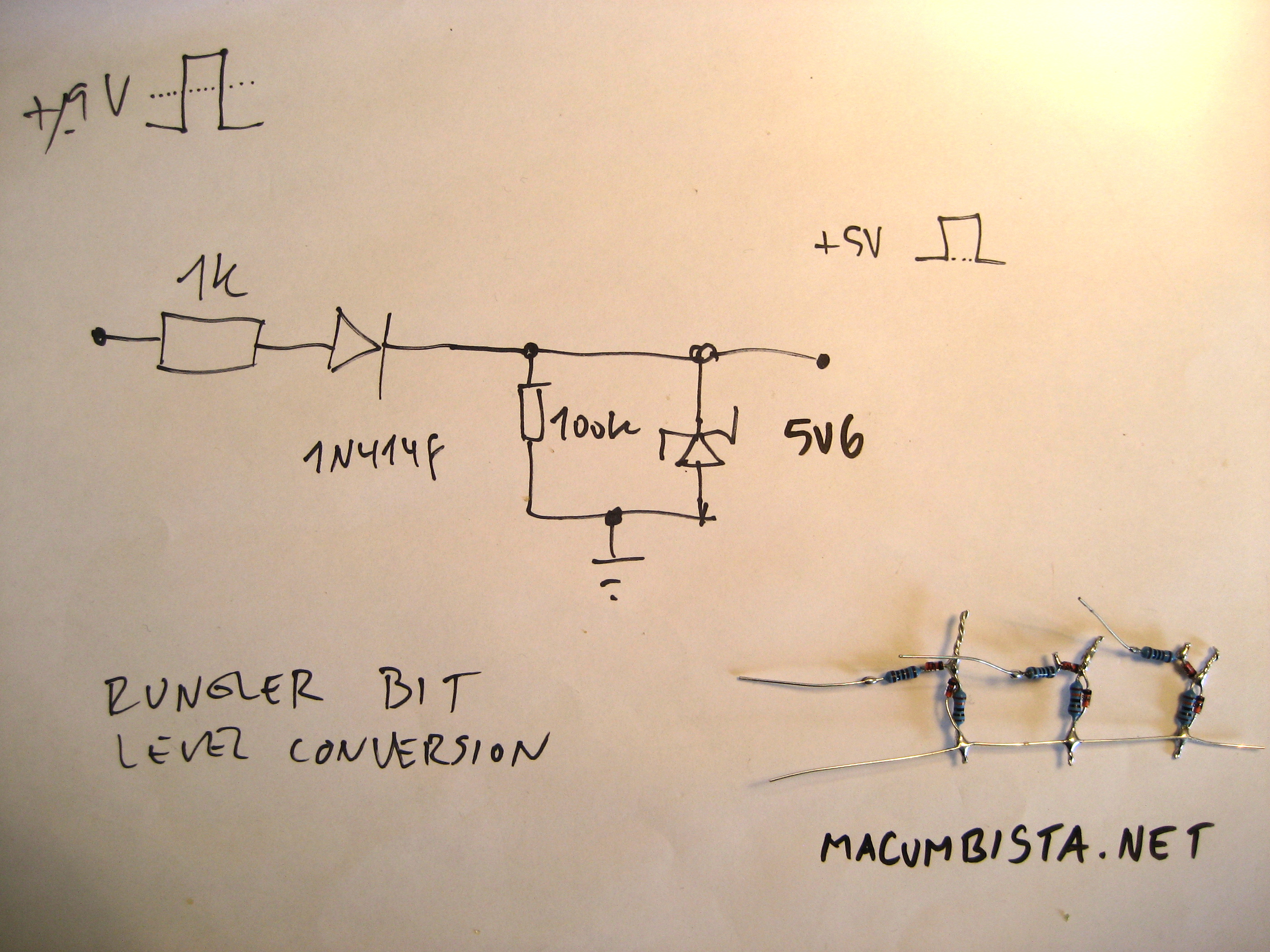

PostPosted: Sun Jul 26, 2015 8:53 am    Post subject: Reply with quote  Mark this post and the followings unread
A small gift from the Macumbista.net Benjolin laboratory: a simple converter to turn the data bits from the Rungler shift-register (pins 2, 12 and 3 of the 4021B IC) to 5,6V gate CV outputs which stay on as long as the corresponding bit stays "high". Normally these bits are +/-9V, making them pretty unsuitable for most purposes. Enjoy!
EDIT: first diode is 1N4148, forgive my handwriting! 1K + 1N4148 allow only positive voltage to pass, 100K + 5V6 Zener diode clamp to ground and chop output level to 5.6V. Perhaps there is a more elegant way to do this, but it works for me Wink
