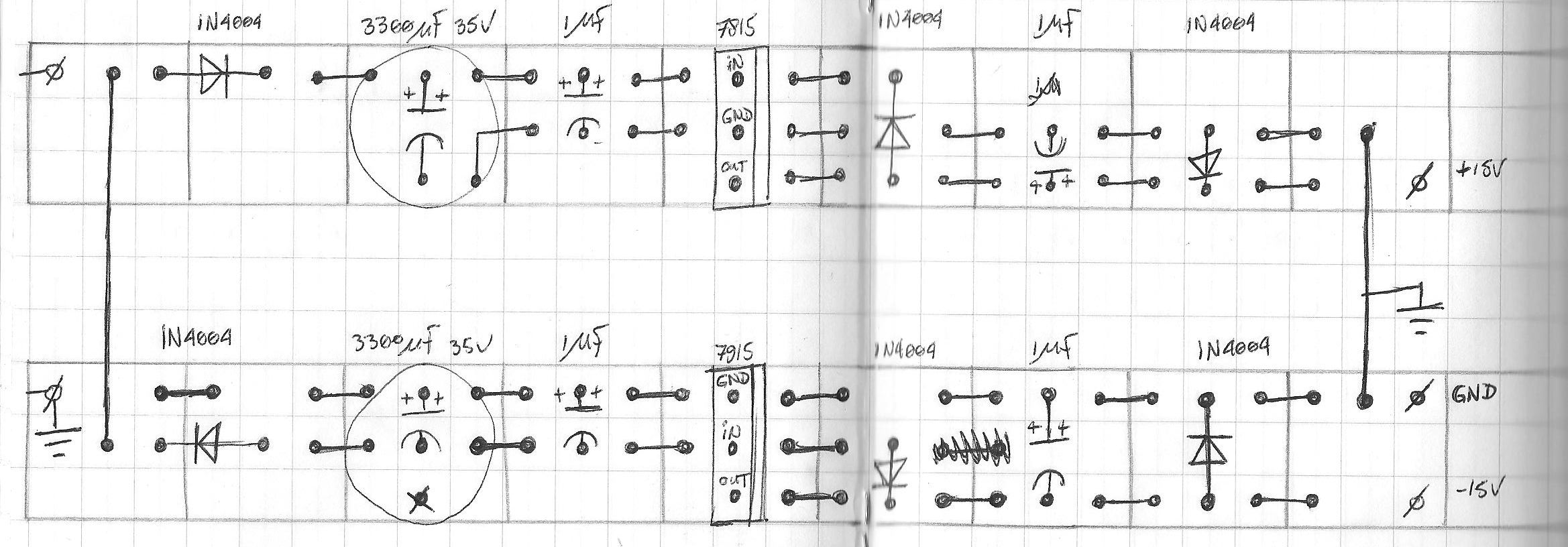

I've made the power-supply from this site on a piece of pcb with "3-hole" strips. I just changed the 7812 and 7912 for the 7815 and 7915. It works excellent I get a nice +15V, GND and -15V.
Here's my drawing of the print (every "thick" pencil square is 3 3-hole strips stacked)
On the left side you connect the AC adapter and on the right side you have the +, _ and GND output
from 15VAC to +15V, -15V and GND

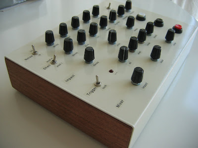

PostPosted: Tue Jun 01, 2010 6:46 am    Post subject: my standalone MPS version Reply with quote  Mark this post and the followings unread
this is actually the second version..
the first one was this:
more pictures and info in my blog:
http://noisedesign.blogspot.com/

Oneoff, Nice build. Would it be possible to post a full on photo of the faceplate? Just curious how you configured it.
Thanks,
Danno
