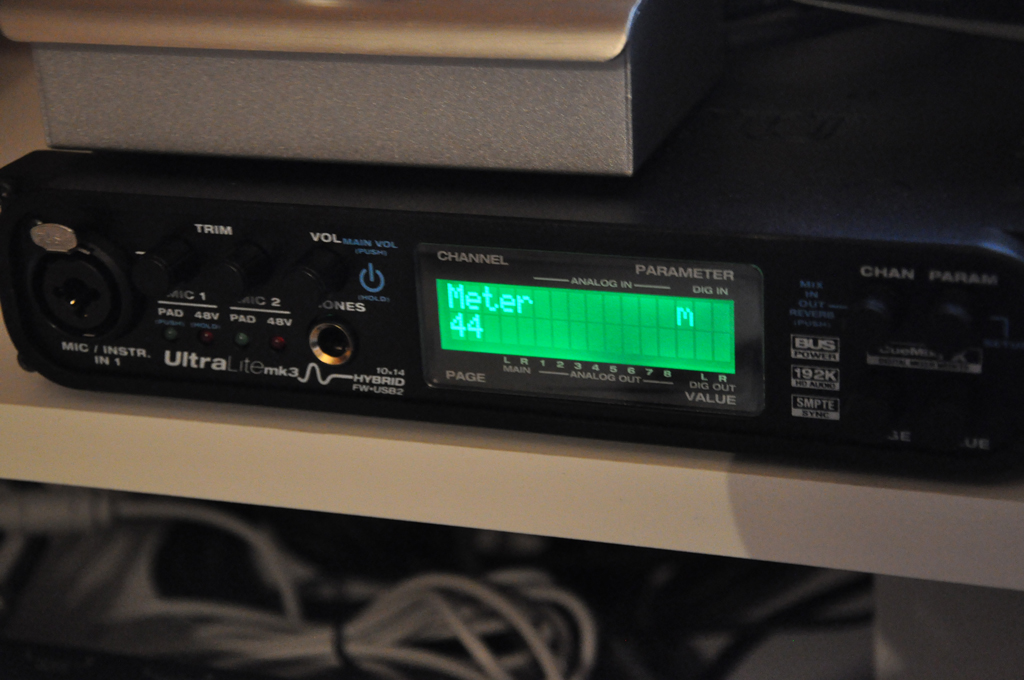

Bought a lovely red nord rack 2x the other week. Sounds fantastic...
However, I have only played it with midi keyboard and headphones connected to phones out. I now have tried to connect my audio interface (Motu Ultralite MK3 Hybrid) to the nord rack 2x, but have run into some problems.
Midi out to midi in
Midi in to midi out
A and B out from NR to analog in on soundcard.
Local set to off.
When I push the trig button I get a "m" sign in my sound card hardware screen. In addition, I do have a Virus C connected, and I hear this perfectly... Could it be m för mute?
Any ideas what this might be? I have tried to find the answer in the manual, but haven't succeed...

I don't know your interface, but I assume it indicates it receives Midi...

Hey
Well I guess thats good;) However, I don't get a signal in i.e an indication that it actually plays any sound. Other external devices as Virus C and Kaossilator produce sounds and indicates that sounds are played in the hardware as well as in CueMix FX software.

Hey Guys, thanks for all help:)
Gom some answers in another forum regarding the "M".
"The m stands for MIDI. In the top row, it indicates that a MIDI message was received. In the bottom row, it indicates that a MIDI message was transmitted."
Update: I tried to change Local to ON instead than OFF on NR2x and I now hear sound.
However, the manual recommends to use OFF when using a sequencer (as I do) I use both Sonar LE, and Ableton Live.
A bit confused here...
Makes sense ...
Local ON means the keyboard is connected to the synth engine locally, so that when you play you'll hear it. Local OFF detaches trhe keyboard so that it will send out MIDI only and will not make sound directly, the idea being that there will be software on the other side to echo the MIDI back to the synth, which then in turn will make the sound.
So when your software is set to echo back the MIDI it receives you'll want to have local off .. otherwise each not will sound twice. So it all depends on how you set up the software.
Hope that clears it up a bit.

It sounds like the Ultralite wasn't the problem. Yes, the little m means midi, and you get two. You can use the mixer in the Ultralite to mix the signals, and get DSP effects too. I didn't understand the "sound card" reference.

Unfortunately i don't get the lower m. only the top for recieving. However, I guess I must set up Sonar and Live correctly for midi messages.
