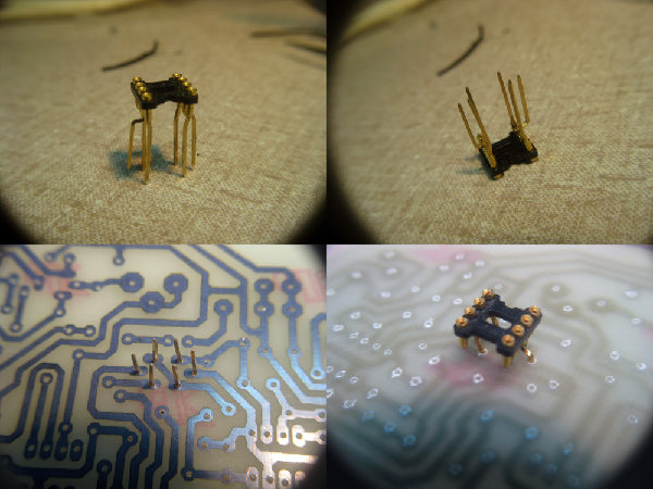

This doesn't pertain directly to your question, but this seemed like a good place to post this.
I'm going to build a couple of VCO-1's in the not to distant future as part of a portable synth I've been planning for a while now. I decided to use an SSM2220 for the expo converter and came up with a cute way to adapt it to Thomas's layout without having to modify any traces. I bent up the pins of a wire wrap socket to fit the pinout on the board and snipped off the two that weren't needed. Checkout the pics, its pretty easy to see whats going on. ( Apologies for my ghetto macrophotography. I just stuck an eye loupe on the front of my camera. Rolling Eyes )

philpeery
Joined: Nov 08, 2006
Posts: 137
Location: new jersey, usa
PostPosted: Sat Jun 05, 2010 2:10 pm    Post subject: Reply with quote  Mark this post and the followings unread
Hey Photon,
That's a cool trick, bending the socket leads like that, I may use that!
