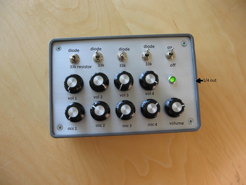

I finally put together the Heterodyne Space Explorer and boxed it up this weekend.
First I want to thank Beavis for posting this and his excellent tutorial. Also, thanks to electri-fire and Uncle Krunkus for their suggestion on how to deal with individual volume control (using a resistor and reversing the pot as electri-fire illustrated in his modified schematic).
I only made some minor changes to Beavis's schematic. First I left out the Sag pot. I then reversed the individual volume pots and added a 22k resistor before the wiper. This allows me to turn off individual oscillators without muting all of them. I also changed the values of the oscillator pots and used what I had on hand. For oscillator 1 & 2 I used a 1M pot with a 10k limiting resistor and a 104 capacitor. For oscillator 3 & 4 I used a 1M pot with a 10k limiting resistor and a 103 capacitor. I also added an Led to indicate when the power was on.
Here is a photo of it:

When I originally started to breadboard this I wanted to modify it so that each oscillator could put out either a square or triangle wave.
I was able to get a triangle wave out of each 40106 inverter by adding a 100k resistor and 10 uf cap at the input of each inverter. (I got this idea from a schematic in Nicolas Collins Handmade Electronic Music, page 162). The triangle wave worked and I could select either the square or triangle output using a switch. I verified each on my oscilloscope.
But unfortunately when I attached the triangle wave output to the wiper of a volume pot, the triangle wave would stop working. I tried inserting a preamp using CD4049 between the triangle output and the volume pot but could never get it to work.
I eventually gave up and just stuck with the 4 square waves.
Anyhow, here is a photo with labels added (I just typed them over the picture in MS paint).

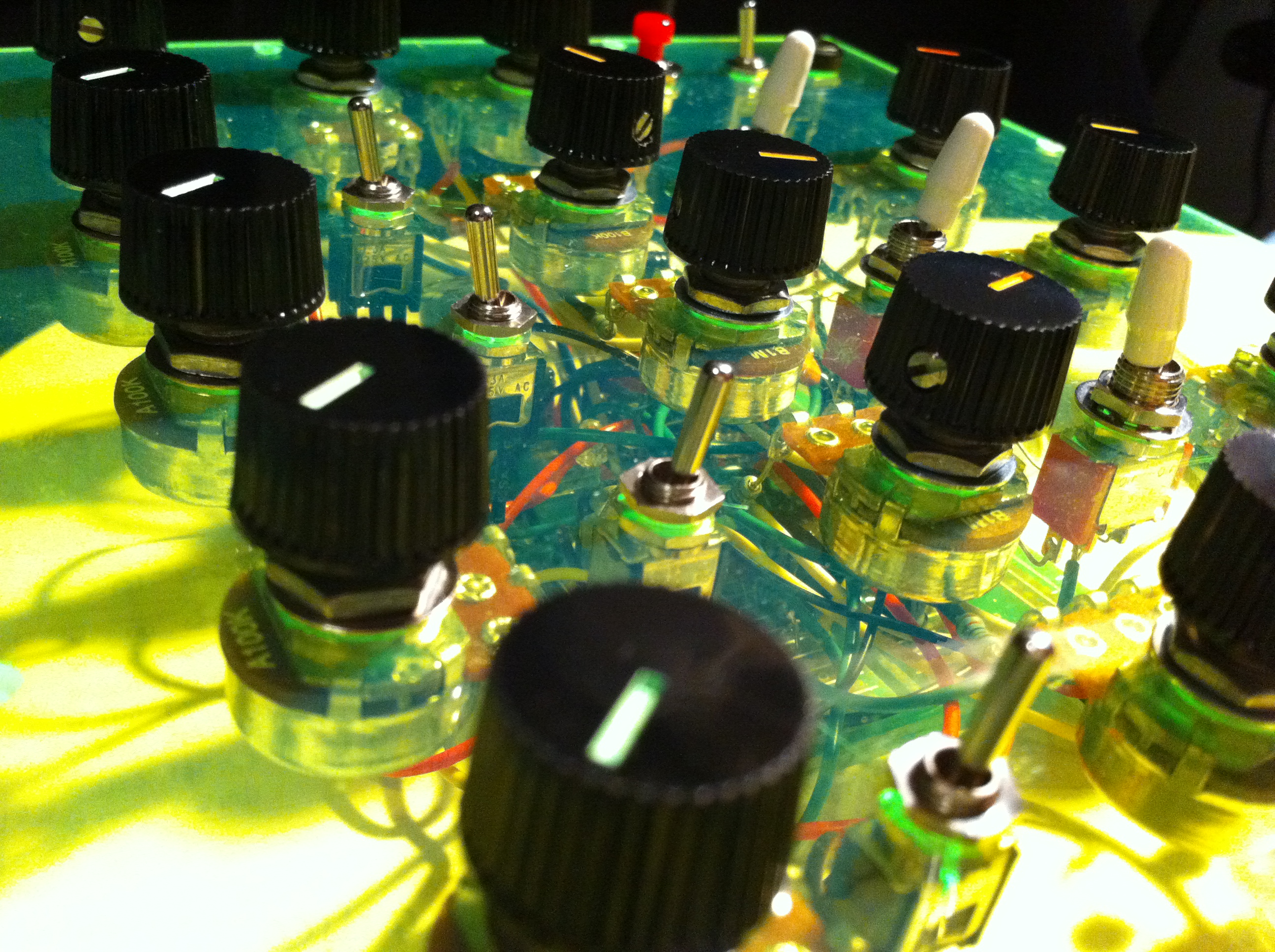

Hello all... I've been reading this thread for a few weeks now. I stumbled across it during my search for info about building a HSE or a WSG, and let me give a giant thank you to the contributors to this thread because without finding this, I would not have been able to build my own monster of a cross-breed drone box.
Details:
Neon yellow/green clear acrylic faceplate
4 X OSC
2 X LFO
Resonant filter (taken from WSG)
Panic button (taken from Cacophonator)
Voltage sag
Switchable capacitors for each OSC (for a bit of variety with OSC range)
LEDs for each OSC (no idea how I figured this out, probably from Beavis)
Let's see if I can manage to attach some photos and a link to a video of the monster on youtube...
http://www.youtube.com/watch?v=2dVXLBbwK4Q
For some info about who the Outsider is..
http://soundcloud.com/the_outsider
