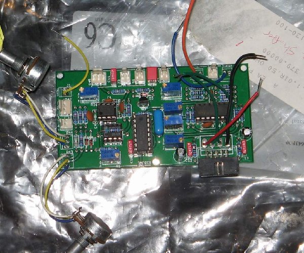

scott, did you yet try the low offset LT1013 together with the matched pairs from my proto for the expo? any difference?
Posts: 2810
PostPosted: Fri Jul 02, 2010 5:46 am    Post subject: Reply with quote  Mark this post and the followings unread
I am impressed with the tracking since my ears can't tell a difference of +/- 10 cents and considering the error of this VCO is anywhere from 10 cents and below across the usable audio band, that is pretty dam good !! Would be curious to see how this tracks at higher and lower temperatures to see what the CD4046 control input does then.
Oh Fonik, BTW, I like that amplifier also Wink In addition, I just started using the Burr Brown "OPA" series myself in my audio and CV paths for "high fidelity" audio projects.
Bill
PostPosted: Fri Jul 02, 2010 5:57 am    Post subject: Reply with quote  Mark this post and the followings unread
back then i made myself a PCB for the VCO core, using LT1013 and LM394, however i have had access to TI 4046 only, so i could not get it scaled anyways. i just ordered a couple of ON Semi 4046's to resurrect this project.
as said before, i had only the bad TI IC's on hand. nevertheless i still remember the moment when i powered up the VCO and played for about half an hour only with the hardsync Laughing

And the sync I recorded came from the attached picture: that's Fonik's PCB there. It has everything but the Sine output, I believe. I just hard wired coarse and fine tune pots, though you can see he put headers in for the panel connections, and Doepfer/MOTM type power connections.
Tom actually started the X-4046 last year, but, at the time I was using the HCF4046, which I couldn't get going all that well. We dragged Matthias into the project to get a third eye and (IIRC) he had the same type 4046 I had(?). Anyway, during that time Fonik graciously designed and produced a PCB in what seems like no time flat. By the time we got back to brass tacks, the summer was over and Studs disappeared back into the vortex of Academia.
Matthias: Last year while trying to figure things out, I replaced the LT with a TL. I never went back to the LT so I couldn't say how well it works.
If I were to market PCBs for the VCO as a tuned VCO module, I'd almost want to supply a tested 4046 with it; I can see someone getting the PCB and plopping in a TI or HCF and starting a chain of support messages to you. Laughing But, that's just me.

scott, it's great to see the boards was of use for you. Very Happy
Danno Gee Ray wrote:
If either of you decided to market a PCB with an accompanyaing tested chip I would buy the set.
i won't. i think magic smoke would be the right place for such a PCB/IC set!?
