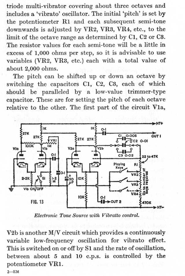

PostPosted: Tue Jul 06, 2010 3:51 am    Post subject: Reply with quote  Mark this post and the followings unread
not quite the same but a couple of versions of a simple tube based instrument.
one from Judd's book, other from Douglas
both have vibrato and operated by keys......relays?

v-un-v
Joined: May 16, 2005
Posts: 8932
PostPosted: Tue Jul 06, 2010 4:10 am    Post subject: Reply with quote  Mark this post and the followings unread
Thanks Andrew, but it doesn't quite address the question, because for one, that circuit is a multivibrator, which produces a square wave (not the tone I am looking for). I've got an excellent book by some guy (I think it may also be a title by Douglas- but much older, called "An Electronic Organ for the home constructor" which has the Ondioline oscillator in it, but yet again, it's a multivibrator example. There is also of course Eric Barbour's example which produces a sawtooth, but both of these are not heterodyning designs, and it is this design that produces such a nice tone (or as far as I can work out).

v-un-v - what basic waveform are you looking for? Seems to me that two HF sine wave oscillators (one fixed, one variable) fed into a diode ring mod should give you heterodyne frequencies in the audio range. Of course the upper sideband will interfere with your neighbours' TVs but they'll just have to suffer for your art). It would be interesting to have a variable waveform on the fixed oscillator, perhaps with some expressive controller.

Wouldn't a ring mod just produce a sum and difference of the two frequencies it was fed with, resulting in not such a nice sound? (I'm ring-modulated up to the eyeballs right now- but that's another story! )
This is the sound that I'm looking for;
The sound is very 'woody'. Almost hollow in nature. Could be a square but not quite.

just to throw another one in the mix, I have been experimenting with 6BN6 & 6JH8 tubes as demodulators. It seems neon oscillators produce sine waves when pushed (20kHz), so i tried to use one as a fixed oscillator and another as variable, kind of a BFO. Found (and was warned) that neons get pretty unhappy at 20kHz and the signal amplitude gets very small (~2V in my case).
So will go back to trying a simple triode-based MV as the fixed oscillator and one of the circuits above as the variable (thyratrons are also not too keen to operate at 20kHz)

v-un-v "Wouldn't a ring mod just produce a sum and difference of the two frequencies it was fed with". Exactly. So, if you had a 100khz fixed oscillator and another that varied from 100-120khz, the lower sideband would be 0-20khz and the upper is in the RF range and easily filtered out. So the result is a variable pitch and not the familiar klang produced when carrier and modulator are both in the audio range.
