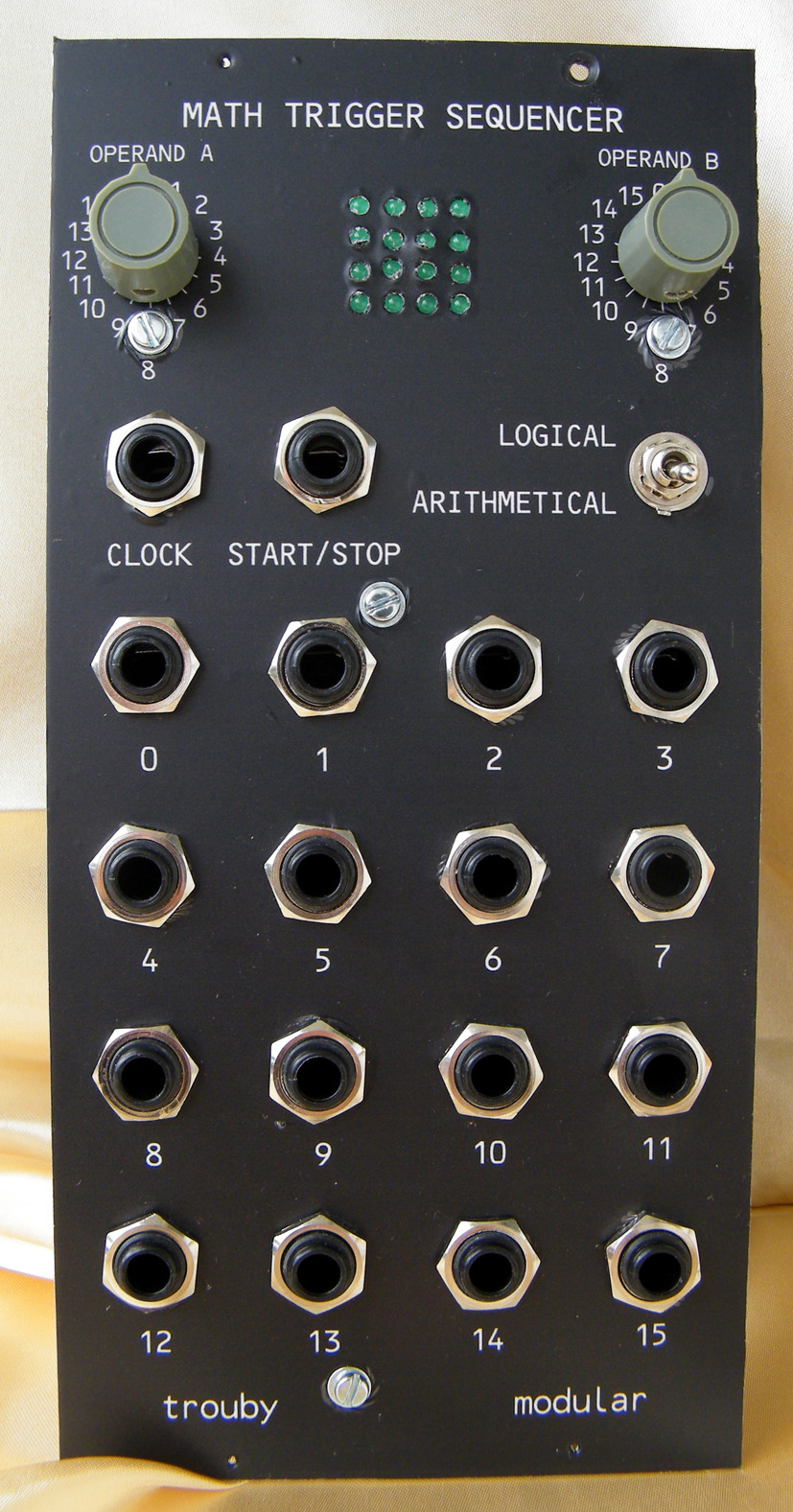

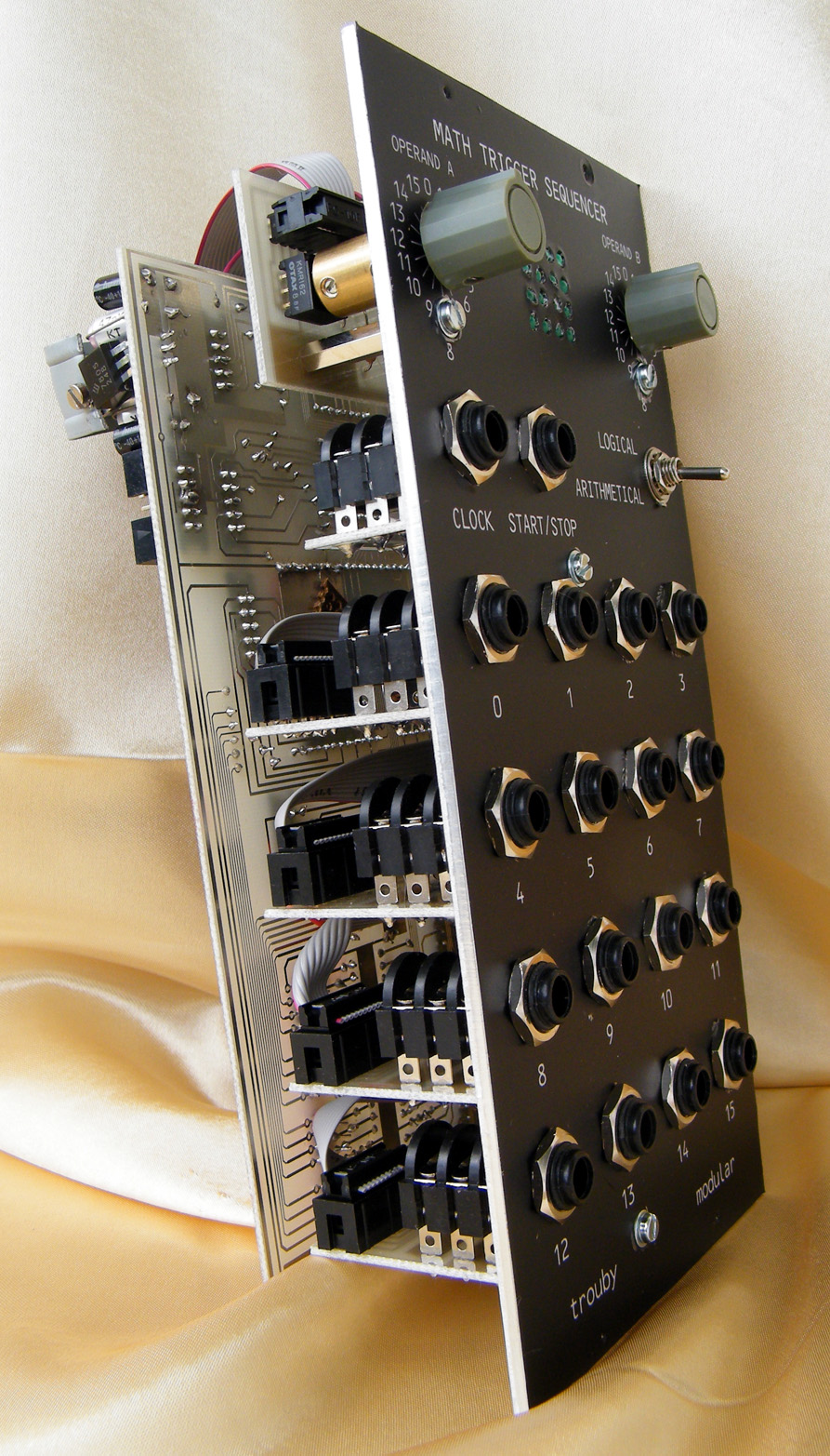

a new gimmick is finished ans contains a 4bit ALU - arithmetical-logical unit - it can do math. 4bit = 16 steps - 1 bar - sequencer.
it has a clock and S/S/Go input, a switch and 16 outs - for each result one.
the ALU has: 2 operands A & B, the function itself get clocked by a counter, the result goes to a line decoder ans trigger converter.
the result is visualized.
cased of the constant values but variant function the result varies in different ways - some combinations has every value of the 4bits but as difference sequence Smile
to trigger percussive sounds - 2 beatboxes in bad condition have to die for external trigger (will be 19" case)
power is curetronic - DotCom can be a place problem:
top & bottom place for mounting is 10mm - not 12,7 for 1/2"...

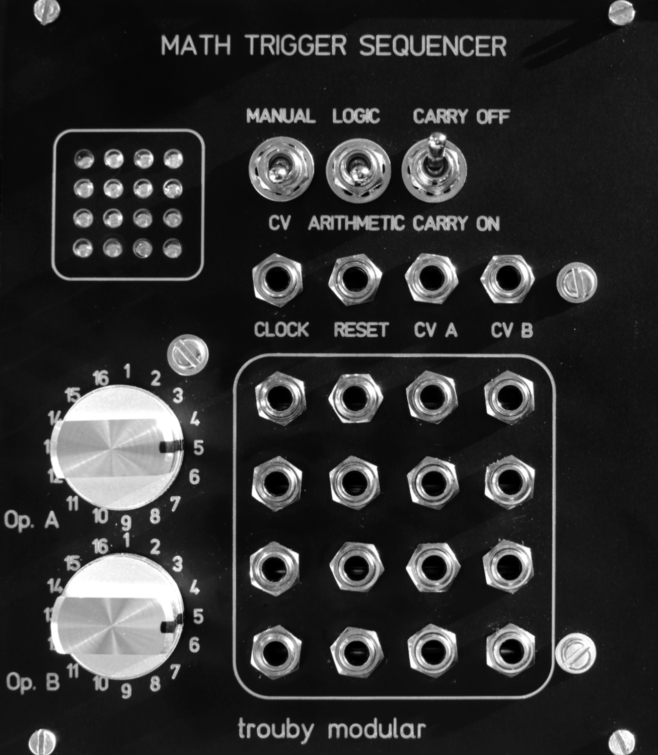

PostPosted: Sun Jul 01, 2018 11:01 am    Post subject: Reply with quote  Mark this post and the followings unread
after years of developing, i did an eurorack version w/ dual CV input (w/ ADC). zero series on ebay, full version has 4mm LEDs. 65-70 mm deep, 22 UE wide.

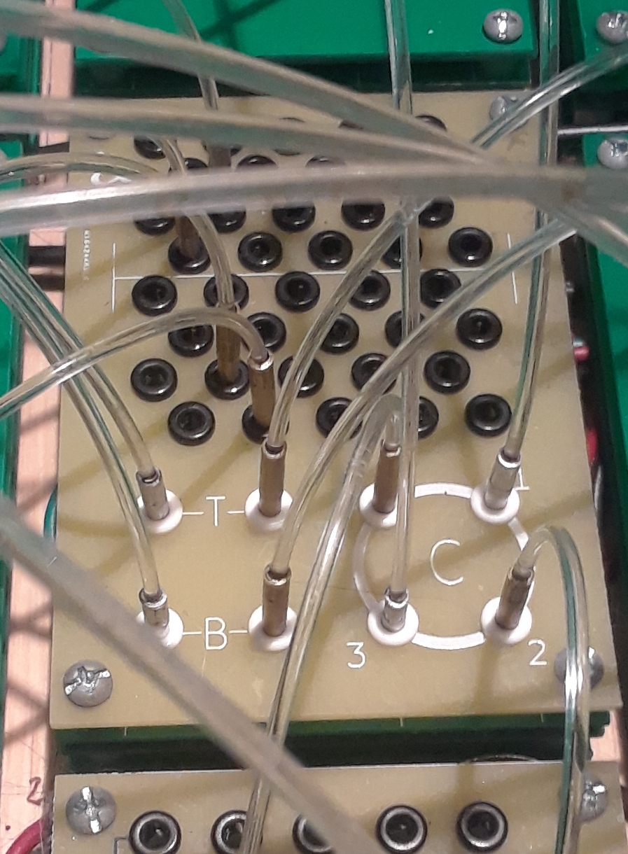

Here's one I made for my diy optically patched synth. It uses 2 bits of a 74ls181 ALU chip. The 4 control inputs, which select any of the sixteen possible logic functions, are the 4 in a circle around the "C".
 Filesize:  689.21 KB
