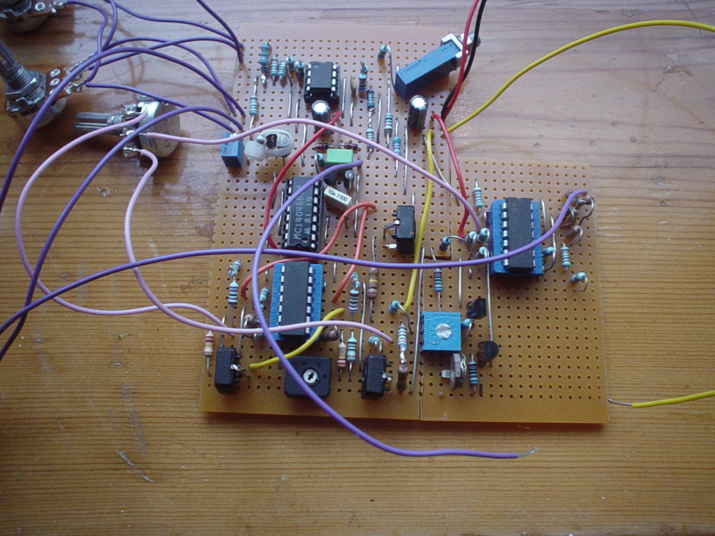

PostPosted: Tue Jul 20, 2010 12:48 pm    Post subject: Reply with quote  Mark this post and the followings unread
I've built the core of it on vero, and using an MC14046 I was able to tune it over 5 octaves without too much trouble. I did try it with a TI CD4046 as well and like Scott I couldn't even get it to do 1 octave.
If it's Ok with everyone, I'd be happy to post a layout once I've built the rest of it and tidied it up a bit.
A quick question for anyone who's built it, do the trimmers for the wave shaper sections need to be multiturn or are single turn Ok?

PostPosted: Tue Jul 20, 2010 4:34 pm    Post subject: Reply with quote  Mark this post and the followings unread
Wow! Excellent to see! Very Happy
If you're looking for clearance from my layout - please! Go right ahead! Very Happy I myself am quite surprised that the previous fanfare has almost completely died. Sad

PostPosted: Tue Jul 20, 2010 4:40 pm    Post subject: Reply with quote  Mark this post and the followings unread
Hello Slacker,
Yes, please do post your layout. Thanks!
And thanks for the confirmation on manufacturers. I'm still amazed at how rotten the TI chip is for this. It was a good thing I didn't use one myself or I probably would have given up early on.
Only the tuning trimmers need be multiturn. The waveforms are easy to tweak with ordinary trimmers.

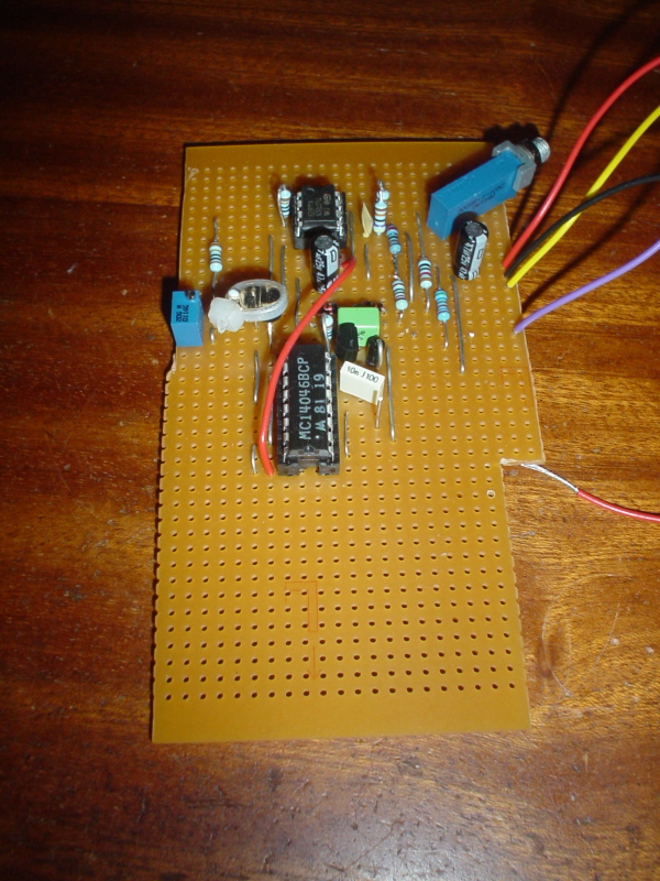

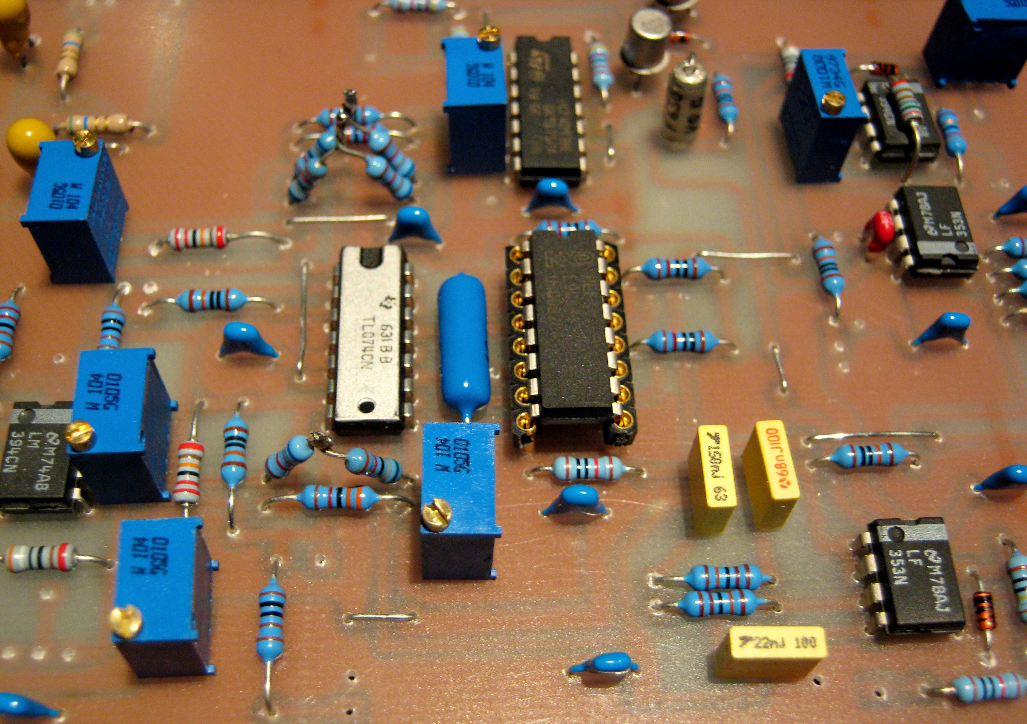

PostPosted: Fri Jul 23, 2010 2:55 am    Post subject: Reply with quote  Mark this post and the followings unread
Thought that i would chuck in my progress on the X4046. I started a PCB before Rykhaard's came out... I have finished stuffing it but have yet to test it. I checked in a couple of additions in an extra sync mode which makes use of the Phase Decriminator that was unused otherwise. It has required the addition of a 4093 and an opamp for the filter (probably overkill for the filter) but I was interested to see how it works. I now think that I should have gone further and added some dividers to sync to octaves etc. I have given some thought to hacking in a PSoC 8 pin chip to do this... I have been fighting with a Moog 921 VCO clone and it makes use of an analog multiplier to provide sync so I was intersted to see how the 4046 will work. Not as well I suspect as the phase descrimination is in the digital domain and I'm not sure that you are going to get local maxima at some of the common ratio's... Will let you know how it goes! Thanks to Thomas for another very clever adaption on an Oscillator Chip!

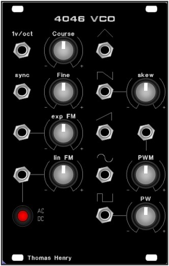

PostPosted: Mon Jul 26, 2010 4:55 am    Post subject: Reply with quote  Mark this post and the followings unread
so i decided to add two 4046 VCOs to my new cabinet. i started to populate the two left prototype VCO core PCBs. they output triangle and saw only.
i plan to build one saw/tri VCO and one full blown VCO (requires additional wave shaper PCB).
below my panel sketch for the full blown one (the pushbutton will have a built-in LED, the legend will change to AC only then):

PostPosted: Mon Jul 26, 2010 9:27 am    Post subject: Reply with quote  Mark this post and the followings unread
Embarassed course is something different than coarse, isn't it?

PostPosted: Tue Jul 27, 2010 12:48 am    Post subject: Reply with quote  Mark this post and the followings unread
Well my PCB worked OK -- apart from a missing resistor and a tiny short, which took a little while to find. I used an NXP (Phillips) 4046 and all seems well. Got the expected shapes after a little bit of tweaking. The triangle and sawtooth are a little hot being about +- 5.6V -- I am thinking about changing the feedback resistors slightly. Still need to trim the V/octave controls but I have misplaced my temco's... Also using the PLL discriminator for the extra sync mode still needs some more thought...
Hopefully will be able to tune this tomorrow after a rummage in the shed for the tempco's and post some graphs. I have a Fairchild 4046 as well so will try that for academic interest.
Thanks for confirming that.
Just thought I post a picture of the completed board. It's a bit of a mess because it's built on 2 pieces of vero but it all works great Smile
The layout will be neater and use less insulated jumpers, I've just got to correct a couple of errors, generally tidy it up and re draw the expo converter because I used a different version to the original. Hopefully it will be ready sometime next week.
 Filesize:  389.44 KB
