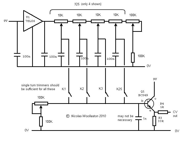

Here is a suggestion for how to turn this circuit into a keyboard controller. This circuit is currently completely untested.
Nicolas

just built one of these from my copy of "The Terminator"! This thing is awesome; I used a 5 volt reg and a 2n3904 and am getting just under 5 octaves on the Saw VCO. You rule Nicolas!
Which resistor would I need to sub in order to get a range control pot?

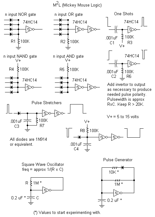

Thanks for the reply. What about a trigger, could I use a schmitt-trigger configured as a one shot?

try the one shot below, i would think it should work. not sure how to estimate frequency. you could always use a trim pot to change the range.

So I think I've figured out a good solution for a gate/trigger. If I have a comparator that compares the CV being played to 0V I could have it output a constant 5V for the gate as long as the note is on. For the trigger I found the CGS gate to trigger converter. I'm going to try this over the weekend to see how it work.

Also found this one from MFOS, which uses the one-shot 40106.
http://www.musicfromouterspace.com/analogsynth_new/HOT_TIPS/PDF/gatebuffer20090923_assembly.pdf[/url]
