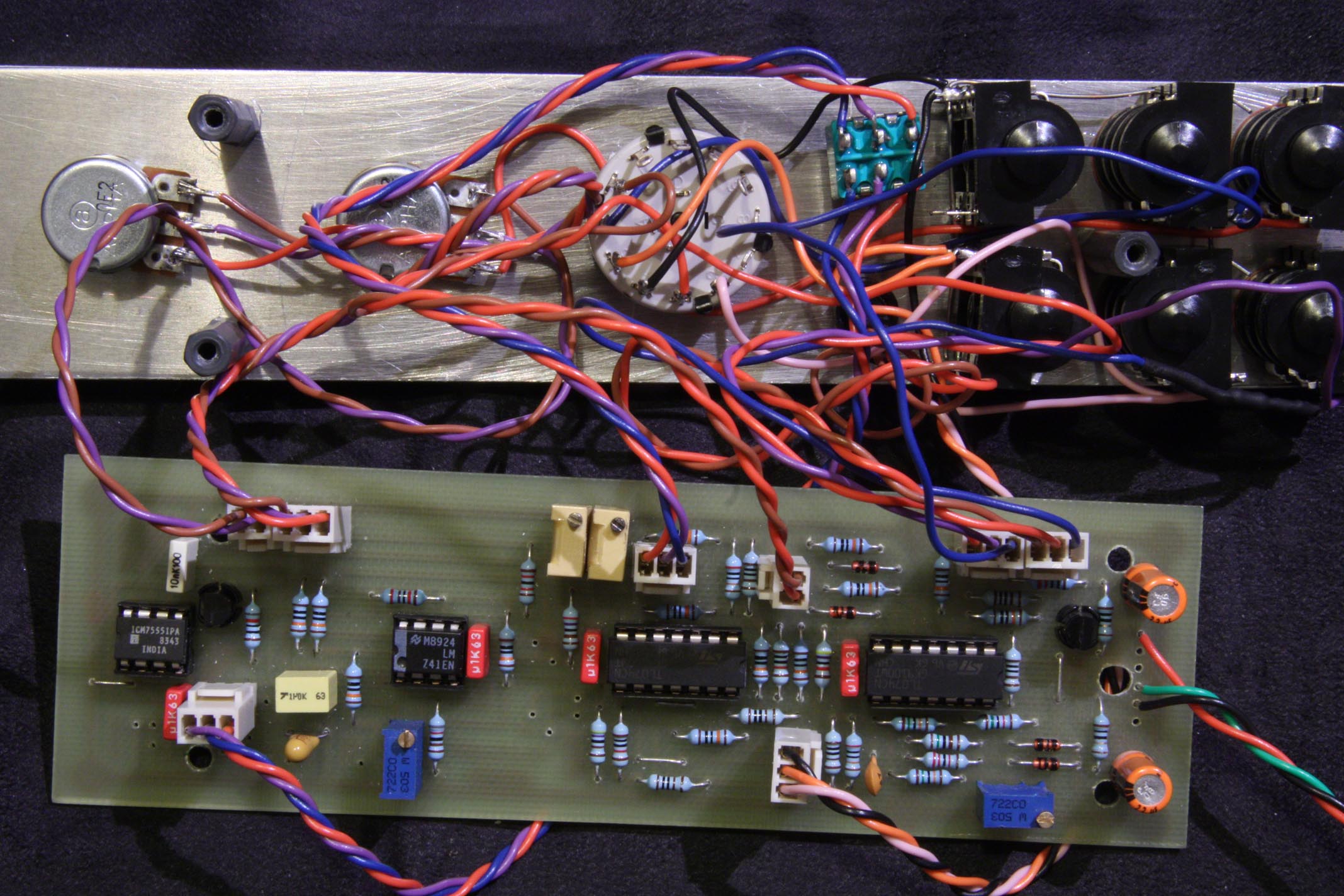

I've just built the VCLFO (1), but when the switch is set to slow, the waveform changes to the following from the INV out:
SINE = saw
TRI = saw
SAW = triangle
RAMP = ramp
SQR = constant -V
and the following from the individual outs:
SINE = ramp
TRI = ramp
SAW = ramp
SQUARE = constant +V)
Switch in fast mode individual outs:
SINE = sine
TRI = triangle
SAW = ramp
SQUARE = inverted square
Fast mode, INV out: Everything checks out as it should, this is basically the only way it works properly.
I've looked over the board but everything seems to be ok, I've double checked the wiring to the switch too, but can't see a problem there either.
I didn't match the diodes as suggested, as I don't know how, but I don't think that would be the cause of this.
Also, there is no layout with component designators (only values), and I found it was short of a couple of resistors; it is short of a 10K and a 100K, but I couldn't tell you where they should be as there is no layout listing the designators, I just had to work from what there is available.

PostPosted: Mon Sep 13, 2010 6:39 am    Post subject: Reply with quote  Mark this post and the followings unread
Strange behaviours since the inverted switched output comes after the individual outputs, therefore if one has the right signals on the inverted switched output you should get the individual outputs OK unless they are miss-wired.
However the fact it works in fast mode denies the miswiring hypothesis...
Can you post some photos of your module, componant side, track side and panel wiring ?
Did you adjust the T2a and T2b trimmers (those labelled SAW BIAS) ?

Hi, sorry about the delay posting the photos, here are a few pics, hopefully they are clear enough to see everything. If you need more from different angles, please let me know.
Thanks for the support.

I have some stupid questions... because I never used this type of jack sockets : are you sure of the pin wiring ? Are these insulated sockets ? If this is the case did you connect all of them to the 0V (ground) of the module ?
What type of rotary switch are you using a 2x6 or 12x1 with a stop at six ? Are the wires connected to the right lugs (hard to tell on the photo) ?
Yves

I noticed the mention of a BC557B (instead of BC557C), in the thread linked below. I used a BC557C, could this be causing all my woes?

OK, BC557B in place, and we have progress...
Now the individual outs are working also at fast speed, so basically everything works in fast mode, except the saw is a ramp from the individual (I can live with this, but mentioned it for troubleshooting reasons).
Now we have that defined, all I have in slow mode is strange waveforms most of which look like half a sine with a blip at the start of the waveform, or a curved saw with a peak at the start. some are pushed into the +V and some into the -V. Basically nothing is correct in slow mode

It was pointed out that one of the power caps polarization was wrong, this has been rectified (thanks Ian)!
Now I have both speeds working (still have the saw doing Ramp out of the individual, but as I said, I can live with that). I have a glitch though, pics to follow..

The glitches are normal, it's because the wavshapes are generated from the sawtooth. Don't worry they are very short and do not impact on the result (i.d. they have no hearable effects). The only case where it could be heared is in low speed mode (x10) if the tantalum cap is faulty and have a high leakage. Since you cap was reversed polarized I strongly suggest that you use a new one because reverse polarization is a godd reason for a tantalum caps to have leakage.
BC557B is important because it set the normal oscillation range, using a BC557C shifts the range to higher frequencies that the tantalum cap cannot cope with.
Congratulations to Ian who was very fast at finding the component misplacement Cool

It was one of the 22µF electrolytics on the +V side. Would I still need to replace the tant?
If not for the above reasons, would this also mean replacing the tant?

I supposed you reversed the tantalum cap which is not the case. If it was not the tantalum that was reversed then it is not necessary to replace it.
The BC557C has no impact on the tantalum lifespan.
