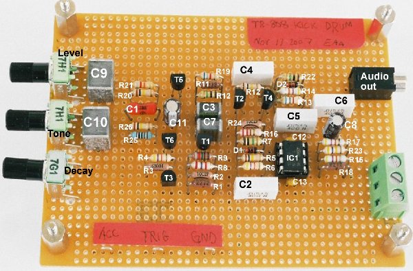

Well, after a long break, I'm back on this one. I finally got it wired up with the accent as suggested, but I'm getting exactly the same results as minus.
I'm now thinking there's maybe a fault in the translation over to stripboard (transistor pinouts, component misplacement etc), failing that, if there's a way to dampen the click noise, some form of resistor/capacitor filter somewhere, perhaps. Any suggestions?

Further use and I no longer think the problem lies in the click being too loud, but more a problem with the sine being too quiet. The click should be there, and seems to cut through the mix as it should, the body (sinewave) of the kick on the other hand doesn't, and is way too low.
I'm now wondering if there's a resistor somewhere on one of the op amps restricting the output of the sine. Looking at the schematic, it appears IC1B takes care of amplifying this part of the circuit, now to find which resistor is restricting the level of the sine..

i've just finished building this circuit and have some results to share, for what they're worth.
i've run the circuit at 9V, 12V, and 15V and can say that the sine/click balance is directly proportional to the source voltage.
at 9V the sound is exactly like the samples posted above where the click was by far the most predominant element.
at 12V the sound is very, very close to authentic.
at 15V the sound is as close to owning an 808 as i'll ever get!

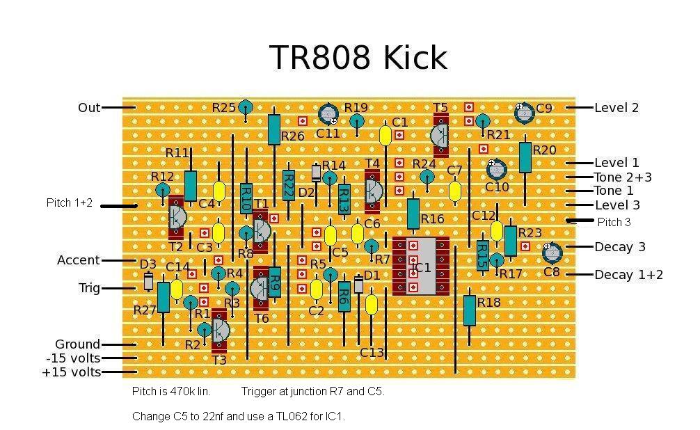

If anyone is still interested, I had a mess arround with the circuit and came up with these mods. They add a pitch control and changing C5 to a 22nf greatly increases the decay. With these mods, I found using a TL062 calmed things down a bit and made it sound spot on.
Pitch pot is 470k. Trigger from junction of R7 and C5.
I am not sure of the 'correctness' of any of these mods but it sounds very much like a TR808 to me!
