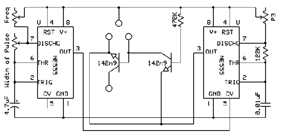

While looking through a box of old files on music, I found my 555 timer circuit from a few decades ago. The actual object can be seen here (well, most of it): http://electro-music.com/forum/post-278450.html&highlight=#278450
So, here's the diagram. I may try to rebuild it to see if it still works as I know some of the wires fell off over the years.

PostPosted: Fri Jan 07, 2011 5:43 pm    Post subject: Reply with quote  Mark this post and the followings unread
I just found another sketch of my ancient 555 timer sound device showing ideas I had for modifying it.

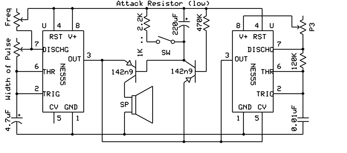

The first thing I did was redraw the schematic so I could
understand a bit better what's actually going on.
Original 555 circuit by Dr. Steve, redrawn by PHOBoS

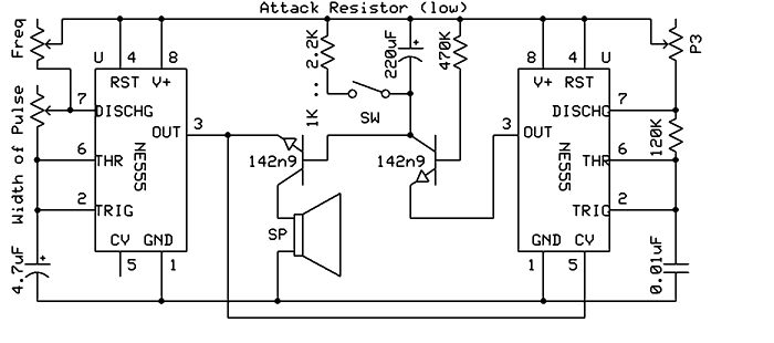

I noticed a couple of things from the original schematic:
pin 8 of the second 555 timer wasn't connected to V+
(I assumed this was just an error in the schematic)
Pin 3 of the first 555 timer goes to pin 5 of the second timer,
which makes sense, but it's also connected to pin 3
of the second 555 timer. Since the outputs of the 555 both
oscillate between V+ and V-, this would short the powerlines.
I know Dr. Steve made this circuit by experimenting, so I decided
to just give it a try anyway. It did do something but the second
555 got very hot. So I decided to change this part in the schematic
to something that seems to make a bit more sense.
I also looked up the 142n9 transistors, and found out they are NPN
instead of PNP so I redraw those aswell.
this resulted in the following schematic:
Dr. Steve's 555 Circuit modified by PHOBoS
 Filesize:  10.08 KB
 Viewed:  678 Time(s)

I noticed that too - about the pin 3 to pin 3 connection... Also, it's not clear to me where power + is connected. Is it on the upper "bus" that connects the pins 8?
I've seen circuits like this before, where outputs are connected together to get a kind of ring modulator sound. But as you point out, with pin 3 of one connected to pin 3 of the other, it's possible for + to connect to - through the output transistors. Some circuits like this have recommendations to use batteries that are partially drained so as not to provide enough current to allow damage to the ICs. A dubious recommendation at best I think. Low voltage can help too. Or one could simply put a resistor between the + rail and pin 8 of each chip to force limiting the current to some acceptable level. This would prevent chip self destruct and/or overheating.
I see that in your second schmatic (PHOBoS) you have eliminated the right 555 pin 3 connection to the other pin 3 - yet in both of Steve's drawings, they are connected together or can be through the switches. This connection would also appear to provide self modulation of the right 555 timer.
It might be interesting to use a high input impedance opamp to get a signal from the timing capacitor(s).

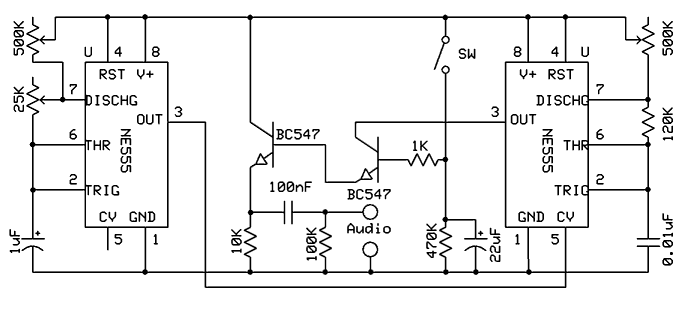

PostPosted: Mon Jan 10, 2011 8:27 am    Post subject: Testing Dr. Steve's 555 Circuit Reply with quote  Mark this post and the followings unread
yes, power + is connected to the topline in the schematic (which is connected to pin 8 )
I see that in your second schmatic (PHOBoS) you have eliminated the right 555 pin 3 connection to the other pin 3 - yet in both of Steve's drawings, they are connected together. This connection would also appear to provide self mutilation of the right 555 timer.
Since the second 555 got hot and it just doesn't make sense to me, I
removed that connection, It didn't really produce any usefull noise in this
configuration .
yes, that will give a nice sawtooth/triangle Smile, I've actually used that with
transistors instead of opamps for fading LED's and producing sounds.
continuing from my previous post
I got some sound of it but only after removing the 220uF Cap,. (maybe
this is because I use BC547 of transistors)
So with the same components I came up with something that does
what I think the original circuit is intended to do. When the switch is closed
the 220uF cap is quickly charged which then (through the transitors) turns
the sound on. when the switch is opened the cap slowly discharges and
the sound slowly fades out again.
I changed the 4.7uF cap to 1uF since I like the sounds it produces at
higher LFO frequencies. I reduced the 220uF cap to 22uf for shorter
decays and I also made a slight change to get a line signal so I can
connect it to an amp.
posted below is the schematic and some sound samples.
(I'm currently using LDR's in series with the frequency pots and let the
setting sun control it. Excerpts will probably be uploaded later)
Dr. Steve's 555 Ciruit Heavily modified by PHOBoS
 Filesize:  10.83 KB
 Viewed:  734 Time(s)

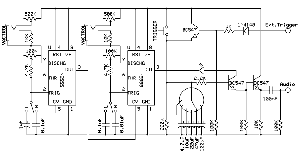

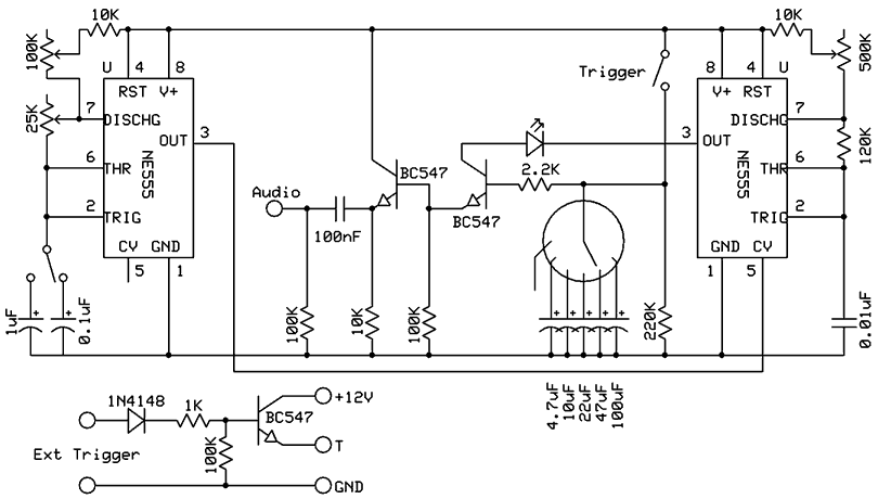

Posts: 5881
PostPosted: Sat Jan 15, 2011 9:54 am    Post subject: Testing Dr. Steve's 555 Circuit
Subject description: CV control
Next test: CV control.
Using a vactrol (LDR-LED combo) in series with the second 555 frequency
pot I was able to use a sequencer to change the frequencies.
I also made some further adjustments to the circuit.
- A couple of different caps to choose a different decay time.
(this was also suggested in Dr. Steve's second schematic).
- An extra cap to choose a higher frequency for the first 555.
- Resistors in series with the frequency pots so I can use the full range.
- A LED and an extra resistor to get rid of the soft noise when the circuit is
not being triggered. (This LED also functions as a very nice indicator)
- A simple trigger circuit connected parallel to the Trigger switch.
(before I just hooked up the Treequencer instead of the switch)
Posted below is the schematic and a recording done by using a sequencer
for both CV control and triggering the circuit. (and delay for the nice phasing)
If you listen closely you might notice that the circuit produces some weird
background noises too.
Dr. Steve's 555 Ciruit Heavily modified by PHOBoS (rev3)
 Filesize:  17.89 KB
 Viewed:  556 Time(s)
Dr Steve's 555 Circuit - Pulsing Vactrol Drone (Jan 13, 2011).mp3
Using a sequencer controlled Vactrol to change the frequency of the second 555.
Circuit is triggered by the CLK of the sequencer
 Filename:  Dr Steve's 555 Circuit - Pulsing Vactrol Drone (Jan 13, 2011).mp3
 Filesize:  5.94 MB
 Downloaded:  1380 Time(s)
JovianPyx
Joined: Nov 20, 2007
Posts: 1988
Audio files: 224
PostPosted: Sat Jan 15, 2011 10:00 am    Post subject: Reply with quote  Mark this post and the followings unread
The LED looks like it's drawn backwards...
Time flies like a banana.
corruptio optimi pessima
Posts: 5881
PostPosted: Sat Jan 15, 2011 10:18 am    Post subject: Testing Dr. Steve's 555 Circuit
Subject description: LED
yes it looks like it. But that's the way it will function. geek
(was actually surprised by that so tried a different LED to make sure)

I figgered that would be the answer, but I had to make sure... very odd... That means the LED conducts only when pin 3 of the right 555 is at ground potential, so the + end of the circuit is somewhere else. I see two candidates, the trigger switch through the 2.2k through the base-collector diode (which might not be a good thing for the transisitor)
OR
possibly from + to the collector of left transistor through it's collector-base diode and then avalanching the emitter base junction of the right transistor (????)... Very odd indeed.
Posts: 5881
PostPosted: Sat Jan 15, 2011 11:41 am    Post subject: Reply with quote  Mark this post and the followings unread
JovianPyx wrote:
..,the trigger switch through the 2.2k through the base-collector diode (which might not be a good thing for the transisitor
I think this could be the right answer. I just took out the left transistor and
100K resistor (so the Emitter of the first transistor is floating) and the LED
responds the same. Don't know if the transistor likes it,. but it works (for now Wink)

The caps on the multi-switch might also be able to supply the + side of the circuit while they are charged. I'd bet the LED might change brightness when the cap value is changed.
Wonderful mental gymnastics, eh? Smile
Posts: 5881
PostPosted: Sat Jan 15, 2011 1:09 pm    Post subject: Reply with quote  Mark this post and the followings unread
well the LED reacts as follows: it flashes with the frequency of the first 555
between bright and dim and fades as the cap discharges (and the sound dies
out). Funny thing if I short the LED the sound barely changes (just doesn't die
out completely) Laughing

Subject description: Rev 4
MusicMan11712 wrote:
Now that I found four more of my ancient 555s and a whole bunch of other parts (including the transistors taken from an old Magnavox Odyssey*), perhaps I can build your version--or something close to it--without taking my museum piece apart!
I'd love to see what you come up with Smile
here are some more small modifications,.
two extra resistors for a better range, an extra cap and pot on the second
555 and the VACTROL inputs. For this I made a Vactroller which converts a
voltage from 0..10V to a resistance from 10K to 500K (I can actually set the
max from roughly 200K to 1M).
I don't know if I'll add more things, though the CV input of the first 555
looks very tempting (I already tried it with a sinewave Cool)
