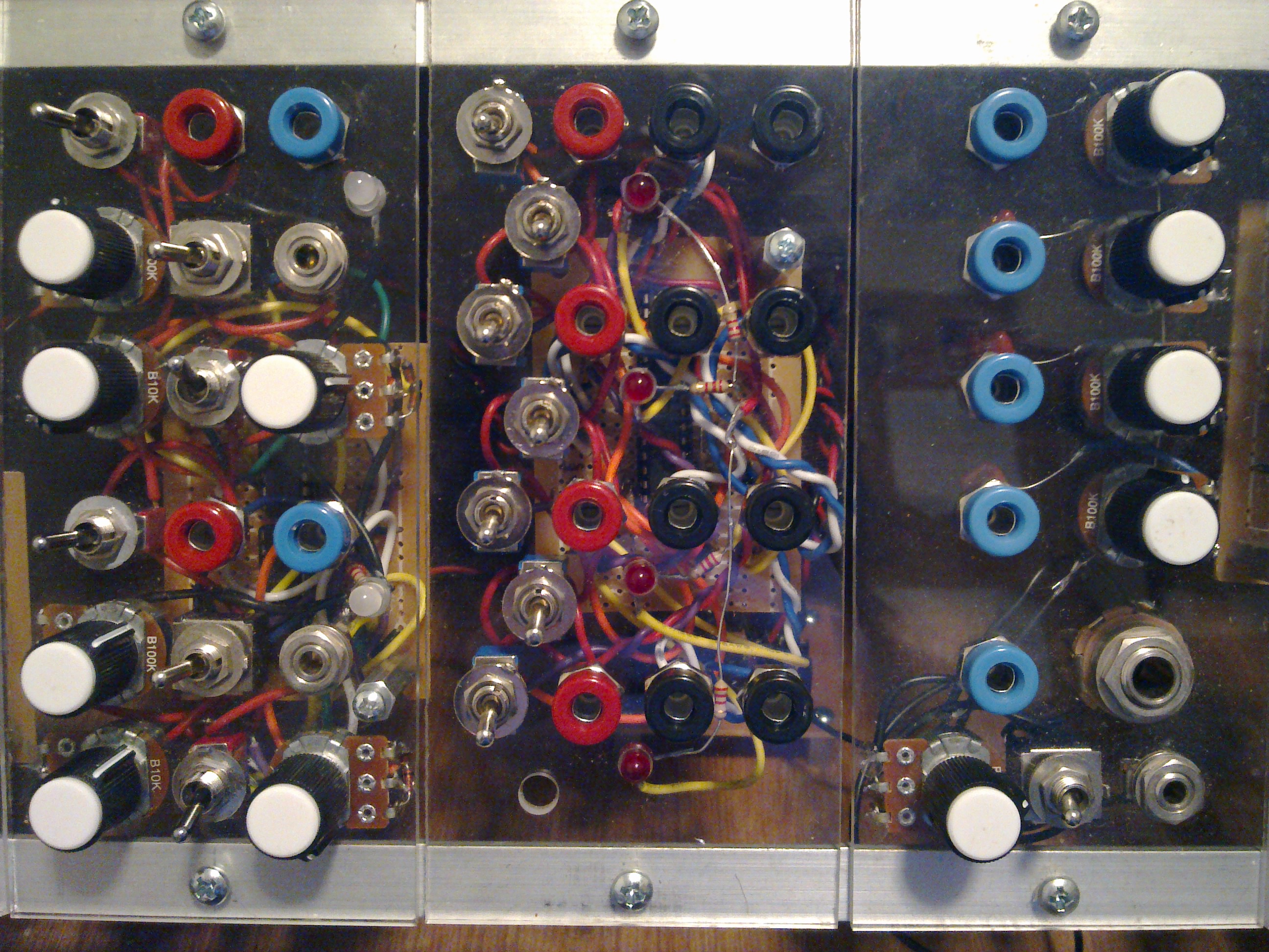

Finally built another module for my system yesterday: its a quad analog switch with a few bells and whistles (center module in the pic).
It's basically a break-out of a 4066 paired with a 40106. The inputs/outputs of the four switches are the black jacks. Each control gate (red jack) is either fed directly to the switch, or is inverted first (via the 40106 chosen by the first column of switches on the left). The three lower control gates can all be chained to the control jack directly above each one (second column of switches), allowing for multiple switches to be controlled by a single input. The LEDs indicate when a gate is triggered.
There are a lot of cool combinations possible when chaining the control gates: if you run a single input into two inputs, make the two switches share the same control signal but invert one, you get a SPDT (a signal router basically). If you double this, you can get a DPDT. There's all sorts of other combos as well. It pairs very nicely with a gate sequencer as well (becomes a sequential switch basically).
There's also an extra hole drilled near the bottom for good measure (honestly... I didn't mess up... really...). Its like eating black-eyed peas for new years... right?
Looking forward to seeing what others build this year; last year's progress was truly amazing! Here's to a new year of building!

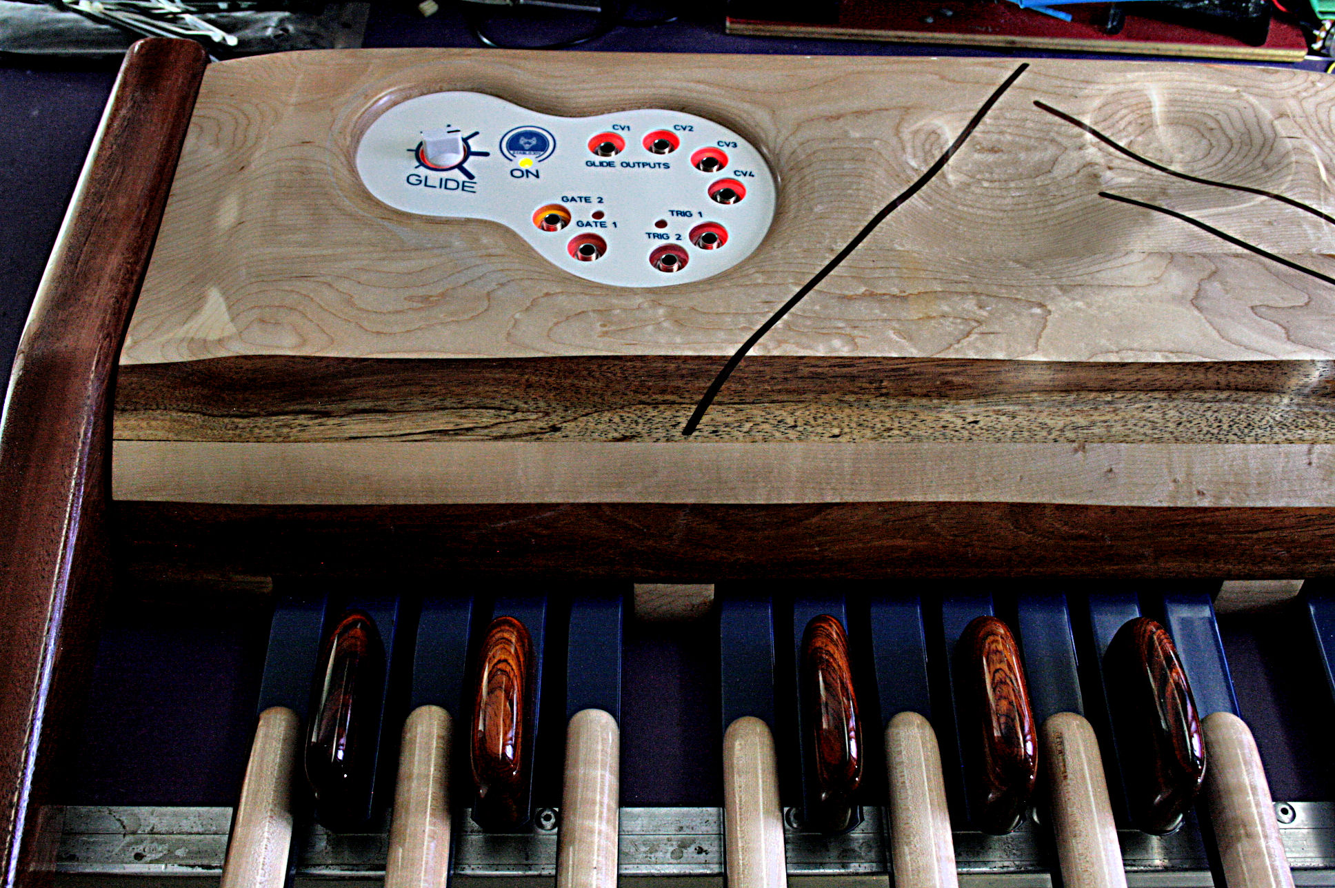

1 octave pedal board
salvaged from a home organ i got for free and then rehoused in some nice timber with a mfos single buss keyboard controller cct
timbers are figured maple , blackwood , jarrah and some cocobolo
finally completely finished something Laughing took a while

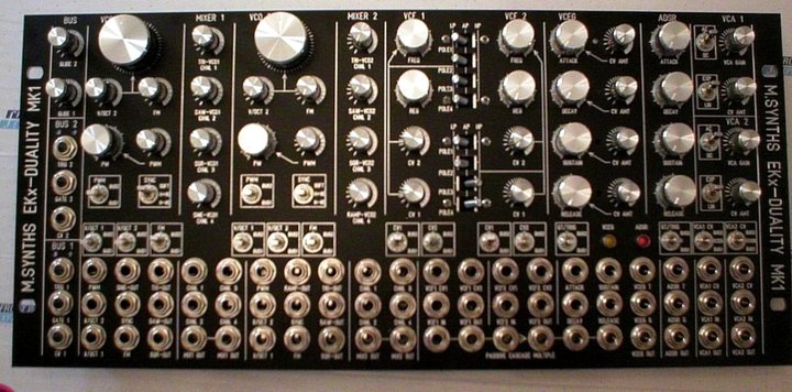

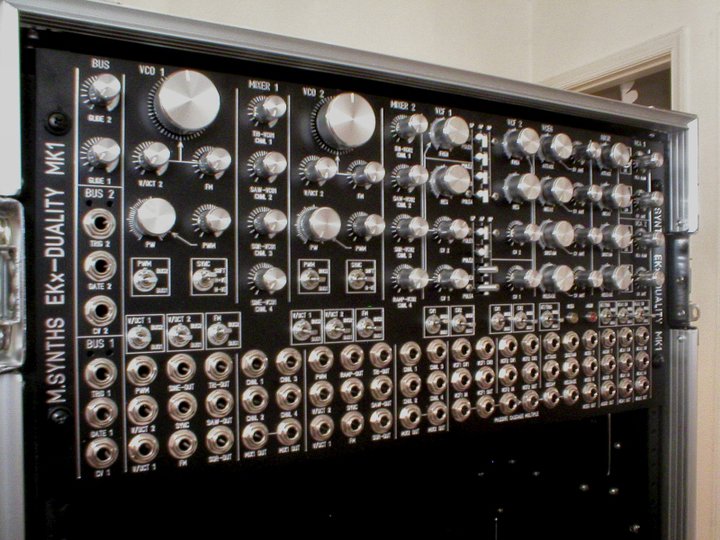

Here's what I've finished during the last year before I had to break my DIY for we're havin' a baby next month...
Most circuits are taken from Ray Wilsons WP20 Synth. Smile The VCO and the WP-20 VCF are build on stripboard. The second VCF is an EFM Korg Delta Style VCF. All modules are working fine. The case isn't pretty, but it will get a better case later on.

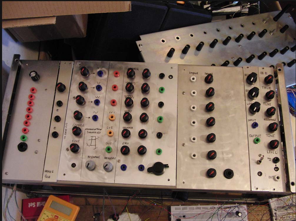

Mostly finished, modules are (left to right)
Mfos multi noise /random gate generator
mfos single chip sample and hold
thomas henry icl8038 vco
steiner synthacon filter (from the japanese guys pcb layout)
ken stones cynare cgs 47
mfos ultra simple mono mixer
belcat delay pedal (mounted onto a panel)
hip bass drum (from this forum.... sounds EXCELLENT)
still have psu to build and a little tweaking on some modules but overall its a nice rack to play with (if you'll excuse the innuendo)

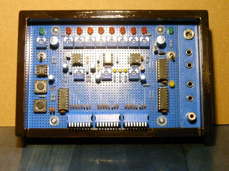

I wanted to make a simple analog sequencer for testing purposes, but as
usual I couldn't stop myself from adding a couple more things.
It has a (binary) pattern generator, a sort of glide control, a VCO
and a filter. The buttons on the left are for step control and reset, the
connectors on the right are from top to bottom:
12V DC in, ext. CLK in, int. CLK out, CV out (sequencer), CV in (VCO),
Audio Out (VCO)
Build on blue perf as a tribute to Dave's amazing blue modular bigsmurf

very cool sequencer! what are the DIP switches for? and could you explain the binary pattern generator a little bit? thanks!
Posts: 5980
PostPosted: Mon Jan 17, 2011 8:52 am    Post subject: Smurf Sequencer
Subject description: pattern generator
The DIP switches are there to set the patterns which works as follows:
The CLK signal goes to a binary puls divider (4040). 8 outputs of this divider
are connected to the DIP switches via diodes so switch 1 on DIP A,B,C has
CLk /2 connected, switch 2 of DIP A,B,C has CLk /4 connected and so on.
The other sides of the switches are shorted together (per DIP) and connected
to inputs A,B,C of an analog multiplexer (4051). The binary code on these
inputs selects which analog input is connected to the output. These inputs are
connected to the pots to set the voltage, output is connected to an opamp
that is configured as a voltage follower. hope that clears it up a bit Smile

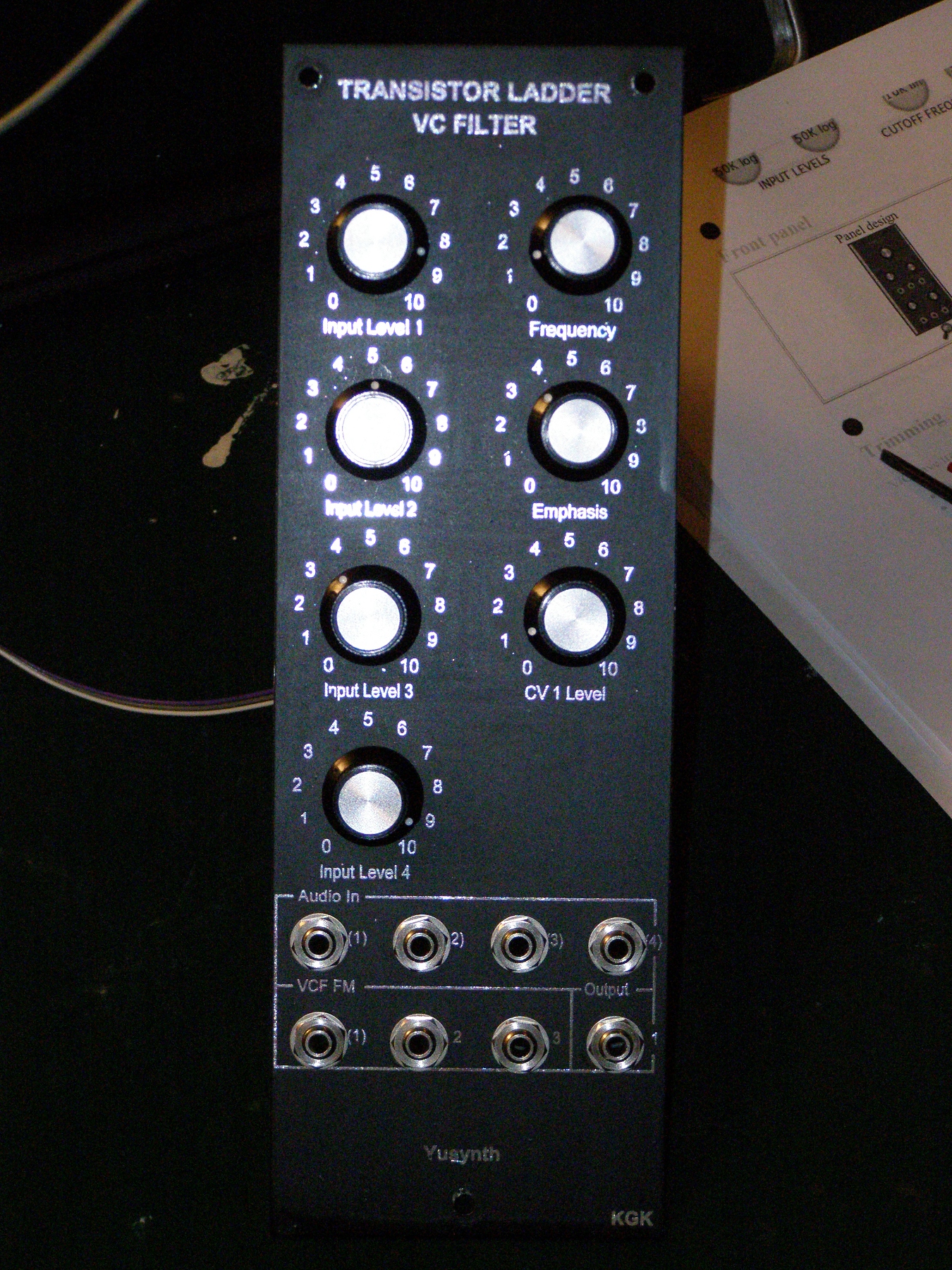

PostPosted: Tue Jan 18, 2011 9:43 pm    Post subject: Just finished a Yusynth Transistor Ladder filter
Subject description: a Minimoog filter clone
This module came to life and required no troubleshooting (**hurray!!**). I just calibrated it and that was that.
As all the other Yusynth filters that I've built, the Transistor Ladder filter is clean and musical.
Yves designed the filter to be a minimoog filter clone and its rolloff -- 24db/8ve -- is noticeably more pronounced than my Aries Multimode filters (which are 12db/8ve).
The front panel. The Yusynth design call for two inputs and I went ahead and added two additional inputs.
