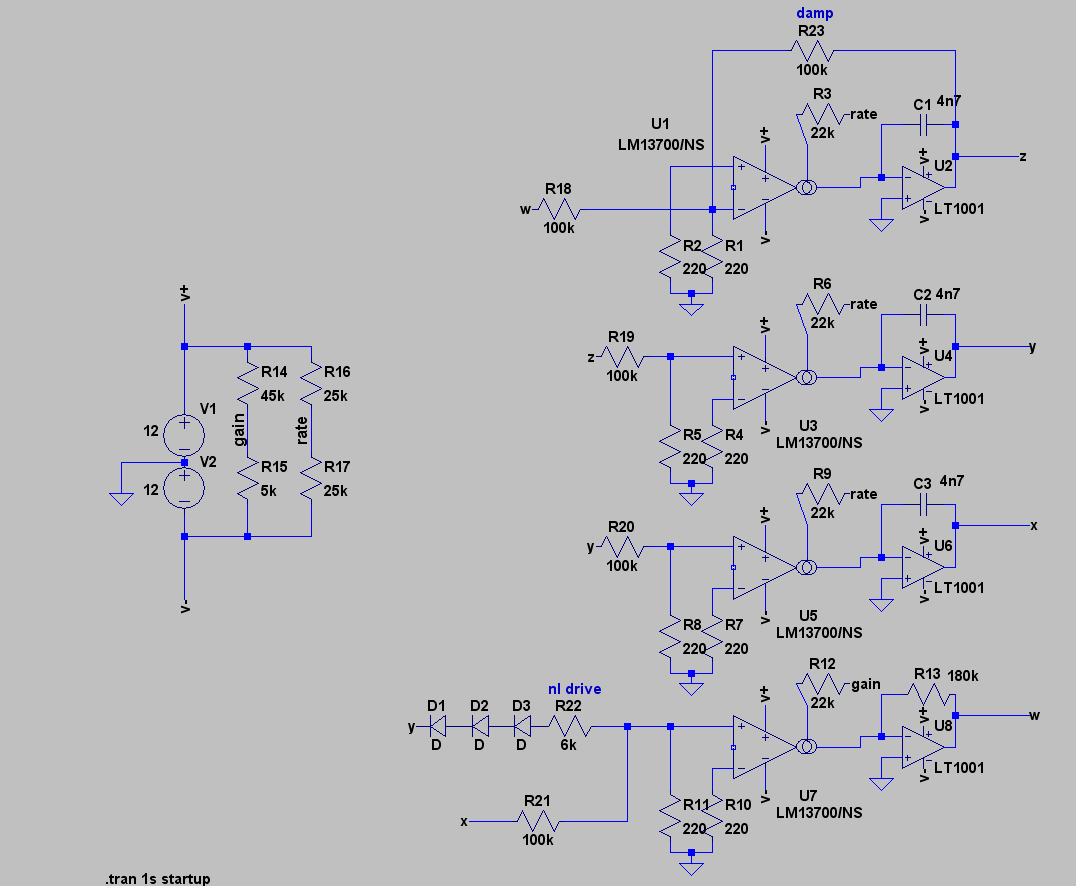

hi - thought i'd resurrect this thread instead of making a new one since my query is pretty closely related.
i'm working on a new circuit that will probably end up using LM13700s, so i've imported the model into LTSpice as detailed above. to test it out i built simulations of a couple of circuits from the LM13700 datasheet (unity gain follower and voltage-controlled low pass filter) which both seemed to work ok.
i've run into a brick wall using the simulated LM13700 as a voltage-controlled integrator though. my circuit works fine with basic RC opamp integrators, but when i substitute LM13700 VC integrators, the outputs run into the rails almost straight away, and stay there.
since Ian Fritz's Jerkster uses the chip in the same way as i'm trying to, i thought i'd build it in LTSpice and see what happens; again, the output runs into the rails. i have a Jerkster in my modular so I know it works in real life; i don't really understand why the simulation fails?
can anyone spot any stupid errors i may have made in the attached screenshot? or alternatively: can anyone educate me about possible inaccuracies in the Spice model which might cause this kind of problem? i don't think it's a chaos thing, as i've got Chua's oscillator etc. working in LTSpice.
if no one can think of anything i'll probably just continue development on breadboard, but it would be really good to shed somelight on this. can provide more info if it will help.
thanks for reading!
