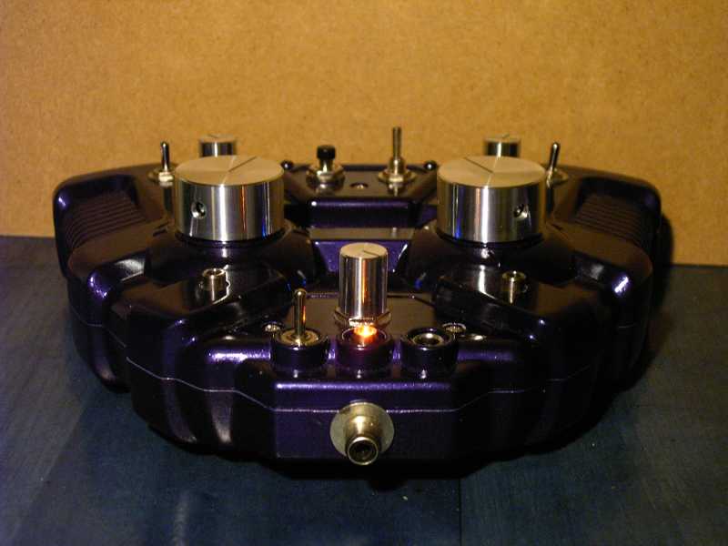

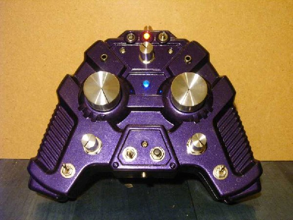

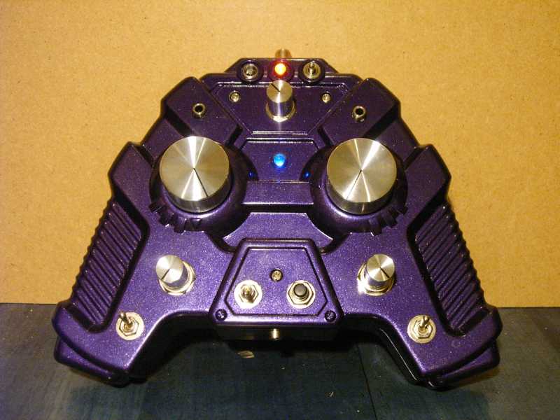

PostPosted: Wed Mar 09, 2011 12:00 pm    Post subject: Purle Star 555
Subject description: Dr Steve's 555 Circuit modded by PHOBoS
I finally got the last parts to finish this thing, the knobs!
It's a noise/sound generator with 2 NE555 chips, original design by
Dr. Steve with some modifications by me. Cool
more info and audio here
more photos here
 Filesize:  46.81 KB
 Viewed:  518 Time(s)
 Filesize:  31.61 KB
 Viewed:  519 Time(s)

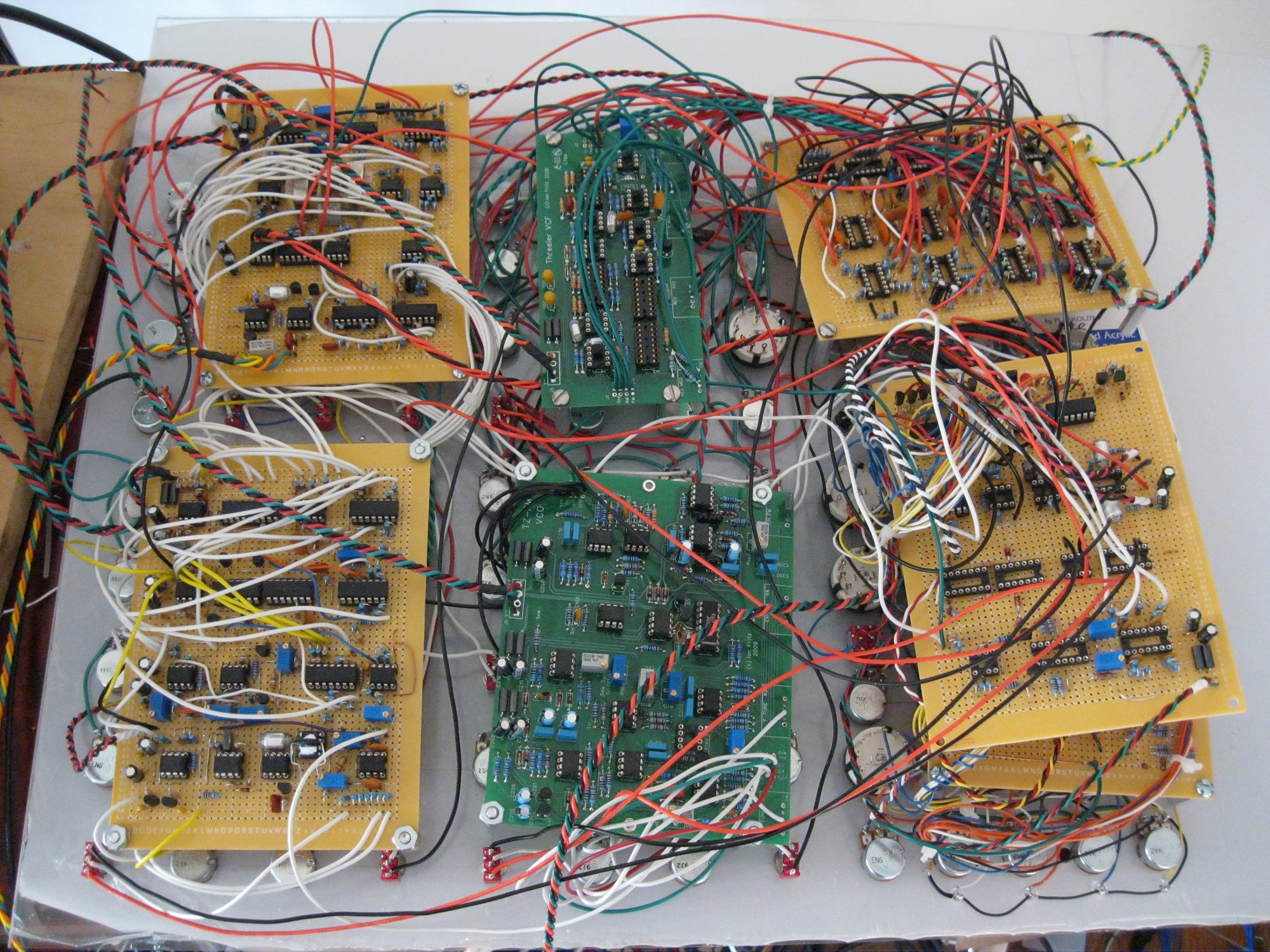

PostPosted: Thu Mar 17, 2011 6:07 am    Post subject: Reply with quote  Mark this post and the followings unread

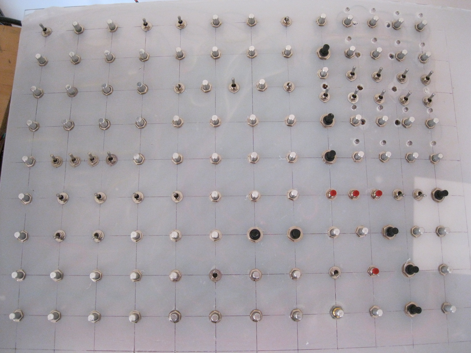

Not quite "finished" finished, but i reached a milestone on a pre-patched synth i am working on, panel wiring is finished as of last night! All that is left is to chase any remaining gremlins out (shouldn't be too bad, most everything is tested and calibrated), make a proper panel and box it up.
Contains one Ian Fritz saw core VCO as described in an EM thread, with standard tri, sine and pulse shapers, plus a Fritz 5 pulser and two Scott Stites "wave things". Your basic three octave 11 waveform VCO Smile
One Ian Fritz Teezer through zero VCO, holey moley is that thing amazing.
Four Thomas Henry VCAs.
One Ian Fritz Threeler multi mode VCF.
One transformer/diode ring modulator, Ken Stone style.
Four simple LFOs, one Tom Wiltshire/Electric Druid tap LFO.
Three Tom Wiltshire ADSRs.
Two 4017 sequencers, one 4013 divide by 2 and one 4017 divide by 1-8. Sequencers can be mixed together with one running off a divided clock (divided by 1-16) or run independently.
The sequencer clock is a falling ramp/comparator set up with VC gate width, thanks for the great idea Fonik!
Two Boogdish pic quantizers.
Two simple glide circuits, portamento can be applied before or after quantization.
A single buss 1v/oct keyboard controller.
Circuits are from Ian Fritz, Thomas Henry, Scott Stites, Ken Stone, Tom Wiltshire, Ray Wilson, Michael Barton and Bernie Hutchins/electronotes contributers, thanks guys, i promise to have way too much fun Smile
 Filesize:  1.37 MB
 Viewed:  369 Time(s)
 Filesize:  940.96 KB
 Viewed:  360 Time(s)

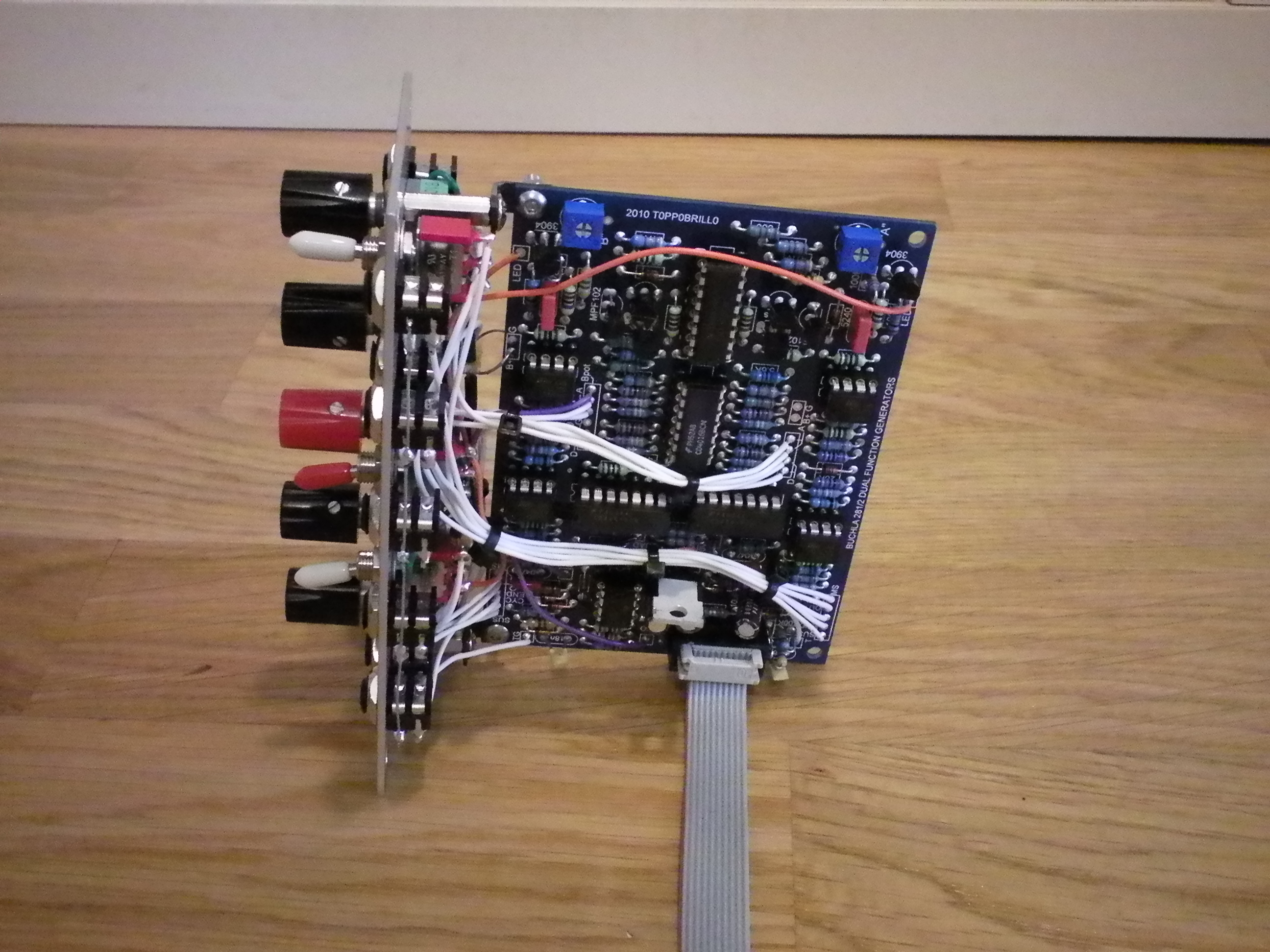

PostPosted: Thu Mar 17, 2011 11:29 am    Post subject: Reply with quote  Mark this post and the followings unread

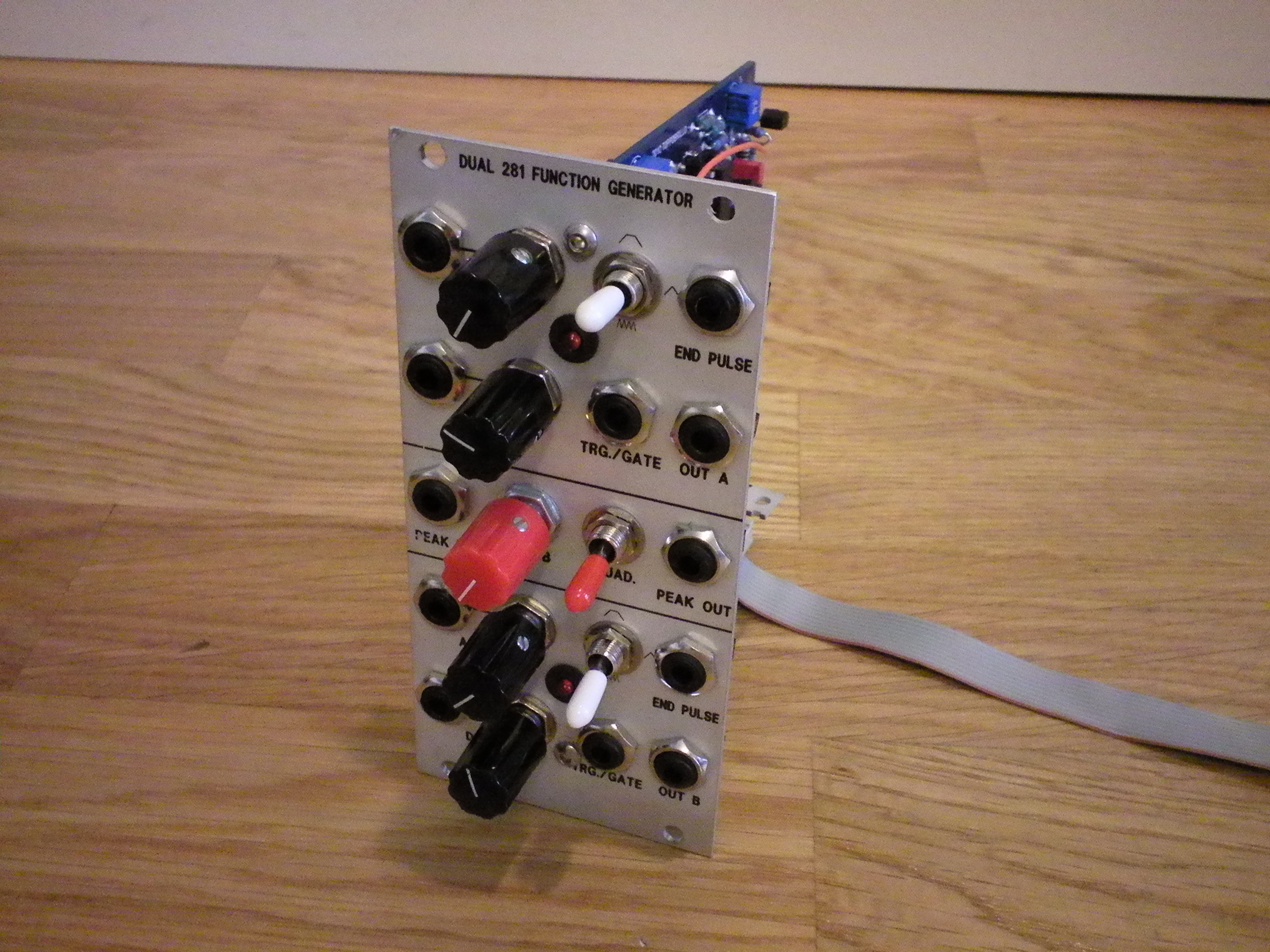

Hi, I completed this morning the troubleshooting of my Toppobrillo Dual 281 FG module. The problem was caused by mounting the lm7810 backwards. I think it caused the failure of 1 cd4001 (the one for section A, section B worked from the very beginning). I like troubleshooting! Especially when it makes something work! Very Happy
 Filesize:  1.45 MB
 Viewed:  379 Time(s)
 Filesize:  1.47 MB
 Viewed:  378 Time(s)

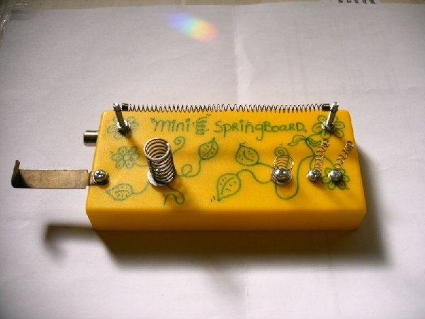

Here's a mini springboard I made last night for todays Spring Equinox,
it has been used in the midichat Smile
mini springboard made for Spring Equinox 2011

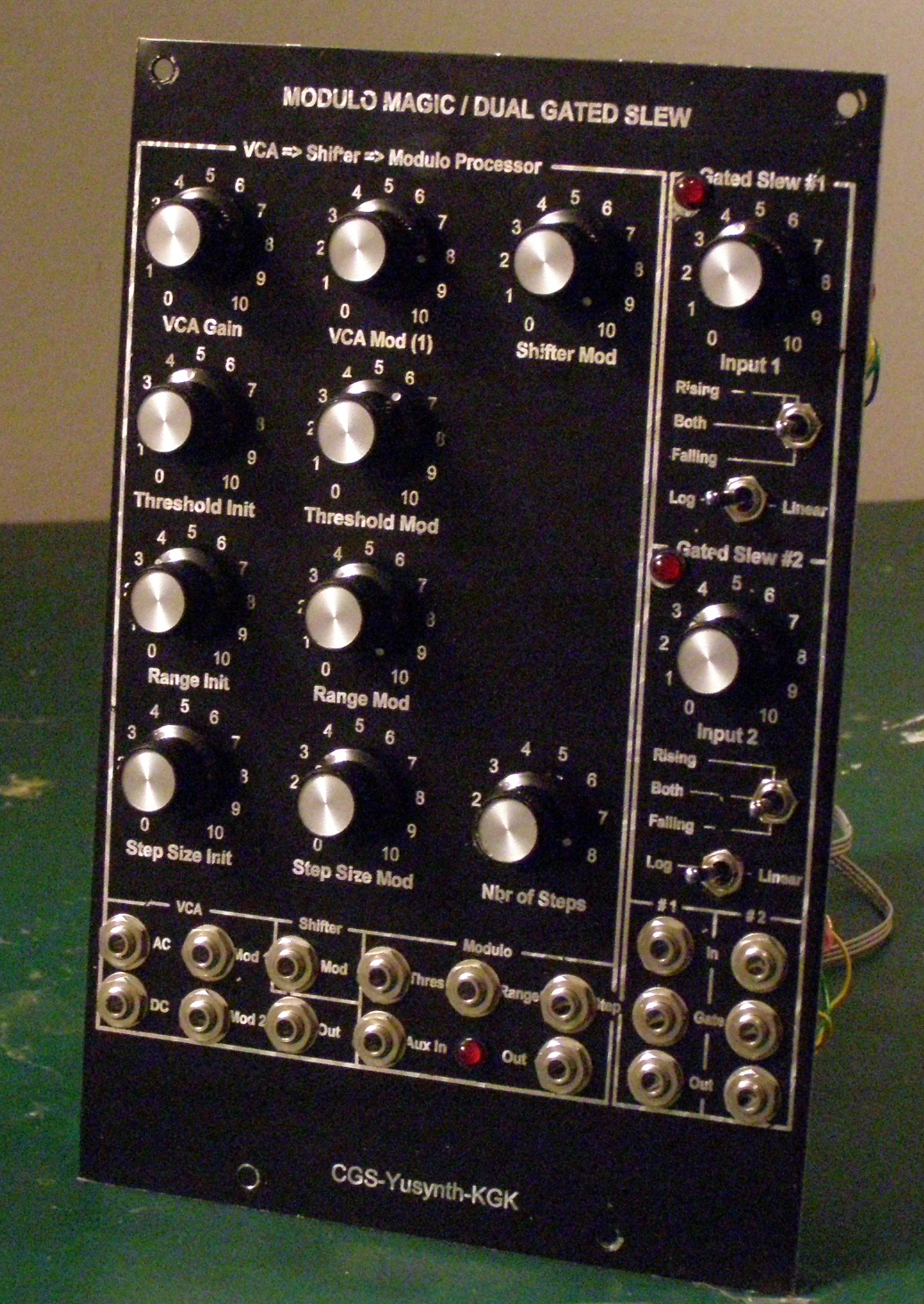

PostPosted: Thu Mar 31, 2011 9:30 pm    Post subject: A redesign and new functions for a double-width module Reply with quote  Mark this post and the followings unread

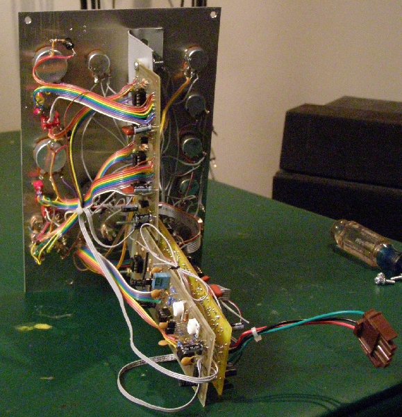

While I liked my Modulo Magic module, I was never satisfied with my initial panel layout -- it was overly cluttered with inputs and controls that proved to be redundant.
Through experimentation I discovered that to add a VCA input section and a bias shifter increases the Modulo Magic's capabilities.
The VCA accepts both a/c and d/c inputs and can be used stand-alone. It sends it's output to a self-designed bias shifter circuit that I defaulted to a +5v bias -- the bias level can be shifted by an external voltage.
The modulo magic accepts that shifted signal as well as an auxiliary signal. I renamed the functions to: Threshold, Range, and Step Size -- these all can be voltage controlled.
I originally built Modulo Magic as a control voltage processor however I really like it as an audio signal processor. Thus, I optimized the front panel control ranges and the functions for audio (though it works fine as a control voltage processor, too).
This redesign required 1 1/2 module spaces so I added a Yusynth Dual Gated Slew which takes up the other 1/2 module space.
The redesigned and expanded panel.
 Filesize:  915.63 KB
 Viewed:  332 Time(s)
View of the PCBs. The three PCBs are the CGS Modulo Magic, a board that contains the Yusynth VCA and my own bias shifter, and the Yusynth Dual Gated Slew PCB.
