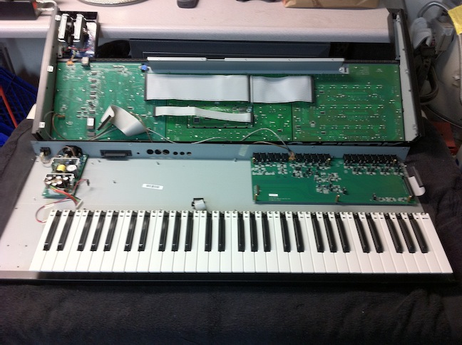

Just wanted to update here,
I did not receive a response for David Bryce. I could not find any information on the bootloader, not even from Alesis.
I contacted the shops provided by alesis and a few others about a repair that included some level of troubleshooting to identify the actual problem and which specific board, but no luck. They all simply just replace the Main board and 'see' what happens.
I therefore purchased a main board from Alesis, which was easy enough. The price was 600 bucks, and it arrived in 2 days. Surprising was the fact that it was clearly a used board. Dirty and marked up in various ways. The board that was in my used A6 was super clean by comparison. The pins of the board from Alesis were also in bad shape, so a little prep work was needed.
Once installed the A6 booted as expected and seems to be working well now. Need more time to complete loading patches and tuning and all that. I will update when I have logged some time on it.

Here are some photos of the A6

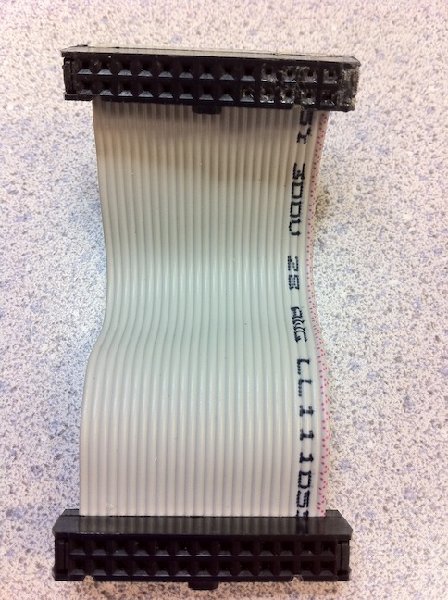

This is one of the ribbon cables from the main board to the ASICs controller board. As you can see somebody glued inside of the connector. This wasn't possible to get completely clean I made and then replaced the cable. Most of these cables were not available in their sizes, but you can buy the ribbon and the connectors and crimp your own cable. You can also test it to make sure it works the cheapo way, by using two needles, inserted into the holes and a regular ohm meter for continuity.
[IMG]https://files.me.com/fireroasted/8w7q0j[/IMG]

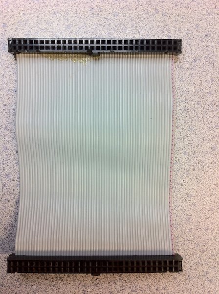

This was the other cable that went from the Main board to the Main ASICs board. It also had a lot of glue debri, but I tried cleaning it first. You can see the residue of where it was in the plug on the cable still.
[IMG]https://files.me.com/fireroasted/ght5xc[/IMG]

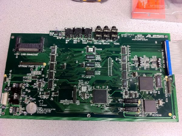

Here is a rather large photo of the Main Board. I left it a bit bigger so you could better see the individual components.
[IMG]https://files.me.com/fireroasted/ebfv82[/IMG]

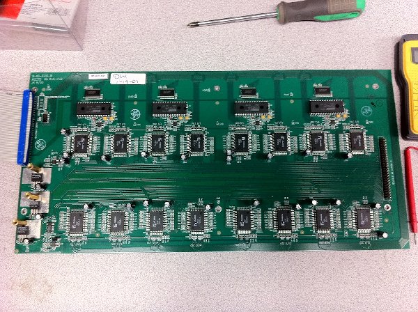

This is the ASIC PCB with all the analog chips. It was the connection between these two boards that I suspected was causing my issue.
[IMG]https://files.me.com/fireroasted/gdt0j8[/IMG]

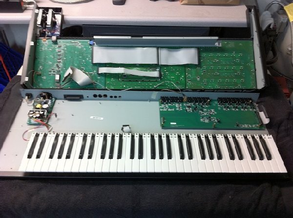

This is the A6 with the above two boards removed. Its a bit blurry, but you can see that even now there are 4 specific PCB boards still in the unit, and the powersupply board. So include the two missing that would make 7. Its a very neatly laid out unit compared to other older synths, and very easy to work on/in.
[IMG]https://files.me.com/fireroasted/huza9a[/IMG]

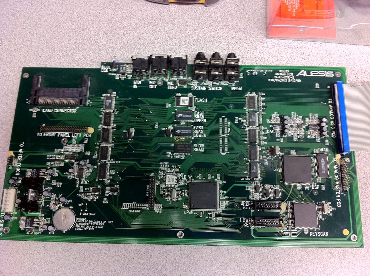

This last one is of the ASIC controller board that reside underneath the ASIC main board. This one provides all the outputs. [IMG]https://files.me.com/fireroasted/nmesjy[/IMG]
