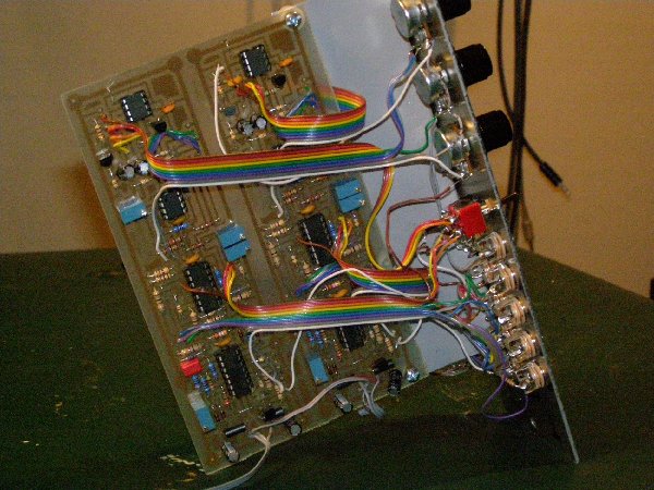

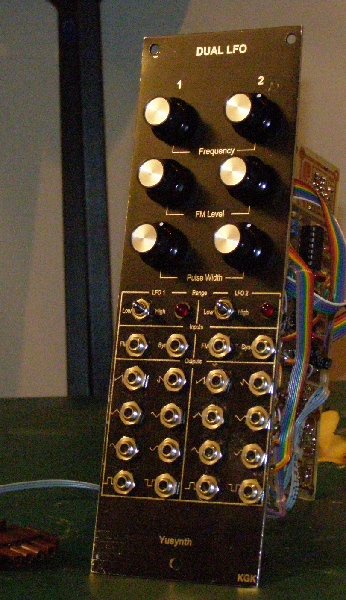

Posted: Fri Apr 22, 2011 10:14 pm Post subject:
New Yusynth LFOs in a Dual configuration |
The Yusynth LFO has so many on-board features that Yves proposes two configurations. Both feature voltage-controlled FM and four (sawtooth, triangle, sine, pulse) outputs. Option one adds a rotary switch that selects one of the output waveforms and routes it to an inverter. Option two adds a panel-mounted Pulse Width control and a sync input.
Since all these are useful functions, I decided to design a configuration that allows all of the features. I discovered that there was not room for both a Pulse Width pot and the Rotary switch.
My solution was to build option two and to add a hex inverter board, route all the waveforms through inverters, and bring them out to output jacks. Thus, each LFO has eight outputs. In other words, there was room for additional output jacks but not room for another knob.
I look forward to putting this module to use!
| Description: |
| The front panel. A redo (strip and relable) is on my do-list now -- I managed to scuff it a bit. A DIYr's work is never done! |

| Description: |
| The PCB with the two LFO circuits. |

| kkissinger wrote: | | The Yusynth LFO has so many on-board features that Yves proposes two configurations...Since all these are useful functions, I decided to design a configuration that allows all of the features. |
Excellent. I've looked at that one and thought the same thing.
But I haven't gone crazy and started etching my own PCBs yet, and this one's not available commercially.
I think I'd add the PWM jacks and reduce the outputs to one per waveform...then use a DP4T switch to select the Inverted/Non-inverted output, like this:
POS LFO1 LFO2
1 + +
2 - +
3 + -
4 - -
Not as flexible as a + and - output for each waveform, but more panel friendly. I'm not sure how many times I'd want both the + and - from one LFO at the same time, though I suppose there would be times...hmm.... _________________ Looking for a certain ratio since 1978 |

| emdot_ambient wrote: | | I think I'd add the PWM jacks... |
Note that the module doesn't have an out-of-the-box PWM voltage input and that it pads the input to U2c down to (approximately) -6.5 to +6.5v (I haven't measured the value so I'm making a guestimate here).
You could substitue a Jack for the pot however you'd need to pad the voltage so as not to exceed the maximums.
I'd probably just grab a TL072 and build an inverting summer followed by an inverter -- thus, I'd be able to mix the voltages from the pot and a jack while adjusting the feedback resistor(s) for an appropriate gain.
Of course, there would be the temptation to add an attenuator pot for the PWM input voltage and then there would be a ton of knobs!
I actually pondered this a decided that such an application (to use a voltage-controlled duty-cycle) is so rare that I'd just use one of my VCO's in the sub-audio range to do this.
| emdot_ambient wrote: | I haven't gone crazy and started etching my own PCBs yet, and this one's not available commercially.  |
LOL -- I etch my own because I find it easier than to wire up components on pegboard! You sound like a future-PCB-etcher. And, hey -- you are doing sDIY -- the crazy train has already left the station!
| emdot_ambient wrote: | | I'm not sure how many times I'd want both the + and - from one LFO at the same time, though I suppose there would be times...hmm.... |
One thing I'm interested in is to route the pulse output and the inverted output to two VCO's. As I vary the Pulse Width, I should get an effect where the top (and bottom) pitches bounce between the VCOs. Will be handy for VCA cross-fading (using slews) and switching.
Sometimes I add modules/features with very specific applications in mind, other times I add stuff when I have the panel space. Sometimes, the things that I "just add for the heck of it" turn out to be very useful. _________________ -- Kevin
http://kevinkissinger.com |

| kkissinger wrote: | ...You sound like a future-PCB-etcher. And, hey -- you are doing sDIY -- the crazy train has already left the station!  |
**shakes fist** Curse you!...but you may be right. That'll have to wait, though, I've got such a huge lot of work to do on my current DIY. Following a pretty definite plan with the goal of getting up and running for live shows.
| kkissinger wrote: | ... | emdot_ambient wrote: | | I'm not sure how many times I'd want both the + and - from one LFO at the same time, though I suppose there would be times...hmm.... |
One thing I'm interested in is to route the pulse output and the inverted output to two VCO's. As I vary the Pulse Width, I should get an effect where the top (and bottom) pitches bounce between the VCOs. Will be handy for VCA cross-fading (using slews) and switching. |
Yeah, the more I thought about it the more I could see it being desireable and often used. Of course if you've got inverters elsewhere in your system (or better yet, a couple attenuverter mixers) you can use them. Double the jacks is a pretty heavy panel space price to pay for a double LFO module...still, sweet module! _________________ Looking for a certain ratio since 1978 |
