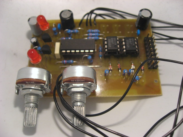

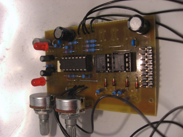

PostPosted: Sun Mar 27, 2011 2:54 pm    Post subject: Reply with quote  Mark this post and the followings unread
pcb proto (almost) done!
probably made multiple errors against pcb design protocol, but this is a personal landmark anyways. my first design from scratch! yay! Wink
leds are still board mounted for testing purposes.
the wires are for the two inverter switches.
used doepfer/eurorack standard for power supply hookup.
still missing are the zeners + stabilizing caps (will go next to opamps), and the range switch and output wires.
oh, and i implemented two pads for later CV speed control as per MFOS..
as it is, it seems to work. that is: leds + scope view.. haven't hooked any synths up yet for lack of zeners and time.
(hmm, maybe i should just run the thing off two 9v batteries to run some tests. tomorrow maybe)
so far, me happy Very Happy
 Filesize:  94.84 KB
 Viewed:  314 Time(s)
 Filesize:  95.3 KB
 Viewed:  334 Time(s)

PostPosted: Wed Mar 30, 2011 9:51 am    Post subject: Reply with quote  Mark this post and the followings unread
finished prototype.
one thing that didn't work were the zener stabilizing caps - the mushed up my square wave, at high speeds it would turn triangle and at even higher speeds the whole thing would weezle out into a flatline.
so i removed them all, now i got crisp clean squares firing off the doepfer!
still need to order me a bunch of minijacks, as you can see.
all in all, the thing works.
will upload final schem asap.
feel free to make your own PCB design - not really happy with how mine turned out (next time i'm board mounting switches as well - wiring was a PITA.)
unless someone really wants it, that is.
 Filesize:  3.79 MB
 Viewed:  366 Time(s)

on the scope everything looked perfect without the caps, so i would just go with that.
do you know what kind of trigger the S/H requires?
vladosh
Joined: Aug 02, 2010
Posts: 679
Location: macedonia
Audio files: 51
PostPosted: Wed Apr 06, 2011 12:16 pm    Post subject: Reply with quote  Mark this post and the followings unread
thanks for the reply ..
i removed the caps and it's working as it was .. i think it's the s/h that wouldn't trigger with this it's not the clock .. as the s/h is working good with the lfo's i guess it need the negative portion of the signal somewhat .. it's a very simple s/h made of only one cmos chip from Osamu Hoshuyama design ,anyway i needed a clock for the sequencer i'm building at the moment so will see how that goes .. it's that patern generator from bug brand maybe you know it .. and thanks for the advice for the caps .. i hope it would trigger the pattern gen
greetings
vlad
remork
Joined: Aug 02, 2009
Posts: 25
Location: bhellgium
PostPosted: Thu Apr 07, 2011 1:57 am    Post subject: Reply with quote  Mark this post and the followings unread
is that the one based around the 4052 chip?
that should work, i have a 4052 running the sequencer in the Hohner.
i don't know what voltage you are running the Bugbrand on?
vladosh
Posts: 679
Location: macedonia
Audio files: 51
PostPosted: Thu Apr 07, 2011 3:06 am    Post subject: Reply with quote  Mark this post and the followings unread
yes .. that's the one .. i'm making it a dual but still need to get outs and ins so it'll take me a while i guess .. seemed like a good project for a first seq low parts count .. it will be running on +12 v -12 v .. and the cmos on 12 and ground .. actually my PSU is a bit in lower range it's 11.3 v .. but so far it's working with these few modules ..
remork
Posts: 25
Location: bhellgium
PostPosted: Thu Apr 07, 2011 5:07 am    Post subject: Reply with quote  Mark this post and the followings unread
ok, i don't think it should be a problem.
if i interpret datasheet correctly, the 4052 triggers:
Lo below 4.50v, Hi above 5.50v at 10v supply. (=1v hysteresis around Vdd/2).
marginally higher for 11.3v.. so 0-8v should still work fine.
if the 4052 doesn't trigger (which i don't expect), then it's possible the trigger voltage was dropped too much - i just aimed for 8v, since that seemed a middle-of-the-road kinda voltage.
assuming you have the clock running on the same supply, you could then try losing the zeners altogether. or having the opamps amplify, but that seems overkill.
i thought the bugbrand one was designed for 2 or more different clock signals though?
vladosh
Posts: 679
Location: macedonia
Audio files: 51
PostPosted: Thu Apr 07, 2011 1:50 pm    Post subject: Reply with quote  Mark this post and the followings unread
thank you for the insight ... the last time i measured the voltage on the clock outs it was around 7-8 v something like that .. i was thinking on clocking the bugbrand gen with lfo's too as it has protection diodes so i thought it wouldn't be a problem and maybe making that pulse delay from yusynth .. as we're on the subject if you don't mind me asking .. can i use the same method that bugbrand used in his pattern gen for the other modules he did like this one http://www.bugbrand.co.uk/bugbrand_old/images/cmos/Schematics/4089_RateMultiplier.jpg my plan was to add protection diodes and a op amp as a buffer output just so i can use it with lfo's and make it suitable for the rest of the modular ?
thanks
vlad
remork
Posts: 25
Location: bhellgium
PostPosted: Fri Apr 08, 2011 2:05 am    Post subject: Reply with quote  Mark this post and the followings unread
yup, running LFO's through the diodes should work.
when all your 4000-family ic's are powered with the same voltage, i don't think you can do anything wrong - they were meant to be chained together. diodes won't hurt if you're mixing signals though.
might wanna check the datasheets just to be sure (that's a disclaimer right there..)
the buffered output might not be necessary. depends on what you plan to hook up after your circuit. if you plan to drive a lot of other inputs, your logic IC might not cut it - so buffering (+series diode against negative spikes) is always the safer option.
by the way, i'm not sure if all of those IC's you want to use have hysteresis on their inputs.. it could cause some erratic up-and-downing when your lfo sits around half the supply voltage, especially with slow tri/saw/ramp waves, where the input doesn't know if it's being pulled hi or low.
if you don't mind, fine. if it bothers you, easiest is probably a 4050 buffer or some added Schmitt Triggers.
