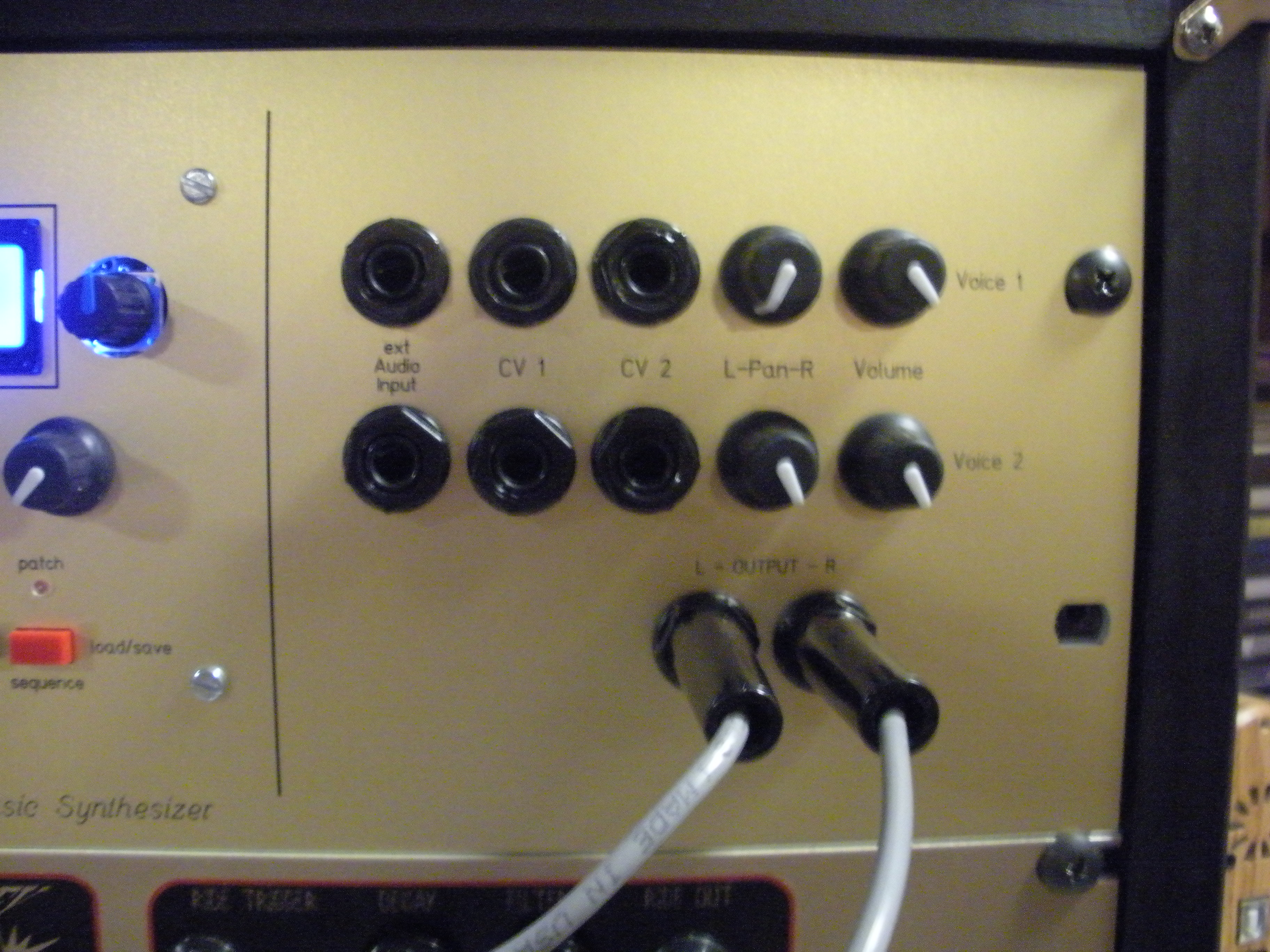

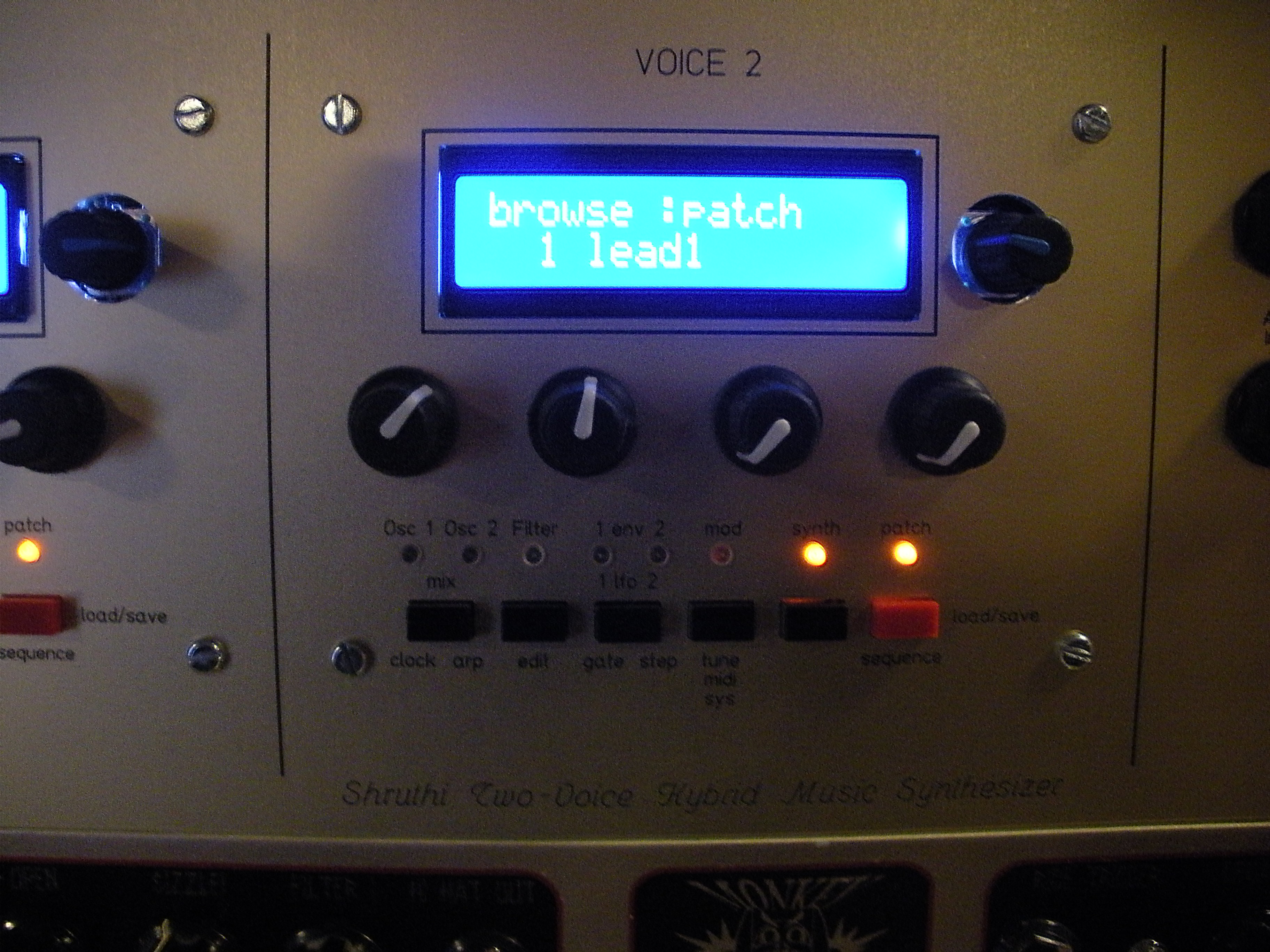

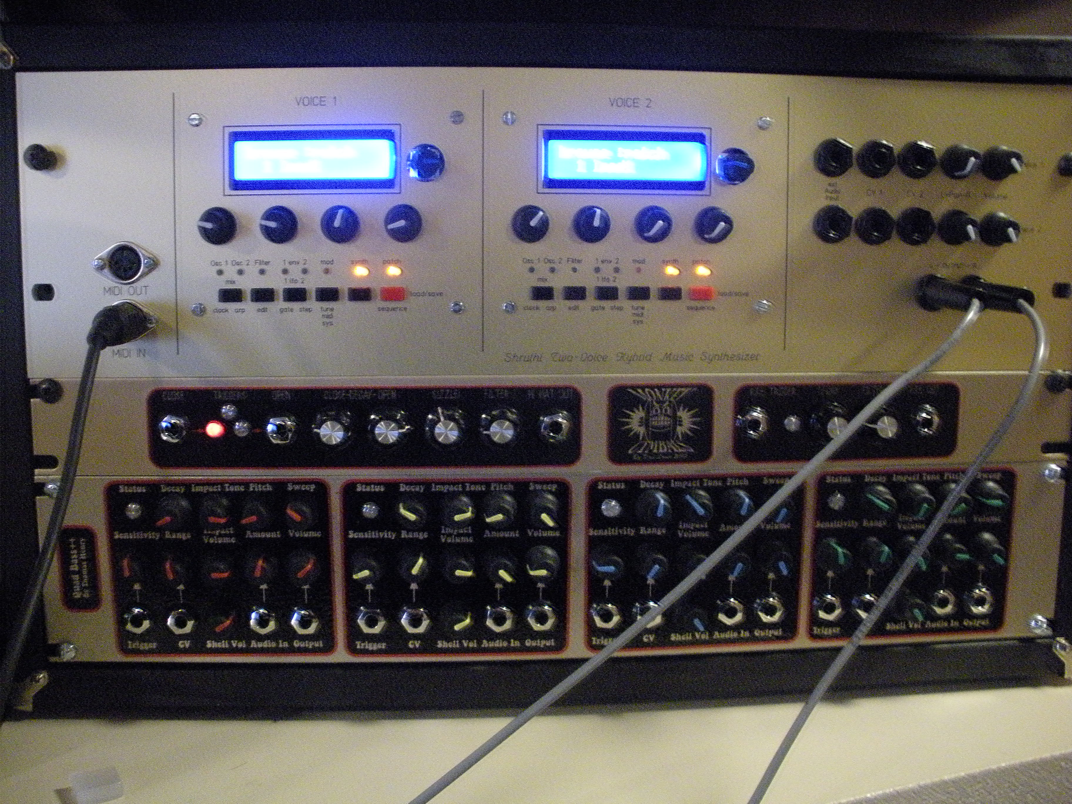

Looks good. I decided to work with the Shruthi myself and as a result, I abandoned my planned OB two-Voice for a Shruthi two-voice. The 2 units mix together with a simple mixer/panner circuit that was found on a MFOS tech page. The CV1 and CV2 jacks arent currently hooked up yet. Id like to make a little buffer board for them.
System-wise, I have the units hooked up as a two voice polysynth. Although it is primarily for lead lines, I like to plop down a second note every now and then for harmony. The units can be configured as two separate mono voices if I want too. I really like how the Shruthi system is organized.
I have the stock 24dB low pass filter. I decided not to use the 12dB option on the filter. With all the filter options, Iḿ surprised no one has done a transistor ladder yet.
I went with Front Panel designer for the panel because of the square holes. Iḿ not good enough on the mill machine to do this kind of work, yet. Bill/State Machine inspired me to use the gold finish instead of my usual black.
My Shruthi 2-Voice temporarily resting in my percussion rack#2 with my quad Bass++ and my yet-to-be released Monkey Cymbals (still needs 1-2 tweaks)

Close-up of one voice. The panel was made with Front Panel Designer.

Hereś the patch panel/mixer-panner section.

Yes, I can post the file. However it may be a few days due to the holidays. A couple words of warning, however. There are a couple errors in the file. I was hoping for more detailed mechanical specs from the Shruthi website, but they were a little lacking. I had to fill in a lot of details by measuring my pcbs with a caliper and inputting the data into FPD. On the LCD, the measurements are exactly the size of the LCD so it is a very tight fit with no room for adjustment. My intent was to enter the data, then go back and add 1mm to each dimension but I forgot to do that. On the encoder, my center hole dimensions are off by ~1mm to the right and ~1mm too high, so I could not use the normal knob. You can see in the picture I put a knob with a smaller OD so it would fit in the hole.
The rest of the dimensions work just fine as is. I am using small light pipes on the LEDs, which may not be apparent from the photos.
