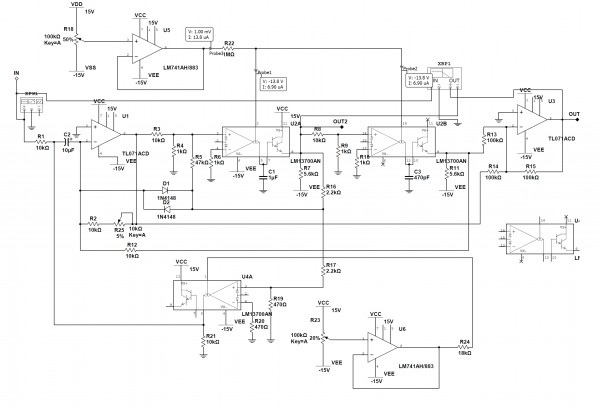

I need a little help with a state variable filter I'm trying to design.
I'm trying to design a SVF with those features:
- 4 selectable outs: LP, BP, HP, NOTCH
- CV inputs for frequency and resonance (both 1V/oct)
- 2 different modes: MONO 24db, STEREO 12db (both channels under the same controls.)
Schematics:
Supply -15V/0V/+15V
OpAmps are TL072
All NPN are BC550C (Matched pair on the frequency expo converter can be LM394 or similar)
All PNP are BC560C
OTA's are LM13600N or LM13700N
Tempco is 1K / 3500ppm
Layout:
Wiring:
I Attached here my LTspice IV files:
http://dl.dropbox.com/u/7222358/VCF-4P.zip
I did half the circuit (just 12db/oct) on breadboard replacing the resonance control with a 22k pot. It was working pretty good!
But I have just one very old and small breadboard.
I'm not so expert. So if somebody better than me can take a look to this circuit before I will etch a board, just to trash it! Confused
I don't know if everything is OK on the schematics....
Is it going to be tuned enough to be used as sine oscillator?
Some body (with a better breadboard than me) interested to build it or test it?

PostPosted: Mon Dec 12, 2011 4:36 am    Post subject: Schematics
Subject description: Screenshoot of LTspiceIV
You asked me to post the schematics... so to make the project more comprehensive for everybody I post the schematics straight from the zip file posted before!
To Pelle:
(Mi hai chiesto di postarti le schematiche.... ed eccole qua! E' uno screenshoot preso dalle schematiche contenute nel file zip da me postato in precedenza. Con i files contenuti nel file zip puoi simulare con facilita' l'andamento del filtro al variare della tensione di controllo (CV).
con i condensatori da 22nF il filtro dovrebbe chiudere ad una frequenza minore di 20Hz (0V) e si arriva ad aprire ad una frequenza maggiore di 20000Hz (10.68V) coprendo l'intera banda udibile. Per cambiare lo spettro di azione si possono cambiare i condensatori in questione, o le resistenze in serie che separano le varie parti del filtro (che sono tutte uguali))
Per simulare il tutto in LTspice hai bisogno di LM13700.mod facilmente reperibile su internet e copiarlo nella stessa cartella del file .asc che contiene la simulazione! Le formule per calcolare la risposta in frequenza ricordo di averle trovate da qualche parte in passato! Cmq Tolti gli EXPO converter il filtro non e' altro che il solito state variable filter basato su LM13700 o LM13600, quindi penso che non sia possibile trovare le formule in rete![/img]

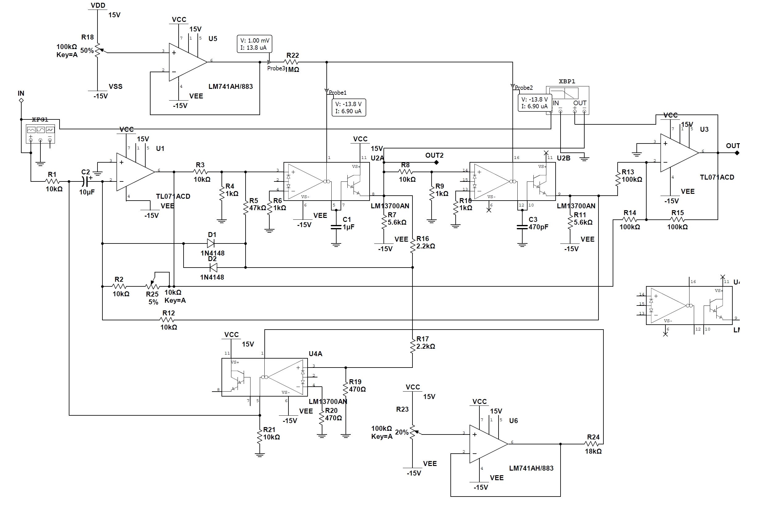

PostPosted: Tue Dec 13, 2011 1:41 am    Post subject: Reply with quote  Mark this post and the followings unread
Do you think i must to use a linear control for adjustment f0 with voltage control (or exp control)?
So:
How can i change Q factor? With which components in the schematic?
I would have so much selective filter (ideal, the circuit was remove only frequency component of sinewave noise input).
I'm trying to upper first capacitor from 22nF to 1uF and lower second capacitor from 22nF to 470pF and it work pretty good, but i don't know it's ok!
I attach one image of my test circuit.
The two LM741 give me a linear control of voltage regulation (it's a simple and fast circuit to building). R18 can change voltage out from buffer; this can give a different current inject into the I control of LM13700 and f0 was change.
What do you think?
 Filesize:  482.43 KB
 Viewed:  1552 Time(s)
dondo
Joined: Jul 06, 2011
Posts: 7
Location: roma
PostPosted: Thu Dec 29, 2011 10:33 am    Post subject: capacitors Reply with quote  Mark this post and the followings unread
I think you can't change capacitors like that!
They have to be the same capacitance.
This is a must for SVFs!
To increase Q factor you should work on the feedback LM13700!
If I remember well......
Less the feedback is amplified, higher is the resonance!
So if you want more resonance you should try to make the feedback signal lower! (The feedback signal is the one that pass trough U4A!)
You can also try to remove the diodes D1 and D2 to avoid any clipping.
Good luck!
