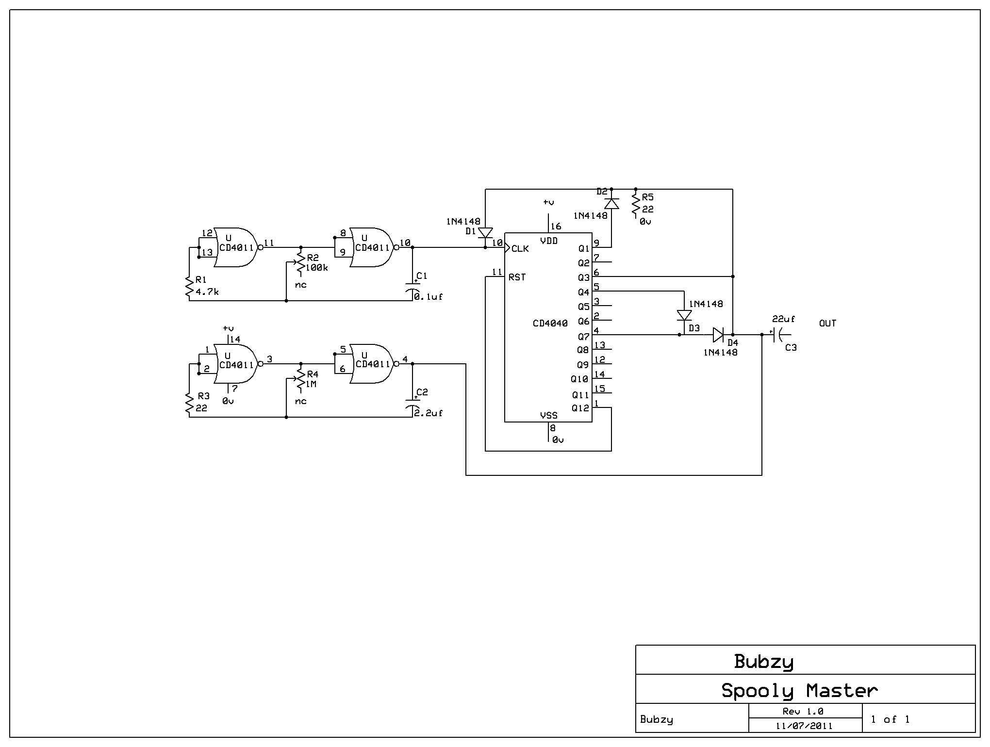

PostPosted: Mon Jul 11, 2011 12:28 am    Post subject: Spooly Master Reply with quote  Mark this post and the followings unread
yeah i know, ive got no imagination with circuit names Very Happy
Edit : R4 in the schematic is 1m but i say in the audio that its 100k. it is 100k on my circuit but i guess it wouldnt really matter what the value is Very Happy

Thanks for sharing this circuit! I like it a lot! Crazy sounds. I've experimented with pot values and cap values, and there's some interesting stuff. Changing which pins to use on the 4040 gives different stuff too. I'm thinking of putting it in a box.
Since they all have the same pin configuration, I blindly tried swapping the 4011 for a 4070 XOR, 4071 OR, 4077 XNOR and 4081 AND, but none of them produced anything. Maybe I messed something up.
You didn't mess anything up; you just used the wrong chips Laughing
The 4011 NANDs, which are incorrectly drawn as NORs, are configured as oscillators. A 4070 XOR output will be 0 if both inputs are the same, so in this circuit it won't oscillate. Similarly -- or rather, inversely -- a 4077 XNOR output will be 1 if both inputs are the same, so that won't oscillate here either. The 4071 OR and 4081 AND don't invert, so those will not oscillate.
If you had tried a 4001 NOR it would've worked.

they are incorrectly drawn as i just changed the schematic from some 4001's and changed the text on the chip Very Happy
i put it down to unadulterated ignorance.
