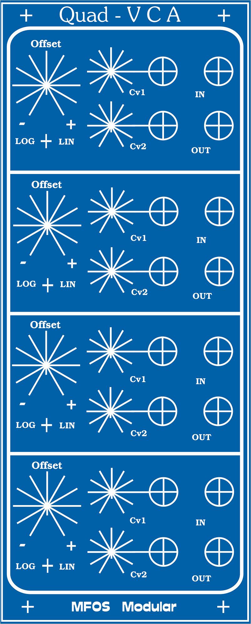

Hi there.
Last module from 2005 to get the "space management" treatment Smile .
Ordered another twin VCA board from Ray a week ago & some envelopes.
Two Vca's required for bass / melody lines and the other two vca's for control of cv's.
Here's a pic of the old module and a pic of the new panel i made & a jpeg of the layout.
hope to finish this in a few weeks .
I hear PHoBos is building a Quad vca too Very Happy Very Happy Very Happy
Dave.
yep Very Happy, 2x MFOS "another Dual VCA". got the perf PCB finshed, so I only have
to wire it up. For that I need a panel design first and I'm not completely
happy with what I have so far. It looks like I need a bit more panel space, but
I see you even managed to get pots for the CV's in there on the same space. Shocked

nice design as always dave. Just a quick question though, those "log/lin" swiches you got, they switch the pots from log to linear? and how??
Posts: 5888
PostPosted: Thu Jul 28, 2011 6:03 am    Post subject: Reply with quote  Mark this post and the followings unread
bubzy wrote:
..,they switch the pots from log to linear? and how??
Dave 's not here, so let me answer that. The switches toggle
the VCA between lin. and log. responce, not the pots. Wink
here and here are some nice scope shots (shroll down)

my panels are 250mm high by 100mm wide , there was just enough panel space Very Happy .
bubzy.........
Thanks Smile , yes the switch is for VCA mode select.

finished the Quad VCA , sitting in the modular now contented Very Happy
I'll post a quick audio file over the weekend when i have time .
Top 2 VCA's are the 2010 version pcb and the lower 2 VCA's are the original 2005 pcb without the bias trimmers , these ones are for my "cv controlled modulations" Very Happy .
Dave.
