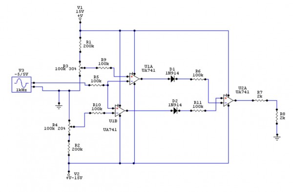

I've been trying out a window comparator circuit lately and have been having trouble for some reason. I thought I'd include the circuit here and see if people had some thoughts on why it might be problematic or share some other design insights. I don't think there is already a thread specifically dedicated to this circuit?

Hey MC,
Not a detailed analysis, but off the top of my head, I'd say the feedback resistors on the first two op amps are way too small. To make an op amp act like a comparator, you need to eliminate the feedback R, or make it a very high value (5 to 10M). The feedback resistor gives snappier response (look up 'hysteresis'). Here's one example of an op amp based window comparator without the feedback resistors:
http://ecelab.com/circuit-window-comp.htm
If you really want the quickest response, then a comparator chip works better than an op amp. Here's a page with a pretty good rundown of comparator theory, and even includes a window comparator circuit:
http://home.cogeco.ca/~rpaisley4/Comparators.html
And finally, here's a really trick window comparator circuit that gives you voltage control over the window threshold and width. I suspect that a modern op amp like a TL07X would work just fine in place of the part numbers they call for. I haven't tried this one, but it certainly looks useful:
http://www.intersil.com/data/an/an9802.pdf
Tim (window comparator shopping) Servo

Tim - thank you for the advice, I did fail to take the hysteresis into serious consideration..
However, the 10meg resistors are not solving the problem.. the circuit only seems to be able to detect a very narrow window of voltage and even that is somewhat questionable... it mainly operates when the pots are turned all the way..
The other circuit does seem worth a shot, if there is not other possible explanation for my problems with this design. I know this is a pretty standard circuit, so my immediate suspicion would lead me to believe I made some sort of layout error - but I haven't been able to identify that yet...
I do wonder if there is some sort of issue with polarity here..many of the example circuits I've seen are single supply and this application note suggests using a pot that varies between V+ and ground, rather than V- for the max threshold...

Let's try this one instead. A couple of things I did: first I separated the reference voltage circuits and added input resistors to isolate the references. Then the output goes through a difference amp. Anyway, I've simulated this circuit and it seems to behave nicely. See what you think.

I don't get what you are doing. You have the output opamp pinned at the negative rail. How can it ever switch? And why do you think you can connect the two opamp outputs together? It doesn't look like a standard circuit to me. Where did you get it?

Well, I came to this by looking at the following:
http://www.aldinc.com/pdf/cd_23009.0.pdf
http://www.aaroncake.net/forum/uploaded/audioguru/2008425111635_window%20comparator%20circuit.PNG
....I have to say that the lack of resistors struck me as problematic, but I still find it difficult to trust my instincts with these things..
The resistor in the last op-amp stage was an attempt at a pull-up resistor, because I don't have an entirely symmetrical power supply....There is actually another resistor to ground there that I mistakenly left out of the sketch...

One quick note: the diodes in my circuit aren't needed. They'll actually cause the inputs on the last op-amp to float when reverse biased and so you can just remove them altogether. Thanks to Ian Fritz for the reminder.

Alright - I feel like I'm making a little progress here, although I might still be missing something... I apologize to protract this discussion on what seems to be a very elementary circuit..
Is the last stage supposed to operate as a differential amplifier circuit? It appears the same as the comparators, in which case I don't understand how the logic is working...
If it is a differential amplifier, this would be the operation:
If the voltage does not exceed the low threshold or the high threshold:
Low: -15v, High +15v.
(-15v minus 15v at differential amp)
If the voltage exceeds the low threshold, but not the high threshold:
Low: +15v, High: +15v.
(15v minus 15v at difference amp)
If the voltage exceeds the low threshold and the high threshold:
Low: +15v, High -15v.
(15v minus -15v at differential amp.)
So, one would get zero volts for the window and +15v or -15v for outside the window...is there a way to change this relationship so that there would be a +15v for the window and a -15v for things outside of the window?

I think you can change the output polarity by just swapping the inputs to the difference amp (R6 to + input, R11 to - input). Keep in mind I haven't actually built this, but a quick simulation seems to suggest that would do the trick.

Well, this does seem to be behaving rather nicely now...thanks for your help!
