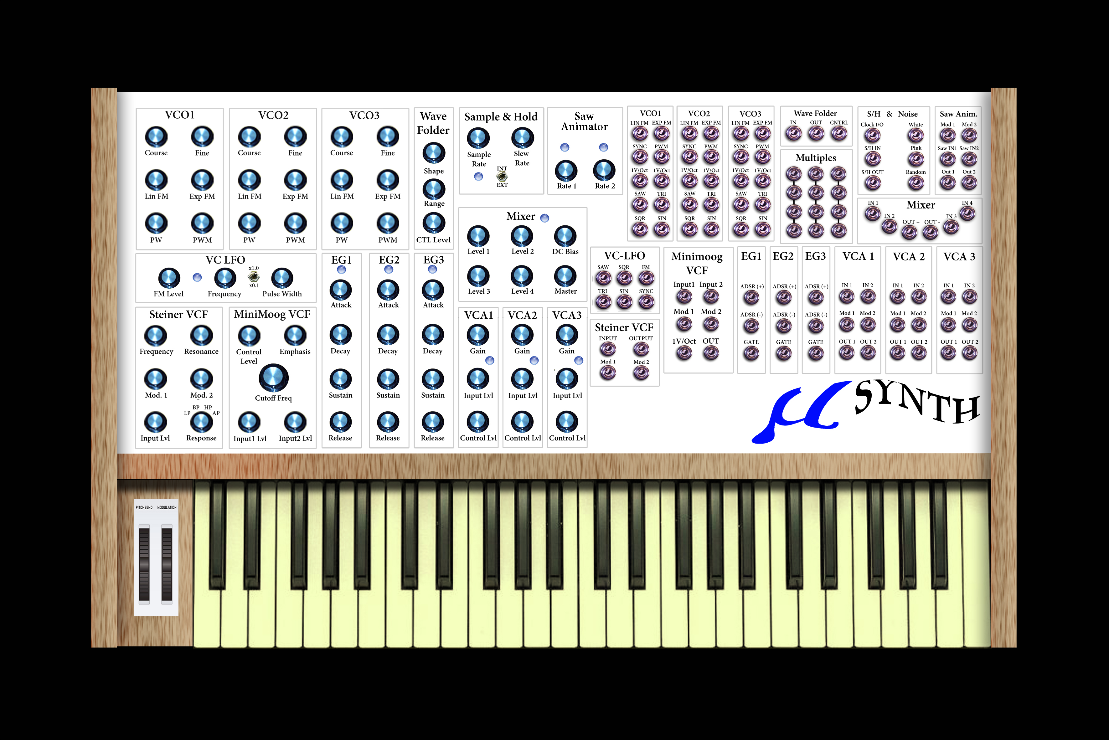

I'm in the middle of building this and I need to know a couple of things before I start putting it all together.... Firstly, I'm a little concerned about the internal cabling. I know it's gonna be a bit of a rats nest but after building a Klee that doesn't really bother me. What I'm concerned about is that the cabling will be prone to interference; internally generated, RF or otherwise. So.... How do I minimize the possibility of such interference?.... Ferrites? Shielding/shielded cable?
My second question is regarding grounding. To what extent can I combine ground cables to minimize the amount of panel wiring?
I'd really appreciate any advice on these things and any other potential pitfalls with this type of layout that I may have overlooked .

Well use a star-like distribution for the power supply chord.
You may use a common wire for the grounding of the jacks.
Thanks Yves. Smile
