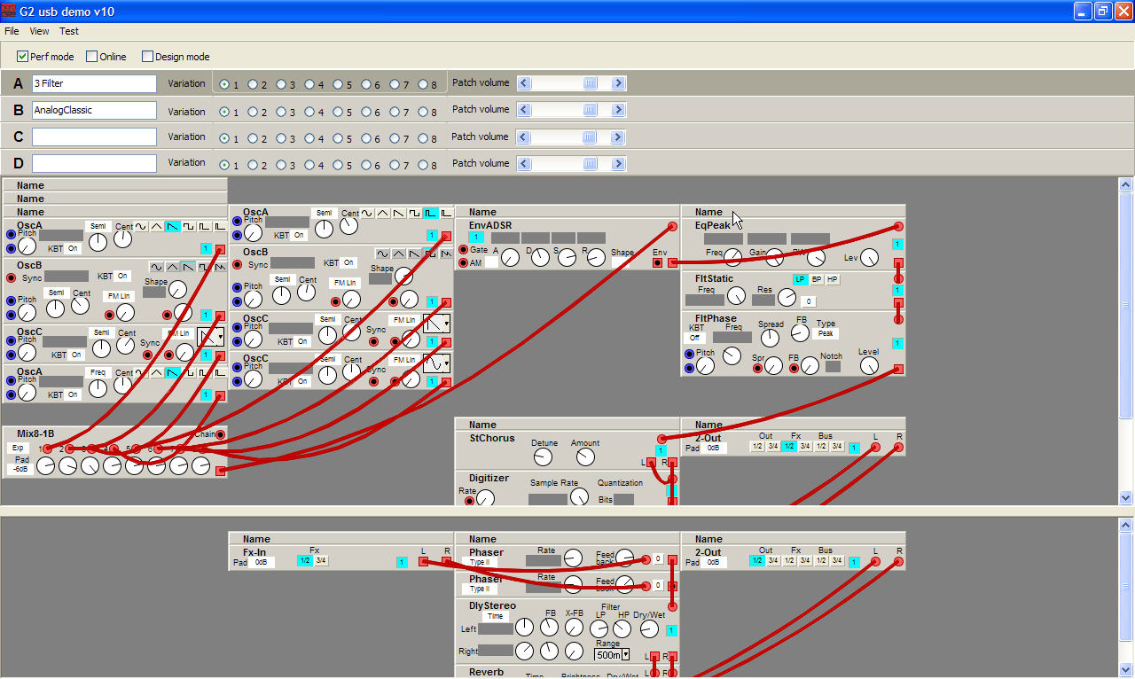

PostPosted: Fri Sep 09, 2011 5:50 am    Post subject: Reply with quote  Mark this post and the followings unread
What are the 3 checkboxes for ? (Perf mode / Online / Design mode)
brunov
Joined: Aug 03, 2011
Posts: 227
Location: delft
PostPosted: Fri Sep 09, 2011 7:09 am    Post subject: Reply with quote  Mark this post and the followings unread
"Perf" is the same as in the clavia software, to switch between performance mode or not.
"Online" indicates if the usb connection is active. So i can test things offline ( displaying, changing patches) without the actual G2 connected.
"Designmode" i put in when i thought i had to design all the modules, with this you can add or move controles on the modules. But now that i can generate the modules from file this is not necessary anymore.

Here is a screenshot of the last incarnation of the g2 usb demo. I've put the sequencer leds and the mini-uv's in. I really had a big problem at first with these leds because the cpu usage went through the roof. Turned out that when a led in the left bottom corner went on and also one in the other end of the screen, the whole screen was repainted at 150Bpm's! So had to rethink the graphics rendering. Now it's around 20%, i think that's ok for the moment.
I also think dradpap's idea was very good, to put the volume and variations on top of the screen so you can change these in another slot without leaving the patch you're working on. I used to work only in one slot but now I'm more inclined to use the others and mix them in. Maybe you already did that, but I'm learning all sorts of new things! I still have to put the mute buttons on there also.
There's a bit of usb trouble now and then, mostly when I switch between the clavia software and the demo, it sometimes happens that the messaging goes out of sync, so bit more testing to do there, and also about a 100000000 other little things to do....
Hopefully I can upload a new version of the source next weekend, I guess you guys can't wait to port it to ipad linux etc etc etc
